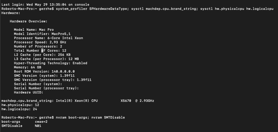

My MP5,1 refuses to disable HT. Both my 2012 4-core MacMini and my 2015 MBP are able to disable, so I evidently even know what I'm supposed to be doing..
can anybody shed some light?

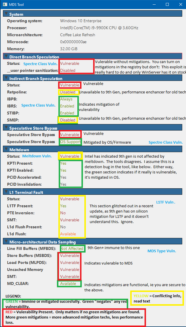

I found this posting on another forum on how to read the info from the MDSTool app. Someone made an infographic that shows how to tell if a particular vulnerability is mitigated or not. For MDS it shows if MD_CLEAR is green then it is mitigated. With SMT green I'm not sure if that means it is mitigated, but it could be.
https://www.techpowerup.com/forums/threads/an-attempt-to-decipher-mdstool.255881/
guidetomdstool-png.123575

What's kind of alarming is that according to the readout I got the Westmere CPUs are vulnerable to Spectre variant 2 attacks regardless if SMT is disabled. I thought that was mitigated with an earlier microcode update.
bsbeamer
macrumors 601
Sep 19, 2012
4,313
2,713
Maybe someone else can confirm, but BELIEVE it's only mitigated with microcode AND software/OS update in combination. Microcode update alone does not mitigate.

Robert71B
macrumors newbie
Nov 8, 2017
5
You still have BootROM 140.0.0.0.0, read here #15
Thank you!
that looks like a simple problem, now I'm struggling to work out how to update the firmware.
from best i can tell that should have happened as i upgraded to Mojave. but it didn't.
I am not sure how i upgraded but it's on a 1TB APFS formatted Samsung 850EVO in an OWC MountPro2.5 in the 4th drive bay (not PCIE).
I (think I) have reset the NVROM by holding the P+R+cmd+option as it started until it chimed 4 times then released. (it then chimed a 5th time). but the bootrom did not update spontaneously after that.
Do I really need to erase the whole SSD, reinstall Mojave from a Mojave installer just to see if maybe that works? Or is there a simple procedure for updating from 140.0.0.0.0 to 144.0.0.0.0? something like a firmware updater?
thanks for any additional insights!

MP5,1: What you have to do to upgrade to Mojave (BootROM upgrade instructions)
