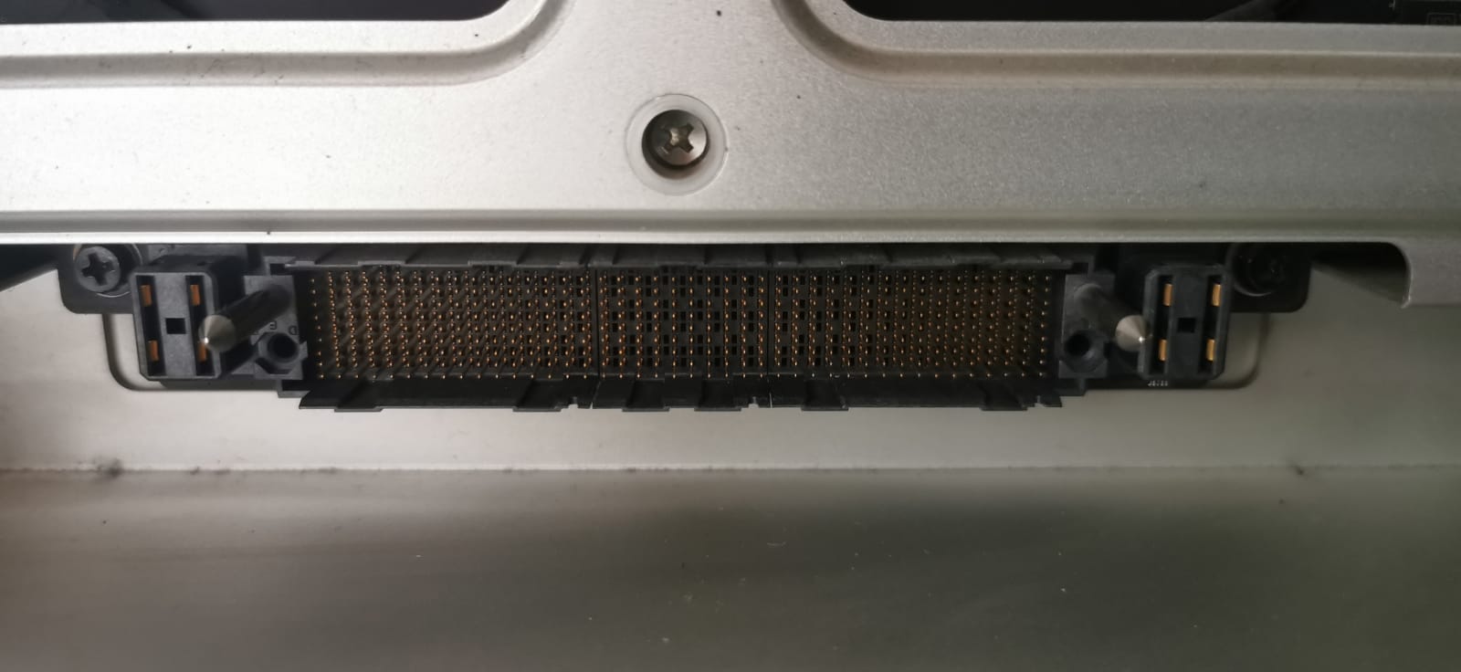

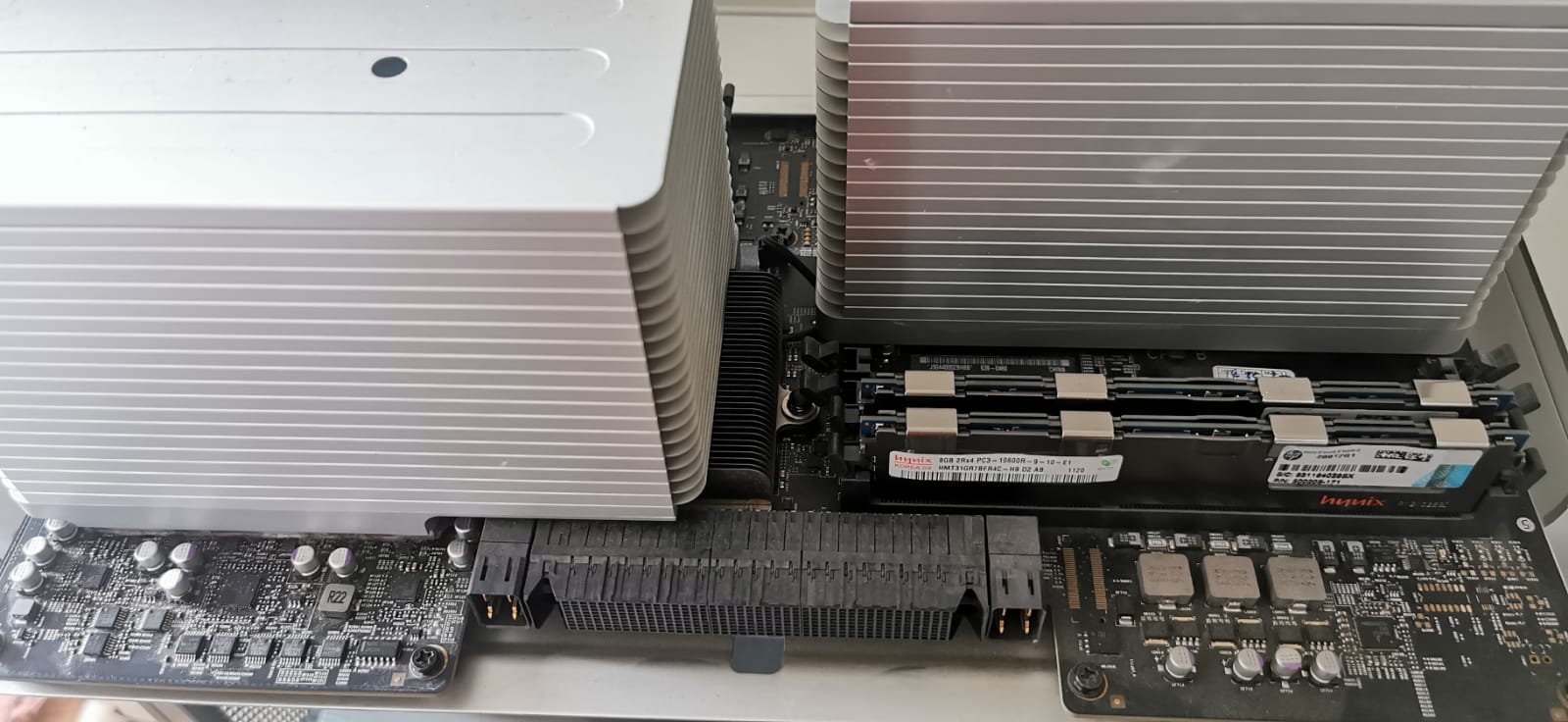

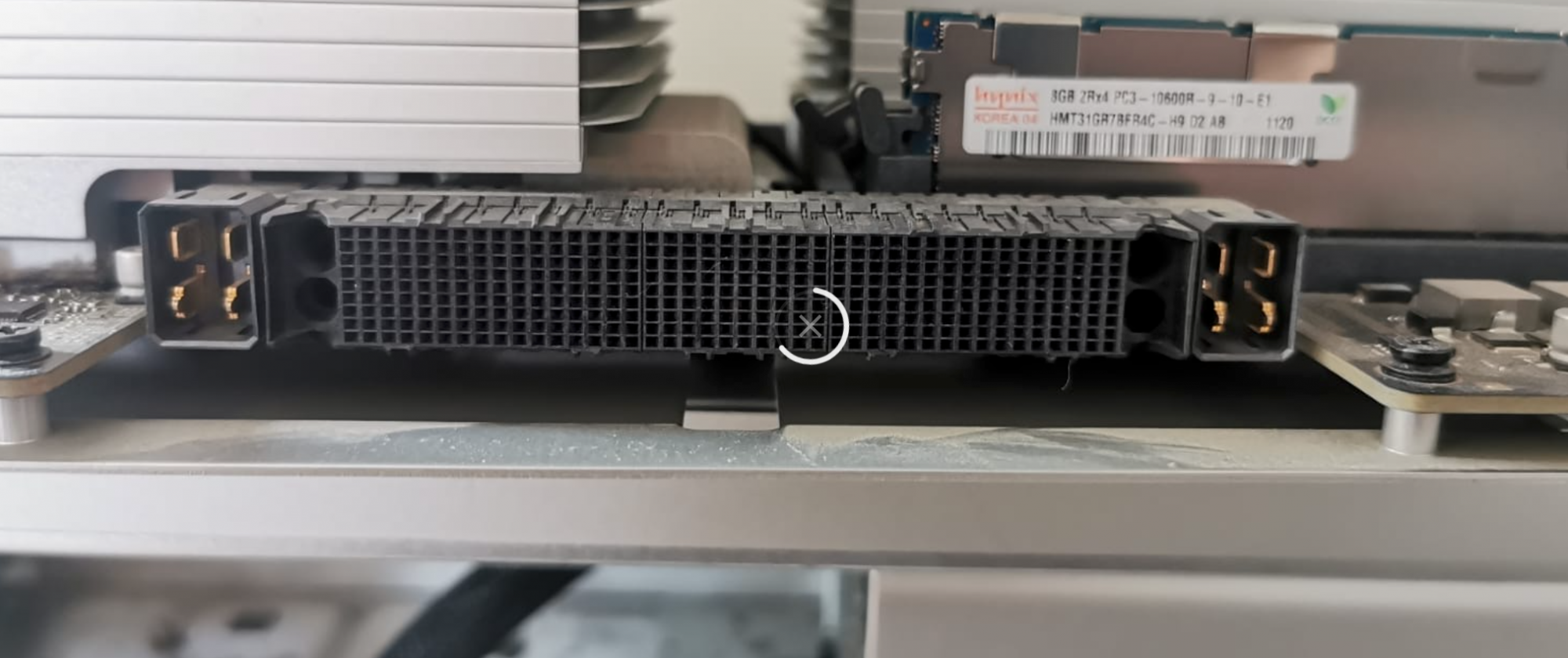

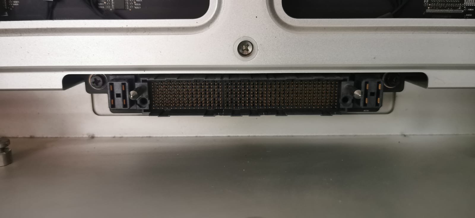

triple check the backplane connector pins going to the cpu tray, take photos with a good camera.
always unplug mains when swapping cpu trays.
all Mac Pros are 5.1 or have at least the 5.1 Firmware?
Yes, all are Mac Pro 2010, I added the photos of first cpu

From your description, highly likely your 1st cMP's PSU is failed (that click click click sound).
And "failed" no necessary means "no power", but can be "unable to control power".
Let's say your PSU pump too much power to the tray, then it can kill the 2nd tray. 5s for over power is way too long already. It only need a split second to kill an electronic device.
