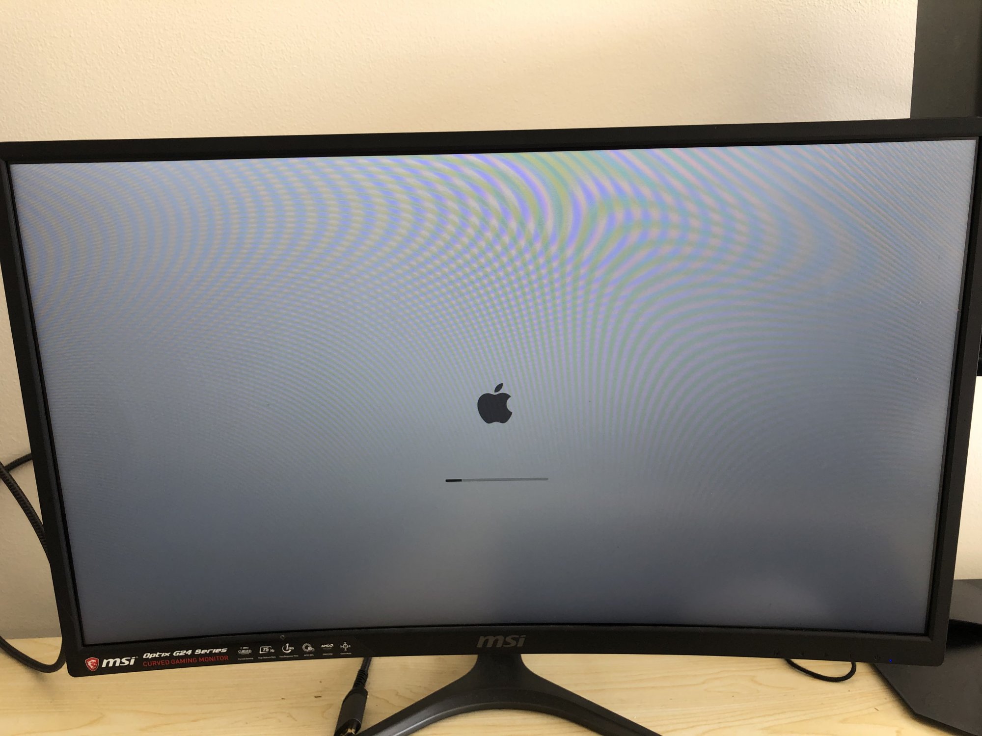

So I've tried the stock Nvidia GTX680 and I've now got picture, but it stays on this loading screen and doesn't move...
So, your problem is not directly related to the GPU itself, it's probably the macOS install or your main drive. Test with a clean install on another drive.
As Tsialex said, your problem is NOT GPU related, but macOS's (software) issue.
Your RX580 won't display until GPU driver is loaded (unless you flash it, or using OpenCore etc).
Therefore, if your macOS stuck at early boot stage. No GPU driver is loaded, and your RX580 won't display anything.
Assuming your recovery partition still working correct. You should able to boot recovery partition with the RX580 only.

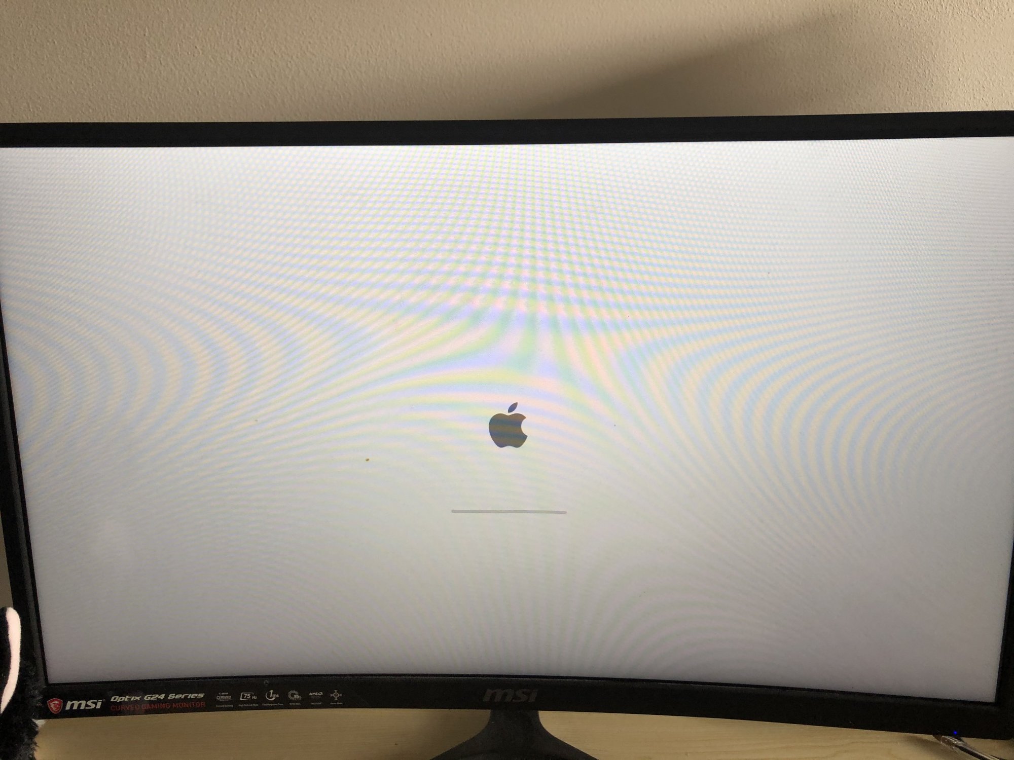

This is the outcome of the new High Sierra Drive. Sometimes the bar would load further, but would never finish
