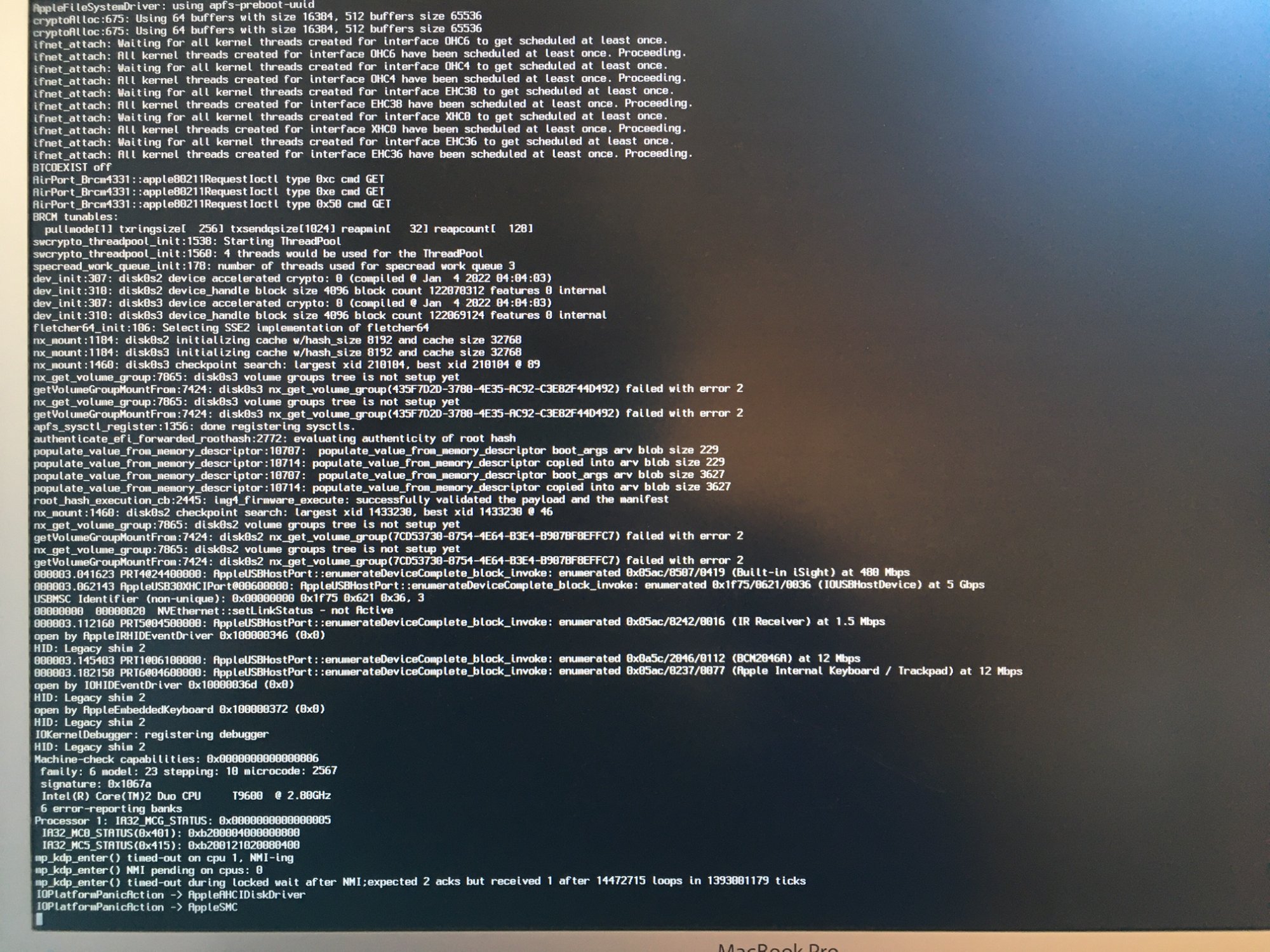

I'm using a different machine, MacBookPro5,2 (mid 2009). I use a dual USB3 expresscard/34 from nanoTECH which has an FL1100 chip. Sorry that I came across this thread only now.
It works fine with Big Sur 11.6.2 and 11.6.3RC, as it did with Catalina. With the latest OCLP version 0.4.1 one can even boot via such an USB3 port.
It does not work anymore with any Monterey version, that is, mouse or keyboard connected to USB3 work fine. But when connecting a storage device to USB3:
(1) a running Monterey (booted from elsewhere) will freeze;
(2) when booting Monterey (from elsewhere) while a storage device is plugged into USB3, the boot hangs and the verbose log seems to indicate a missing NMI interrupt (see attached photo);
(3) when booting Monterey from USB3, OCLP sees the disk correctly, but during boot same thing happens as in (2), unsurprisingly.
I guess something around the XHCI disk driver in Monterey is in error.
If someone has similar experience, I'd be glad to know, because using USB3 for access to an external disk (and now even for booting) is fast and thus convenient. Thanks.
