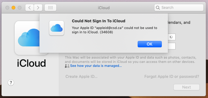

I just tried to sign into iCloud through the Preferences panel this morning and something different is happening. I'm told that my Apple ID could not be used to sign in to iCloud (34608). That's the first time I've seen that.

You have something going wrong, but at first look is not the BootROM since you wrote that you can login to Messages, this alone eliminates any basic BootROM issues since Messages validate the hardwareIDs. The Mac AppStore issues are not directly related to the BootROM, like I already wrote.
Solve all issues that your AppleID and iCloud could have with AppleID/iCloud websites first. Talk to Apple support, check if you need to accept any agreements and etc.
After that, do a clean install WITHOUT adding your AppleID or iCloud while running the Install Assistant, first do all the software updates and only after fully updated and rebooted, you'll add your AppleID/iCloud accounts.
