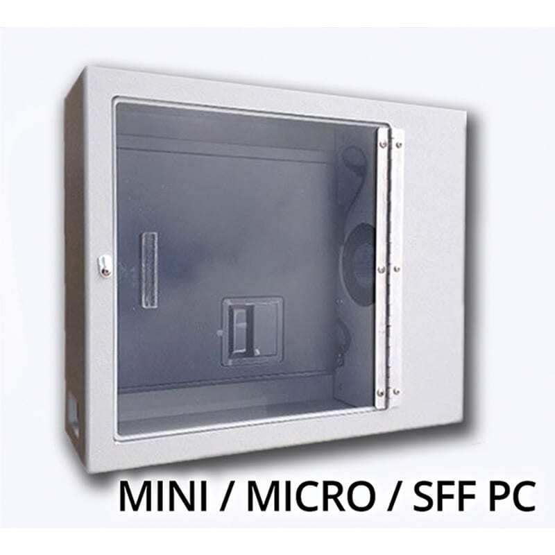

You need an industrial computer enclosure for factory environments. Something like this:
That, or you need to make one yourself, that has positive air pressure flow to keep dust from infiltrating, and gaskets / filters etc, with adequate airflow to ensure cooling.

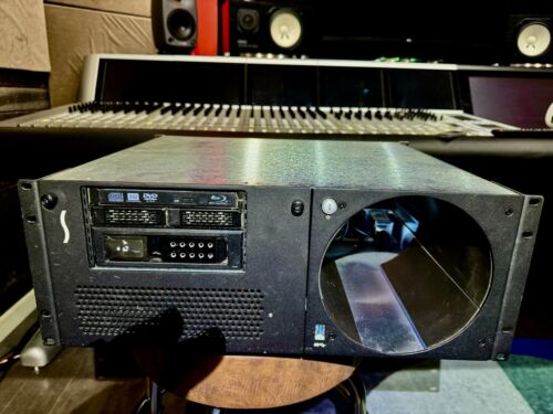

could mount it in a 2013 Mac Pro server case . 6.1 equals 2013 Mac Pro right? 7.1 is 2019 model.
