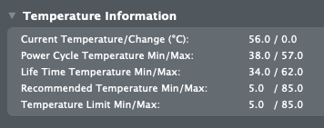

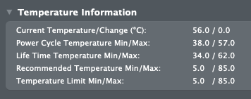

Heatsink is required for a MacPro6,1 and most blades, the air circulation is not enough to keep a non-heatsinked blade within the expected temps. I had several issues with blades overheating before I started to use heatsinks and even with the heatsink the temperature is over what I'd like for maximum longevity, today was a cool rainy day and the blade went to 57ºC:

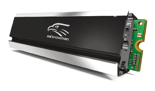

I’ll definitely use a heat sink for the new NVMe. Is there a specific one you recommend? Or a specific feature that I need to look out for when buying one?
The size available inside the MacPro6,1 limits a lot the height/model of the heatsink you'll have to buy.
I've bought several different models until I've found this one:
It's the better dissipation that I've found that fits inside the MacPro6,1 case and it's cheap enough to not think two times about the cost. I still have one heatsink in the original box at work, I'll take a photo when I'm back to the office later this week.
