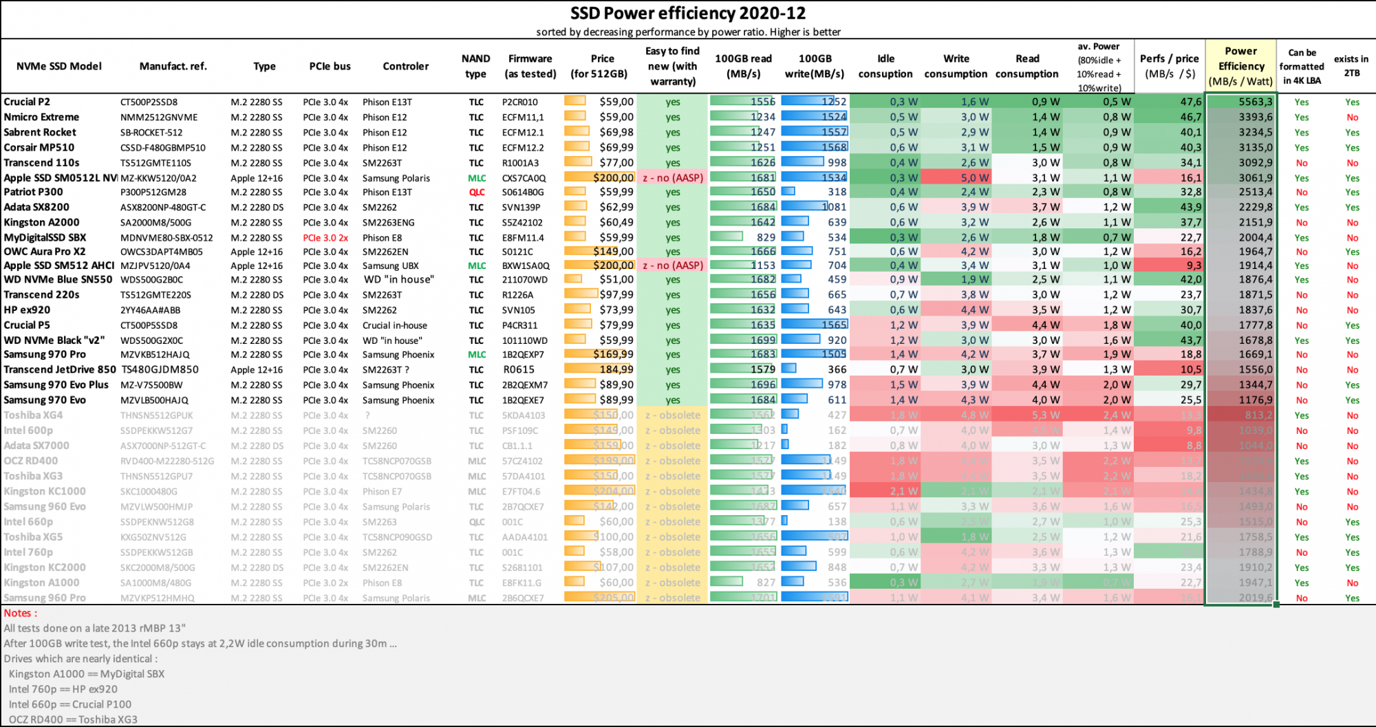

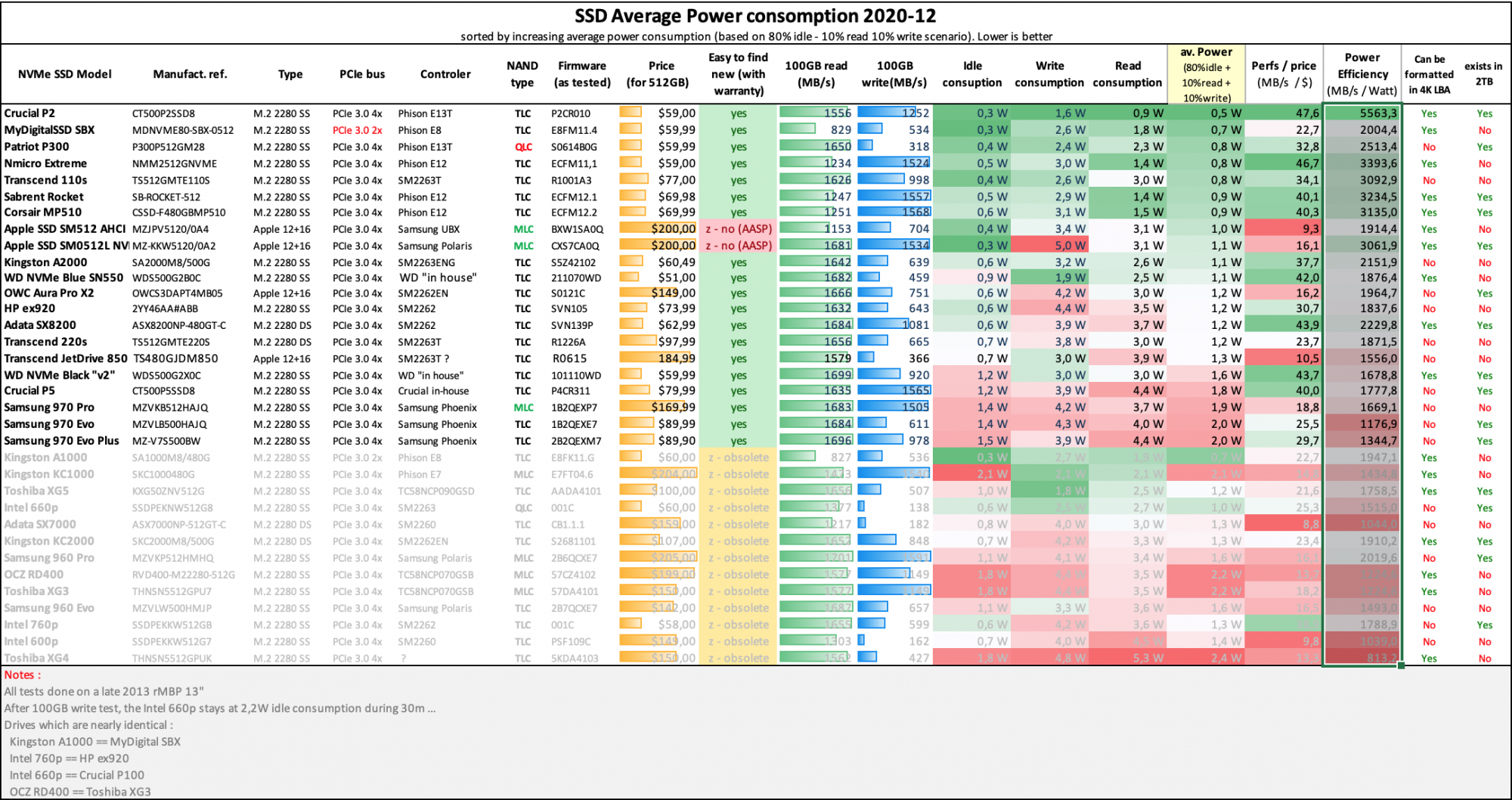

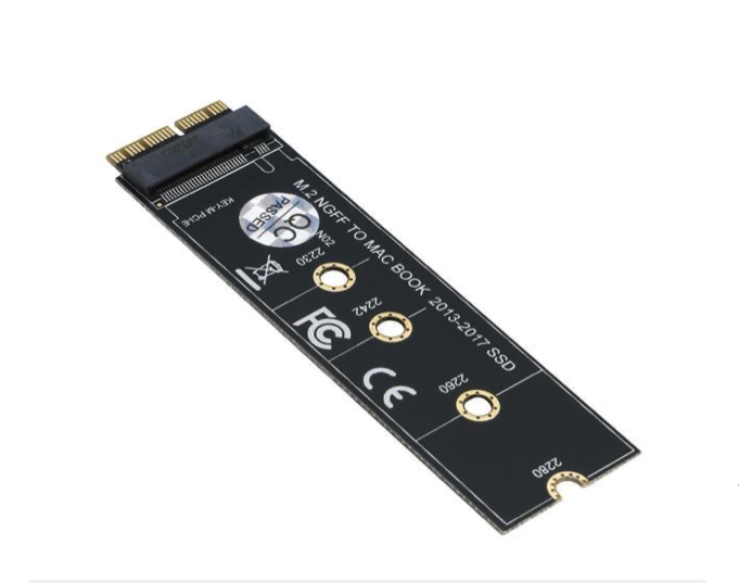

I plan to use Kingston KC2500 2TB with Sintech adapter. I don't know what kind of power specifications one should look for the upgrade drives. Is there some information on Apples drive specs in 6,1?
edit.
btw, here is the Kingston spec for KC2500:
.003W Idle / .2W Avg / 2.1W (MAX) Read / 7W (MAX) Write
The below charts from this thread might help.
I’m now not sure if it would be a power issue given it worked fine until 11.6.1 (and anecdotally the same for a large number of people reporting the issue).
Many drives use similar or less power than the Apple 12+16 AHCI drive in the MacBook Pros.
Reactions: mikas
Wow, thanks a lot.
KC2500 max watts (7W) seems to exceed anything on the list (skimmed through it..).
970 EVO+ average system use is 6W.
Me too don't think it would be about power though, because I have the Apple one (3,4W), and problems persist still with it too. BUt then again, it just could.

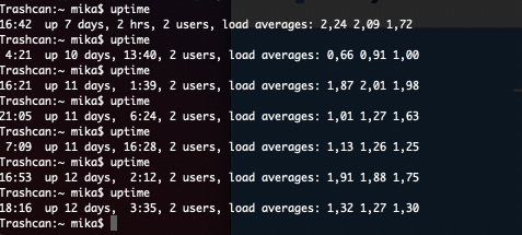

It seems to be kind of sporadic type of a kernel panic. Couple of weeks ago I just got two of those panics in a couple of days, and now, I've been running this same 6,1 D300 without interrupts for 12 days. No sleep though. That's a no for now.
And there is no pattern in those panics, at least not that I can read or comprehend. There might be some suspects of the reasons with the knowledgeable people, but I guess it's a diminishing returns game to shoot those reasons down as of today.
