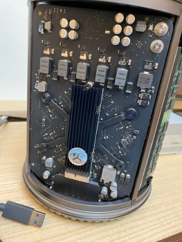

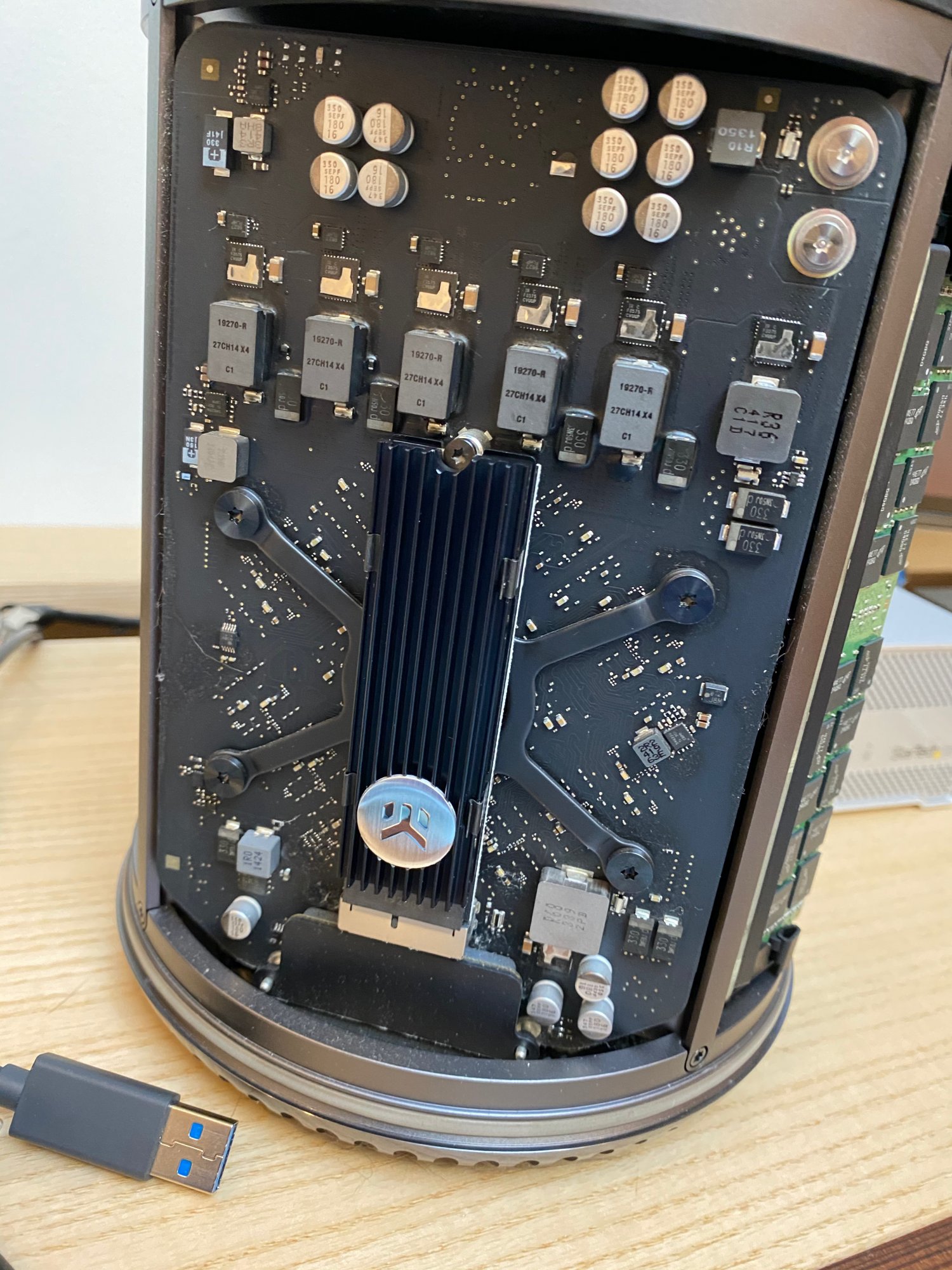

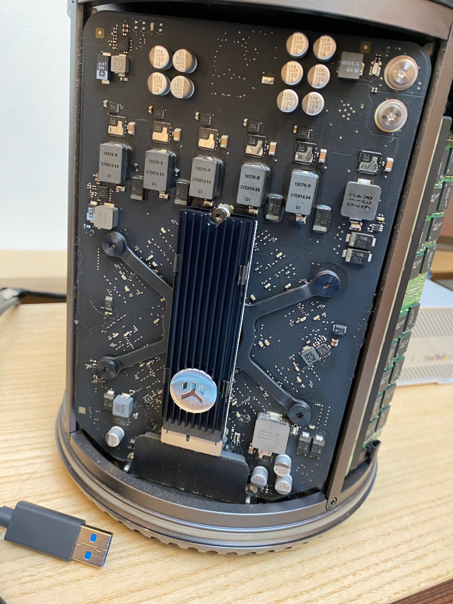

I put in a Samsung EVO Plus 2TB with the Simtech long adapter and the EKWB EK-M.2 heatsink. iStat Menus and Drive DX both report temps around 65ºC. This seems higher than I'd expect but reasonably sure I installed the heatsink correctly.
I rechecked the placement of the EKWB heatsink and replaced the thermal pads that came with the heatsink with Artic thermal pads just to make sure. No real change in temperature, still around 65ºC. At this point, I'm going to assume that's the best that can be done unless someone else has had better results. It does look like there's room for a slightly larger heatsink but I think Samsungs just run very hot, especially in 2TB configurations and clearly the nMP doesn't have great ventilation.

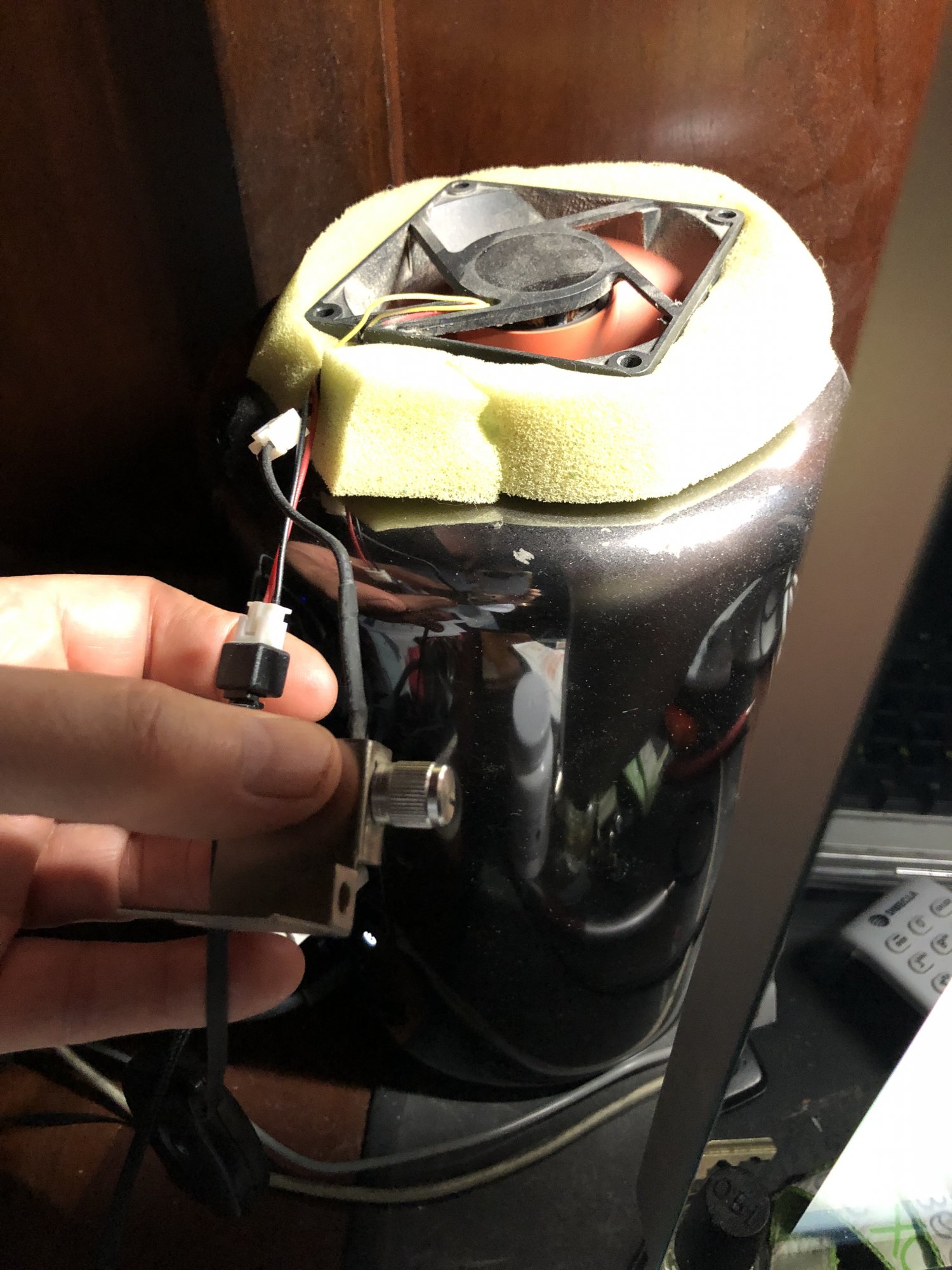

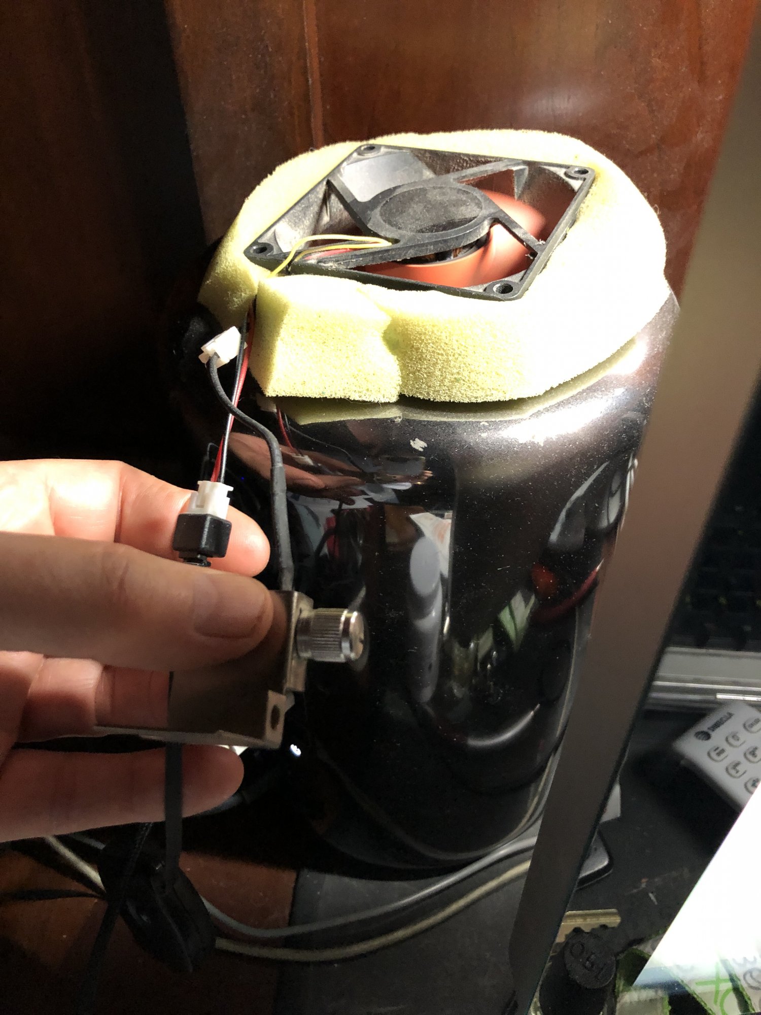

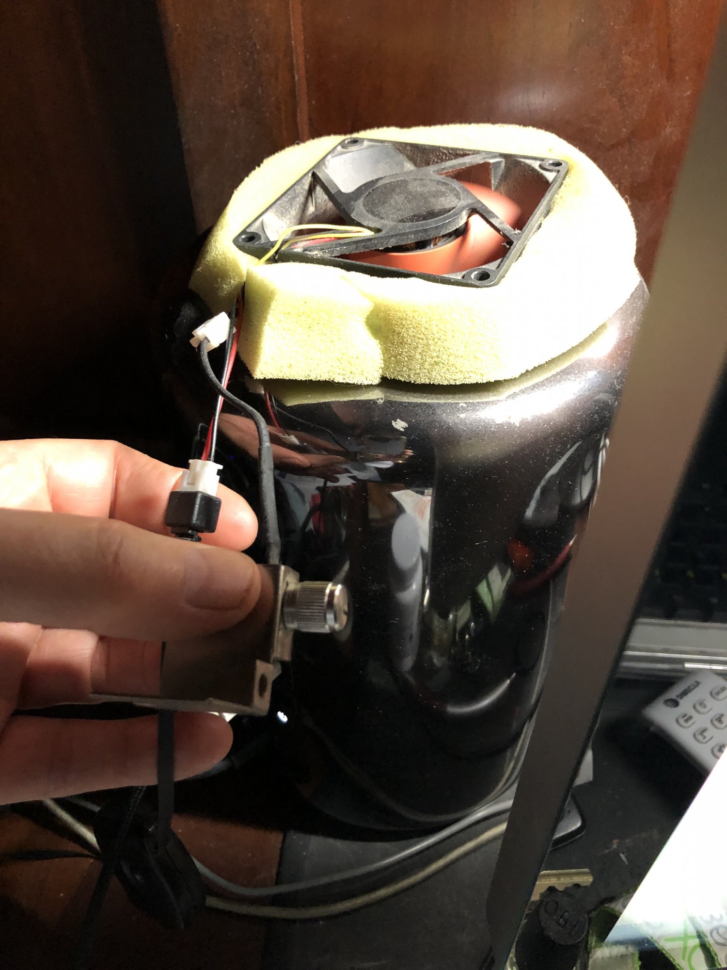

I bought a thermaltake box fan with a speed controller and usb plug. It sits on top of the 6,1 in a piece of foam with the square cut out of the middle. My temp monitor rarely moves over 36 degrees. If it foes I turn up the fan speed and the temp comes down. Before this fan the machine would heat up into the 40"s and [performance would suffer. This is a Max'd out 6,1 12 core 64 gb RAM with the factory 1 Tb SSD..

I put a EKWB heatsink on my Samsung EVO 970 2TB SSD. The temperature has gone down by about 10 degrees F.
