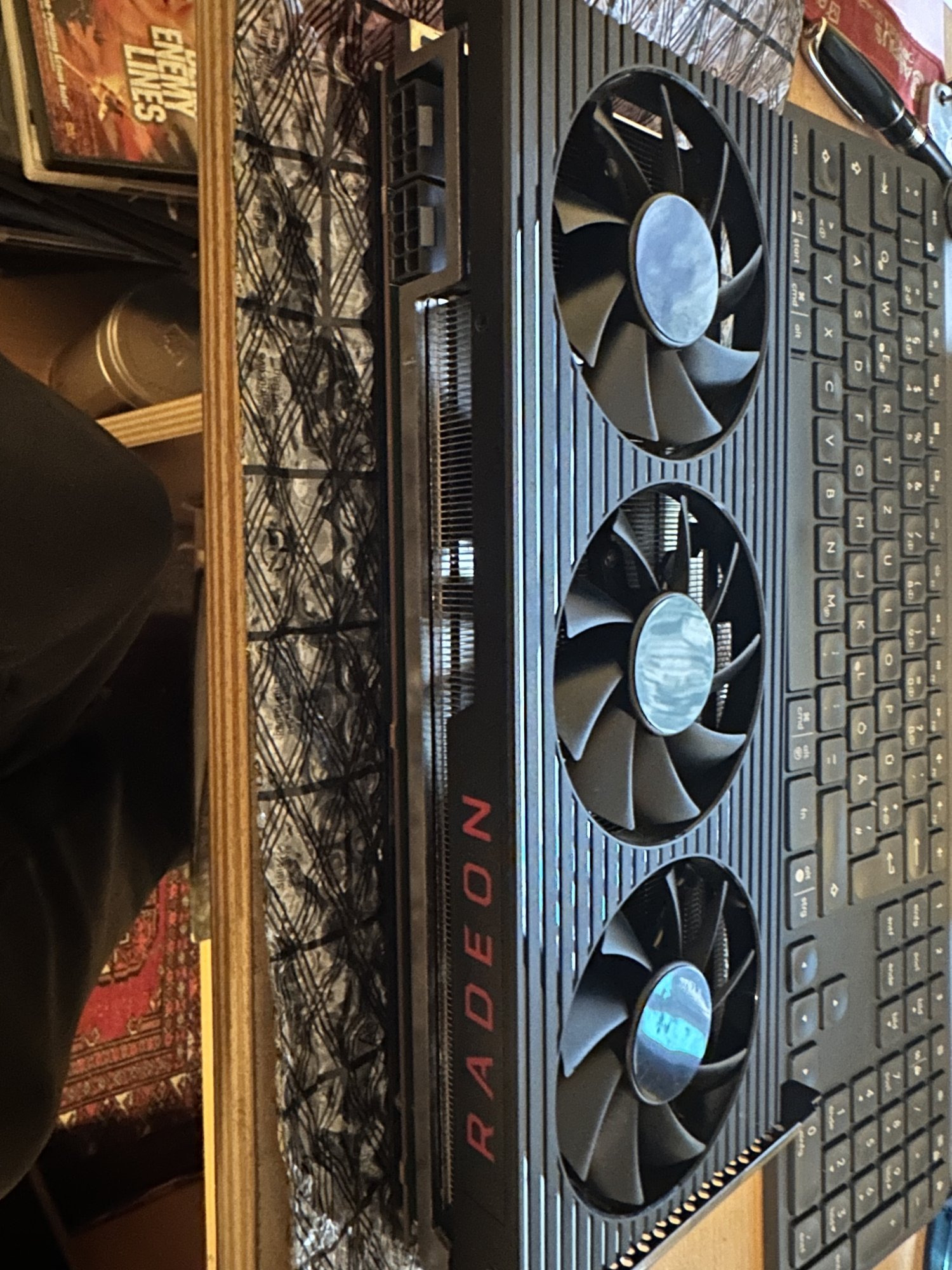

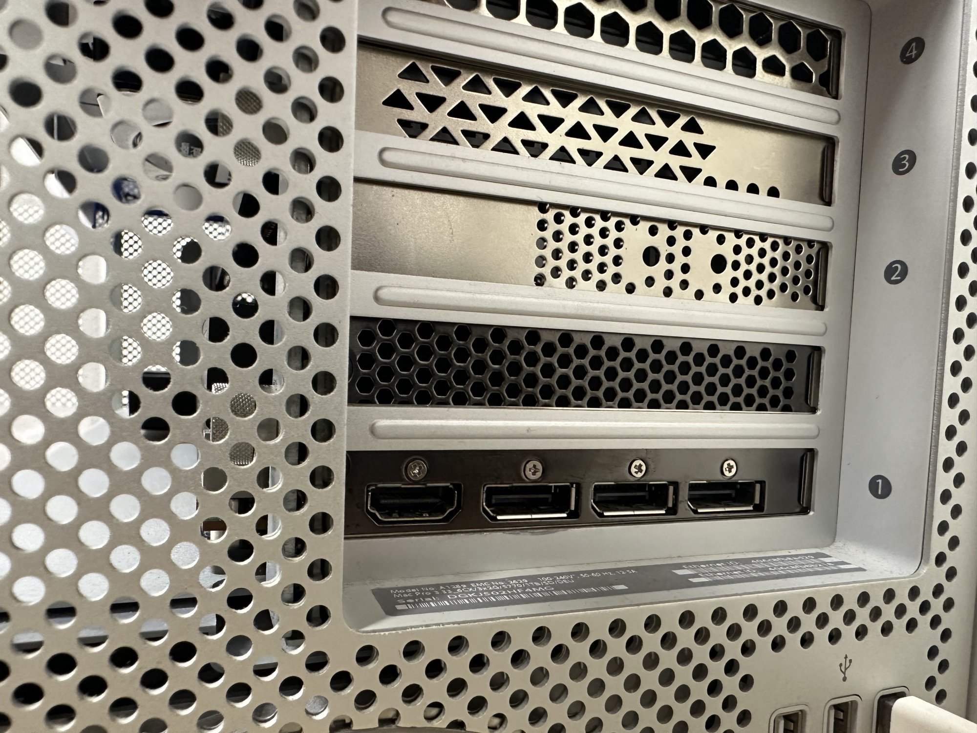

What is the port layout on that Dell 6800? Is it like the reference card? Also is it a 6800XT?
It is the 6800XT and it has 1x HDMI and 3x Display Port. The heat sink looks very similar to the Vega7 card (just with a black plastic shroud) that I used to have. Since the heat sink is so compact and the original intended Aurora chassis is so restricted, it’s most likely that it runs a bit slower compared to a full size three slot monster card.

Super interesting. Since it worked so well for you I was assuming it was the AMD Reference design (like the Sonnet card) with the 1USB, 2 DP, 1HDMI ports, just packaged more tightly. But those ports are not the reference ports and it still works great. Some non-references cards may work just great too. Thanks for the great info!

Here are two shots of the card
