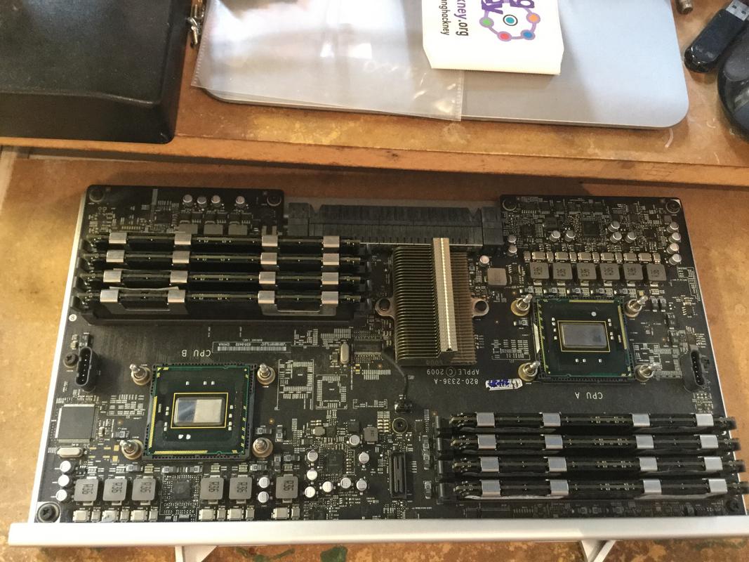

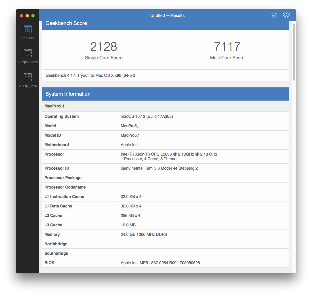

I successfully upgraded MP 4.1 8c 2.26 to 5.1 12c 2.26. Multi CPU score jumped from 13800 to 25600.
I recommend "vice only" delidding method - surprisingly easy with good stable vice.

Just posted this in another thread But i figured id post it here as well, I was able to upgrade the CPUs in my Mac Pro 4,1 running the latest High Sierra firmware without any issues, and my ram was recognised as 1333Mhz without having to reset anything :) (I upgraded from Dual X5570s to dual X5677s the X5570s where apple lidless ones the X5677s I got for a good price pre-delided from ebay) im glad I upgraded to westmere CPUs as VMWare Fusion 10 requires Westmere or newer CPUs (as well as Apples built in Hypervisor, I wonder if VMWare fusion 10 is using apples Hypervisor now...) edit: heres a geekbench score :) https://browser.geekbench.com/v4/cpu/4234967 another edit: heres a picture of the CPUs part way through installation :)
^^^^Yes!
