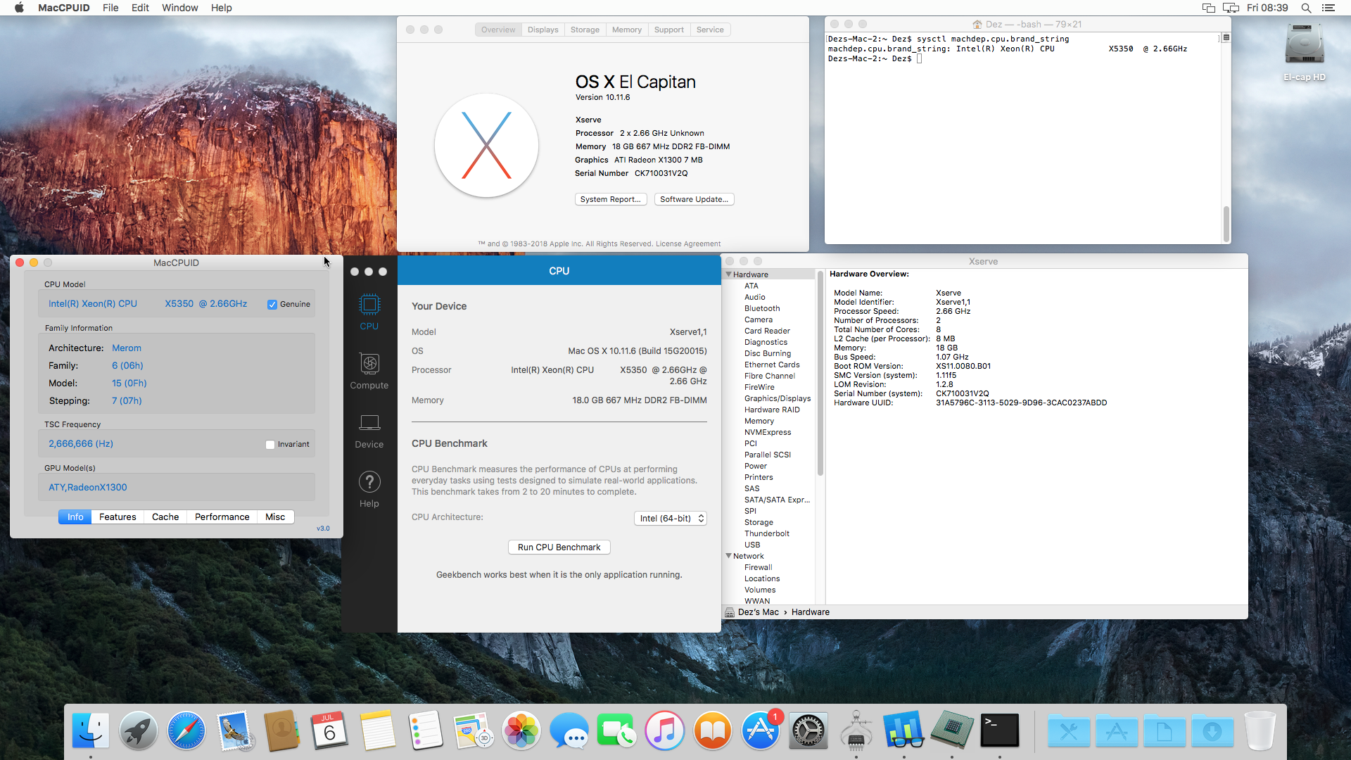

Ya can add the X5350 (qSpec is QUQD IIRC) to the Xserve1,1 list now if you want :) 3.33Ghz MacPro2,1 here I Come! :D (heres a GeekBench @ 2.66Ghz https://browser.geekbench.com/v4/cpu/8917013 note the score might be a bit lower then it would be, as I was running with no GPU acceleration so I had UI drawing overhead on the CPUs)
You can add it too. ;)
It's a wikipost. Anyone can add their own entries and/or help maintain it and improve it.
alright I popped it in there hopefully without breaking anything... (I just copied and pasted the X5355 section and edited a few values...)
