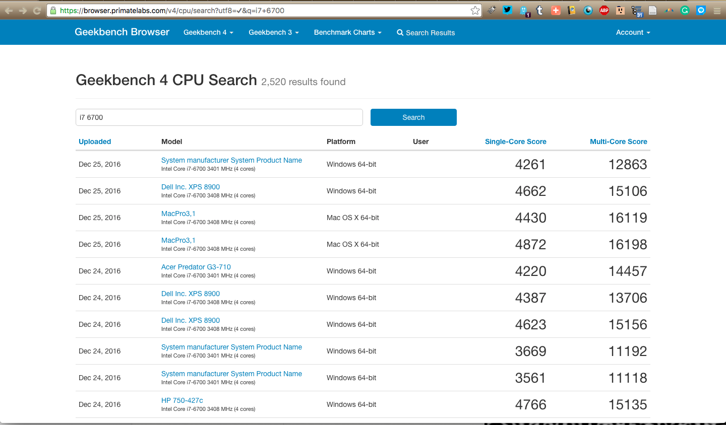

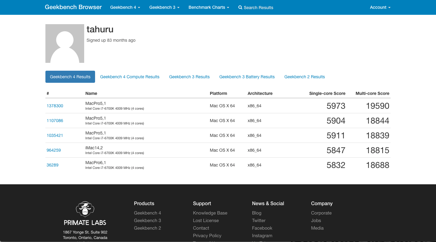

Hi everyone!
I have lurked these forums MANY times before. They were great in so far keeping our 2007 mac pro still working and highly upgraded as far as the video card goes.
Anyway, I am thinking of whether to get a 2012 5,1 model and upgrade it or buy a whole new computer (it would then not be a mac because the can is the least pro computer ever). I was looking for some information in geekbench, and came accross something that is really interesting: someone posted both a 3,1 and 5,1 score... with an i7 6700K!!! Here is a link and a couple of screenshots.
https://browser.primatelabs.com/v4/cpu/489074
https://browser.primatelabs.com/v4/cpu/1378300
Anyone here has any idea if this is possible? And even more so, how to do it? His geekbench score shows clearly he is indeed using a mac 5,1 motherboard.
Thanks!

I think what you are seeing could be a hackintosh. I could be wrong, but I think part of getting OSX to work on non Apple hardware is to trick it into thinking that it sees an Apple motherboard.
Reactions: TheStork

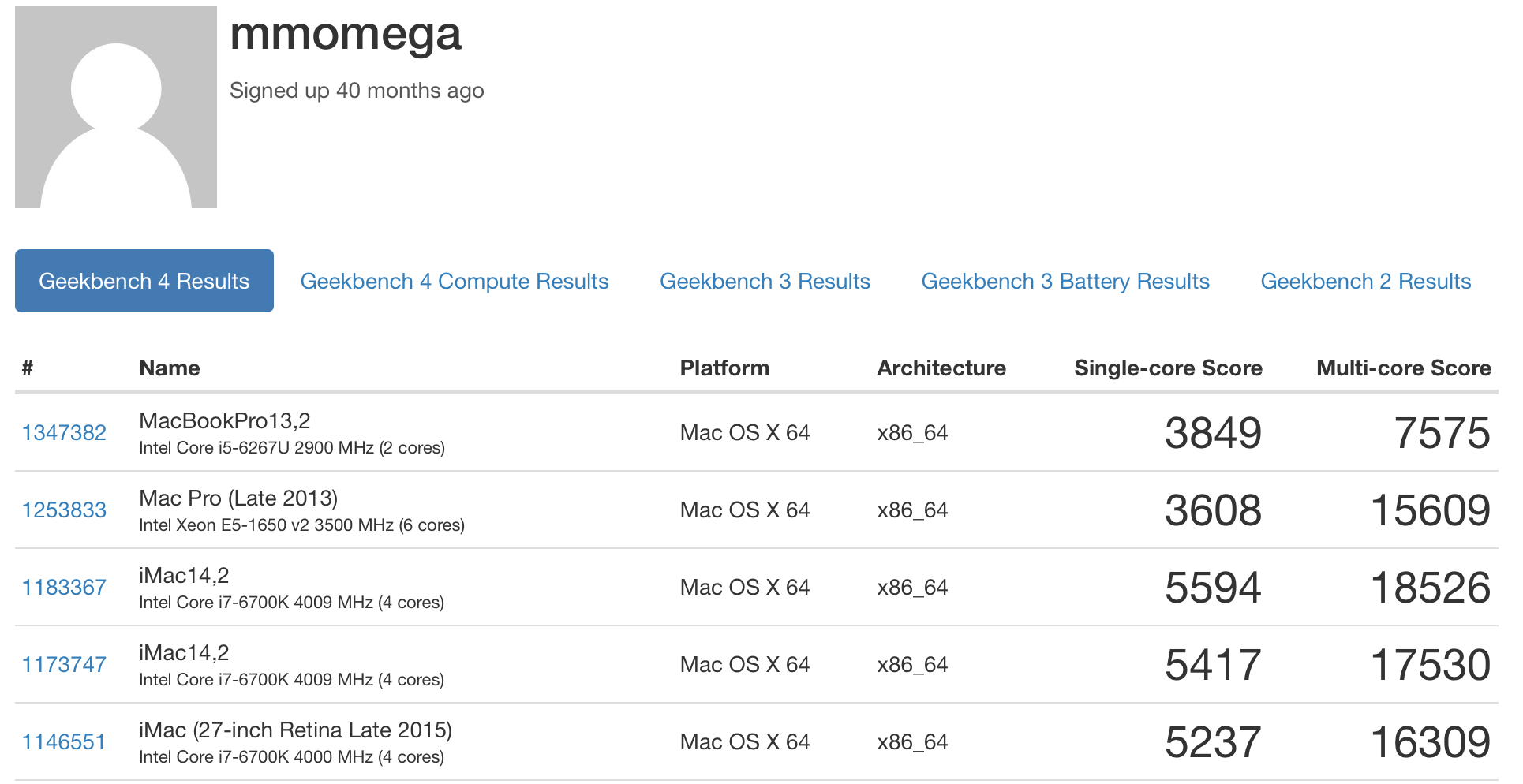

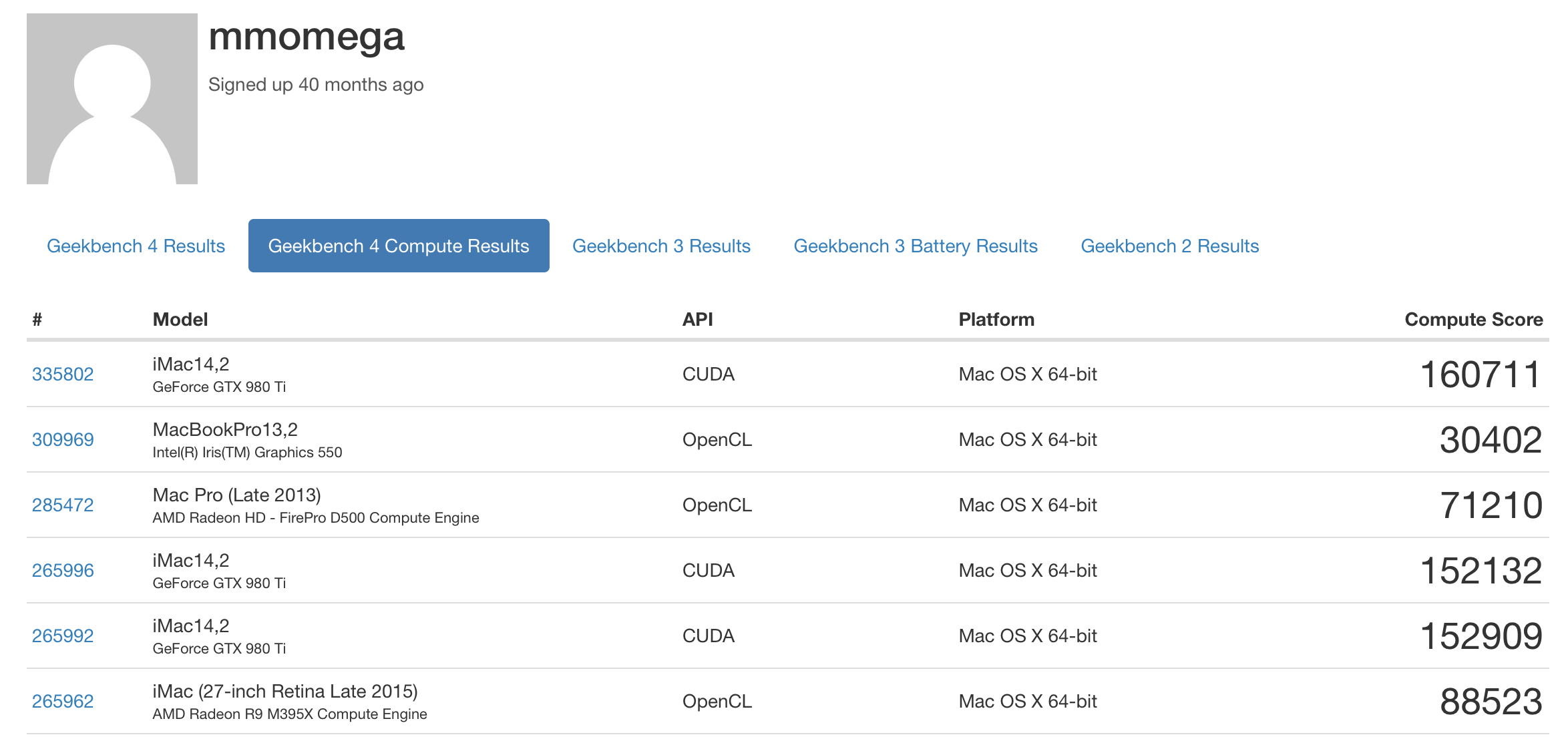

That's just what GeekBench reads off of the computer / SMBios.
Like the photo below is mine.
The Hack is the "iMac 14,2" and this is just the compute test on GeekBench4.
You can see how a GTX980Ti compares to my MacPro D500, 5k iMac M395X and new tMBP with Intel550.
Can also see even with zero overclocking the 6700k in the Hack scores a good 2,000 more than the 6700k in the latest iMac 5k, which scores slightly more than the 6c nMP.
