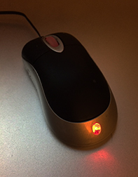

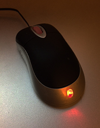

The USB power issue is affected by the USB extension chord. If the mouse is connected to the USB 2 hub of the Cinema 30 display the mouse stops working for 2-3 seconds before coming back. The video portion is not lost. The same holds true for a USB 3 hub without external power supply.
If the mouse is connected directly to the Mac Pro via a USB 2 extension chord then the light goes out for less than a second and almost comes back immediately. If I use no extension chord and connect the mouse directly to the Mac Pro the light stays on at all times.

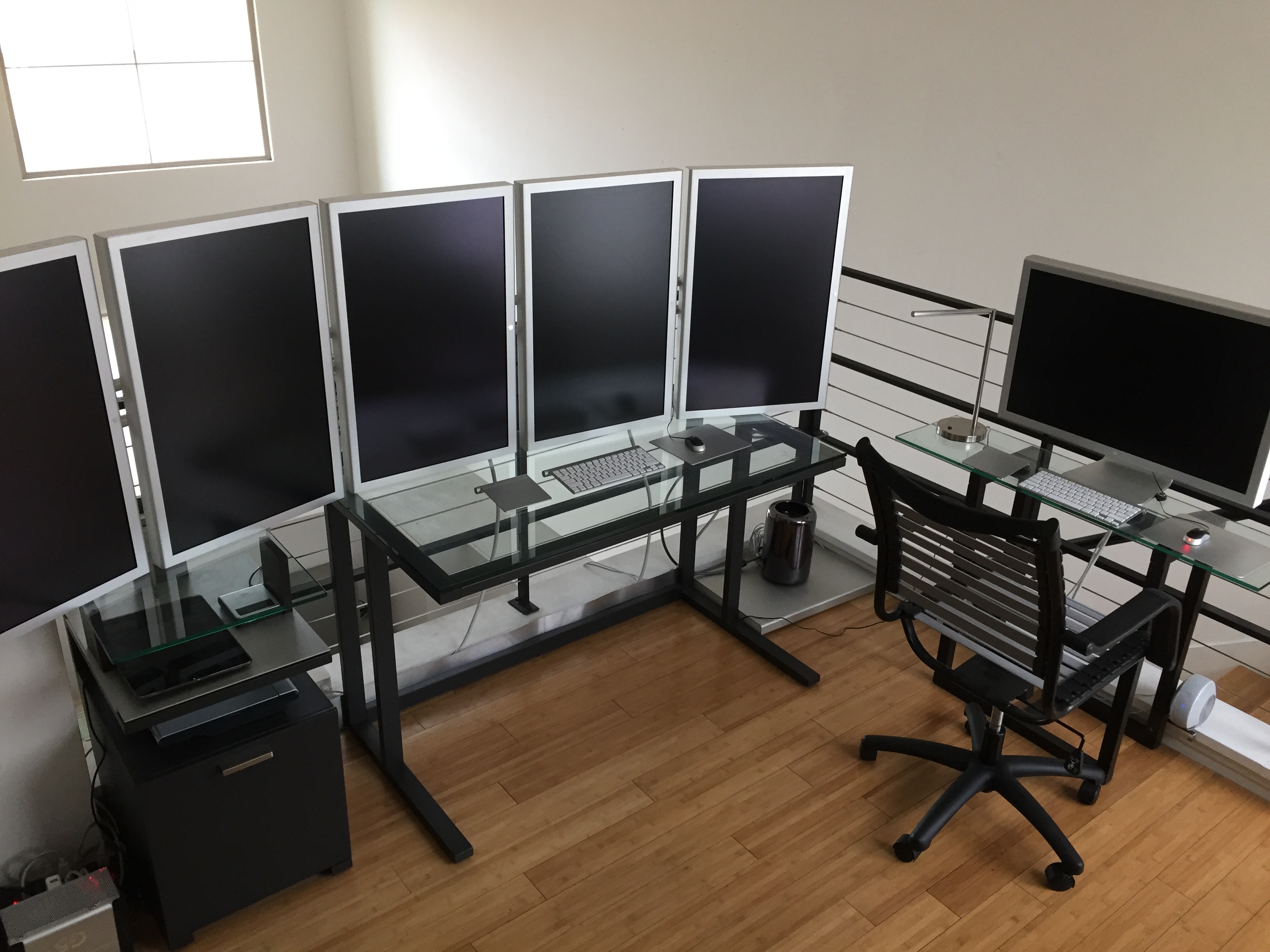

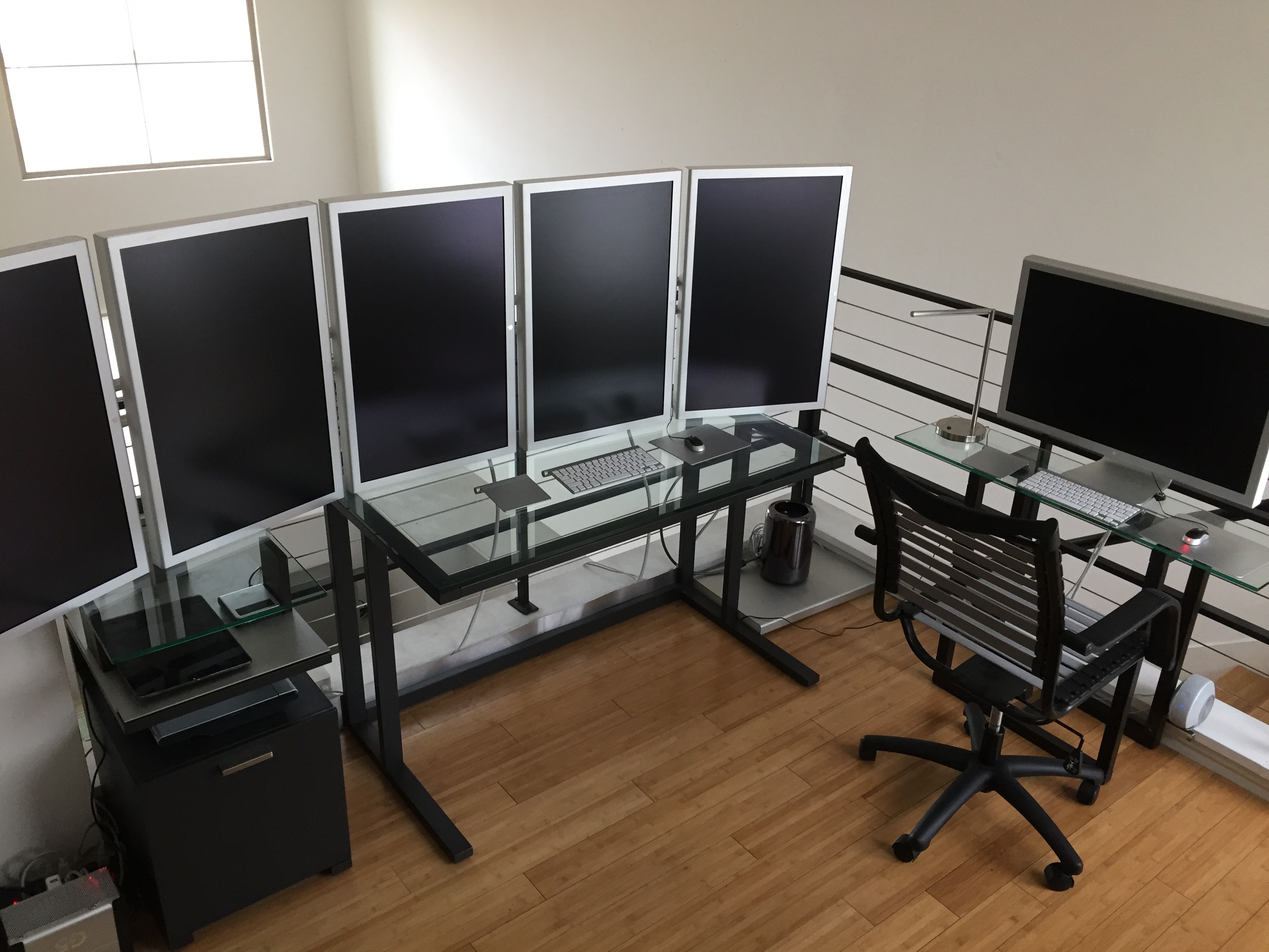

Can you please show us your working evironment with 6 x 30 ACDs 🙂

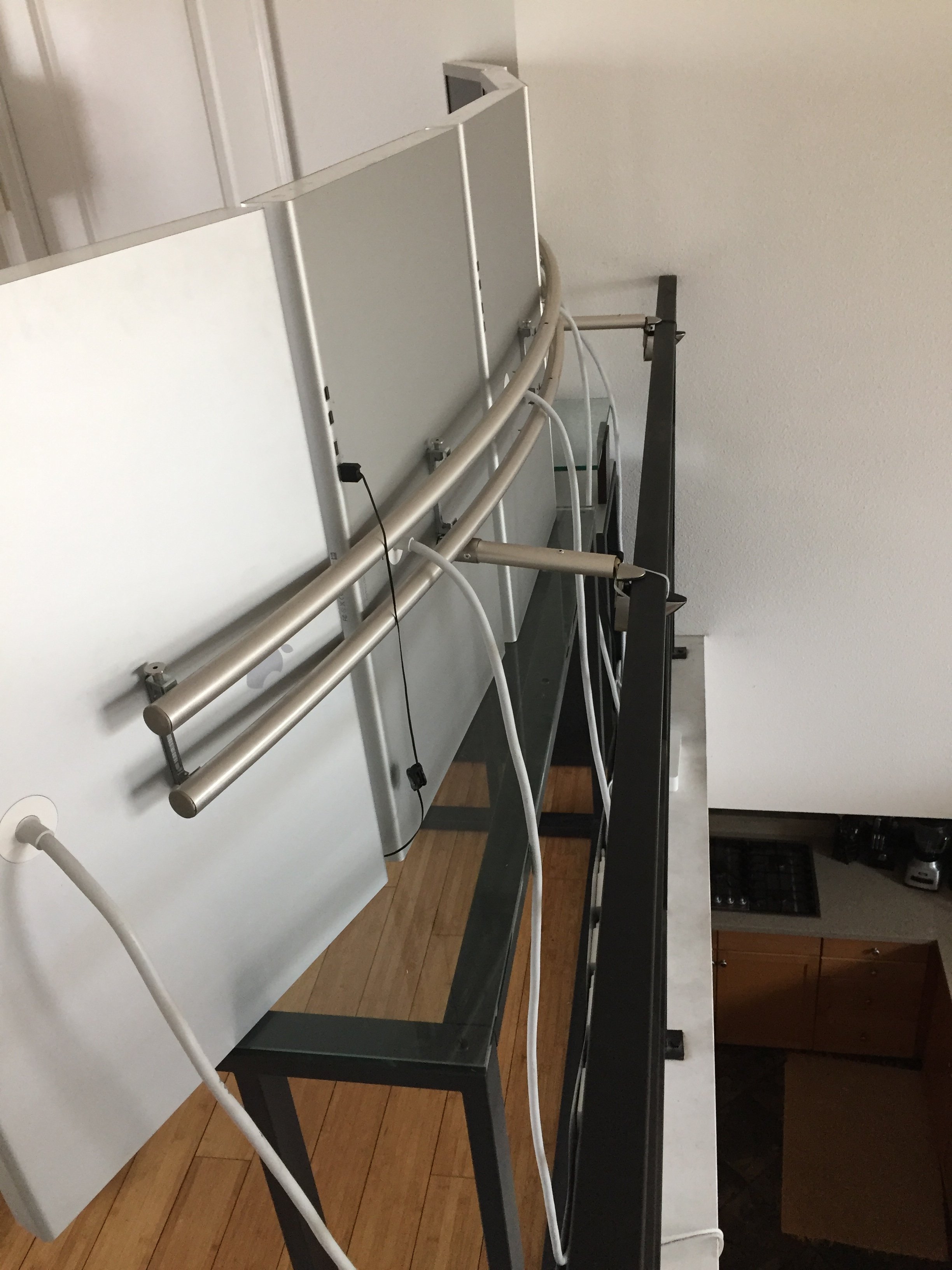

How can I deny a request from the legendary thread starter? 😉
The first picture illustrates how useful the Mac Pro is for certain setups despite its shortcomings. The seconds picture shows how two curved shower curtain rods from Home Depot make an excellent 'monitor mounting solution'. Obviously the weight of the monitors is on the tables. An old backside of a 23 inch Cinema Display functions as a platform for the MacPro to hide all the cables. I love the design of the old Apple monitors just as much as I love the design of the 2013 Mac Pro.

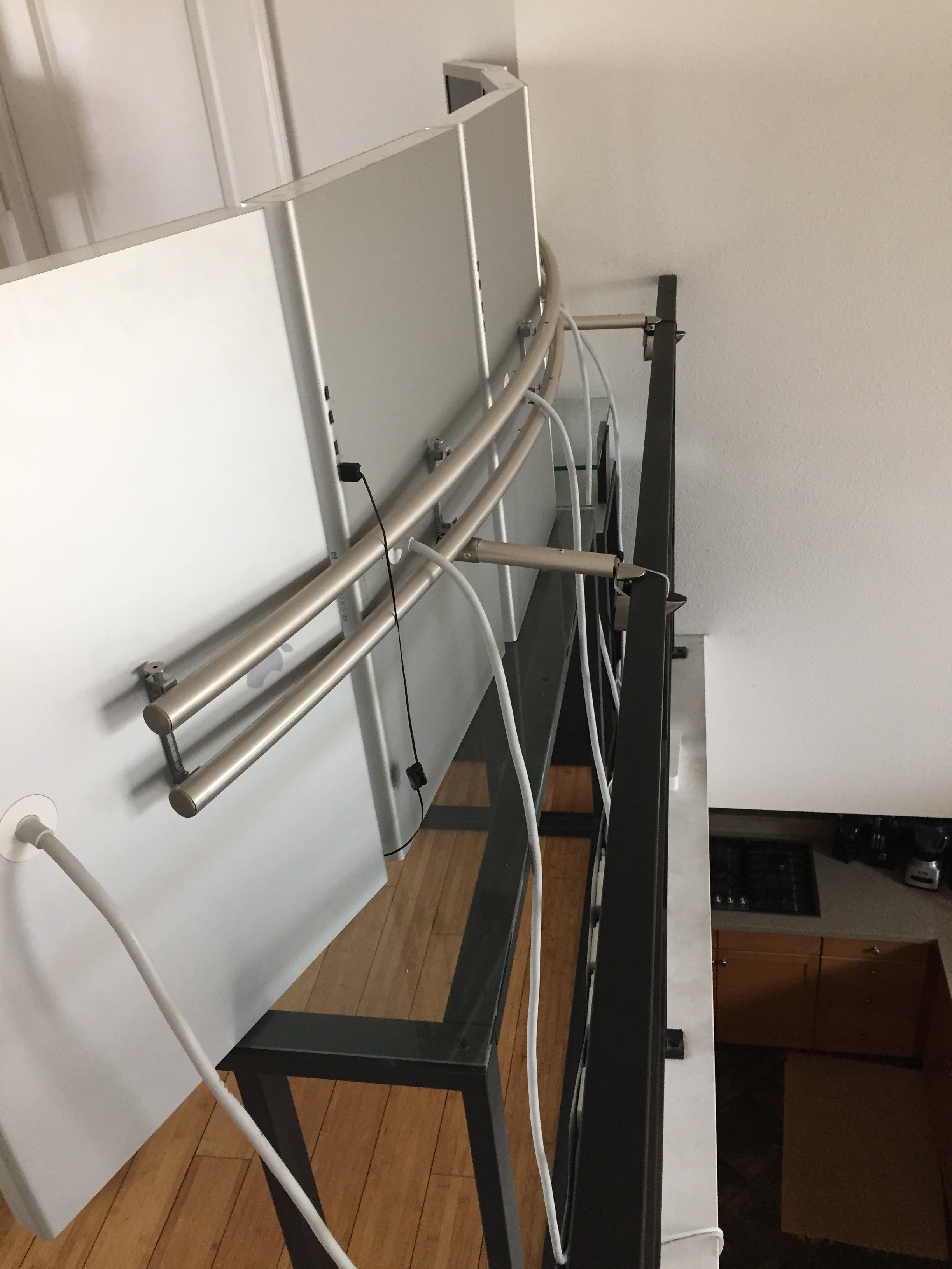

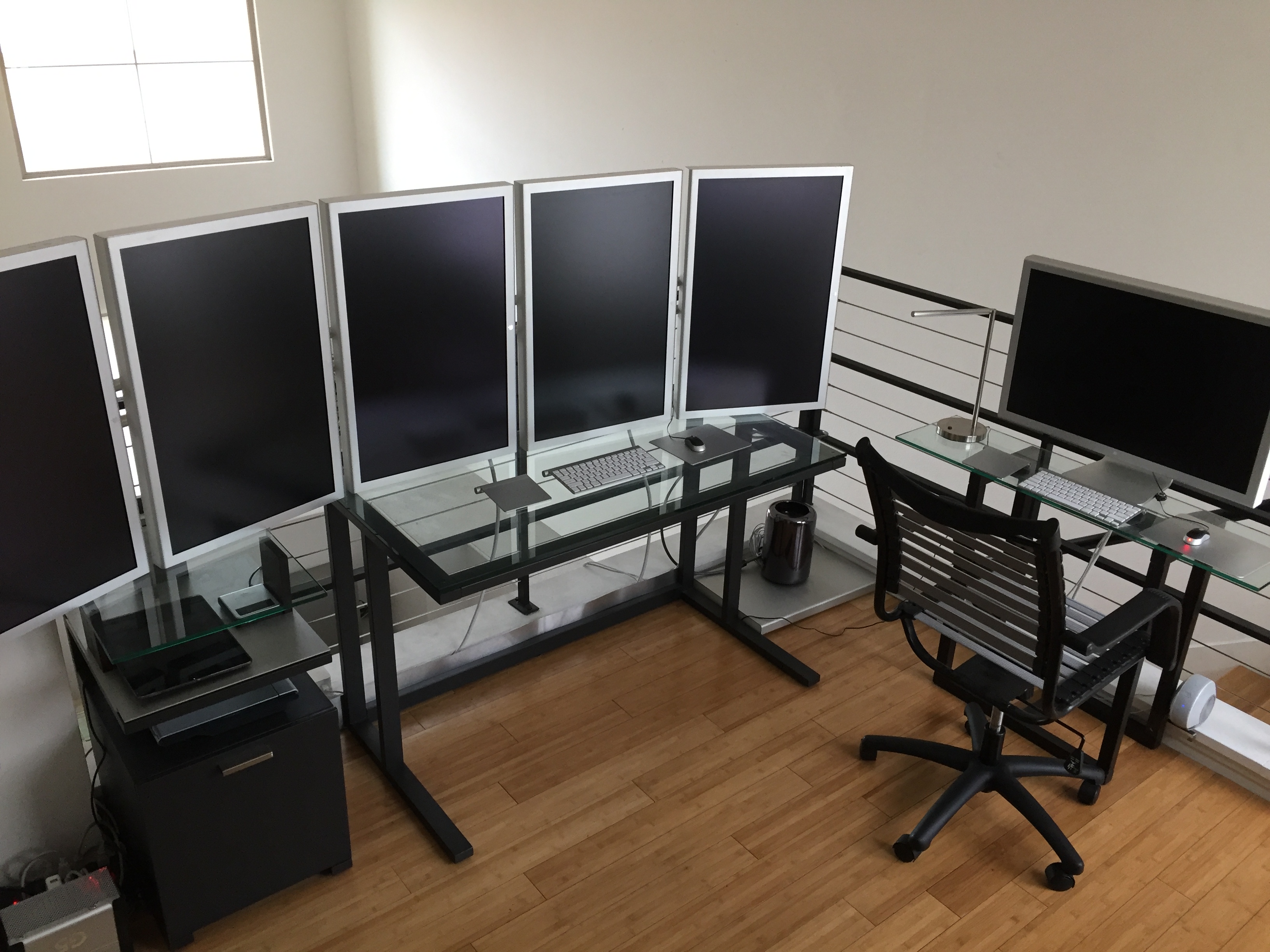

View attachment 677793 View attachment 677794
Very nice, congratulations.🙂

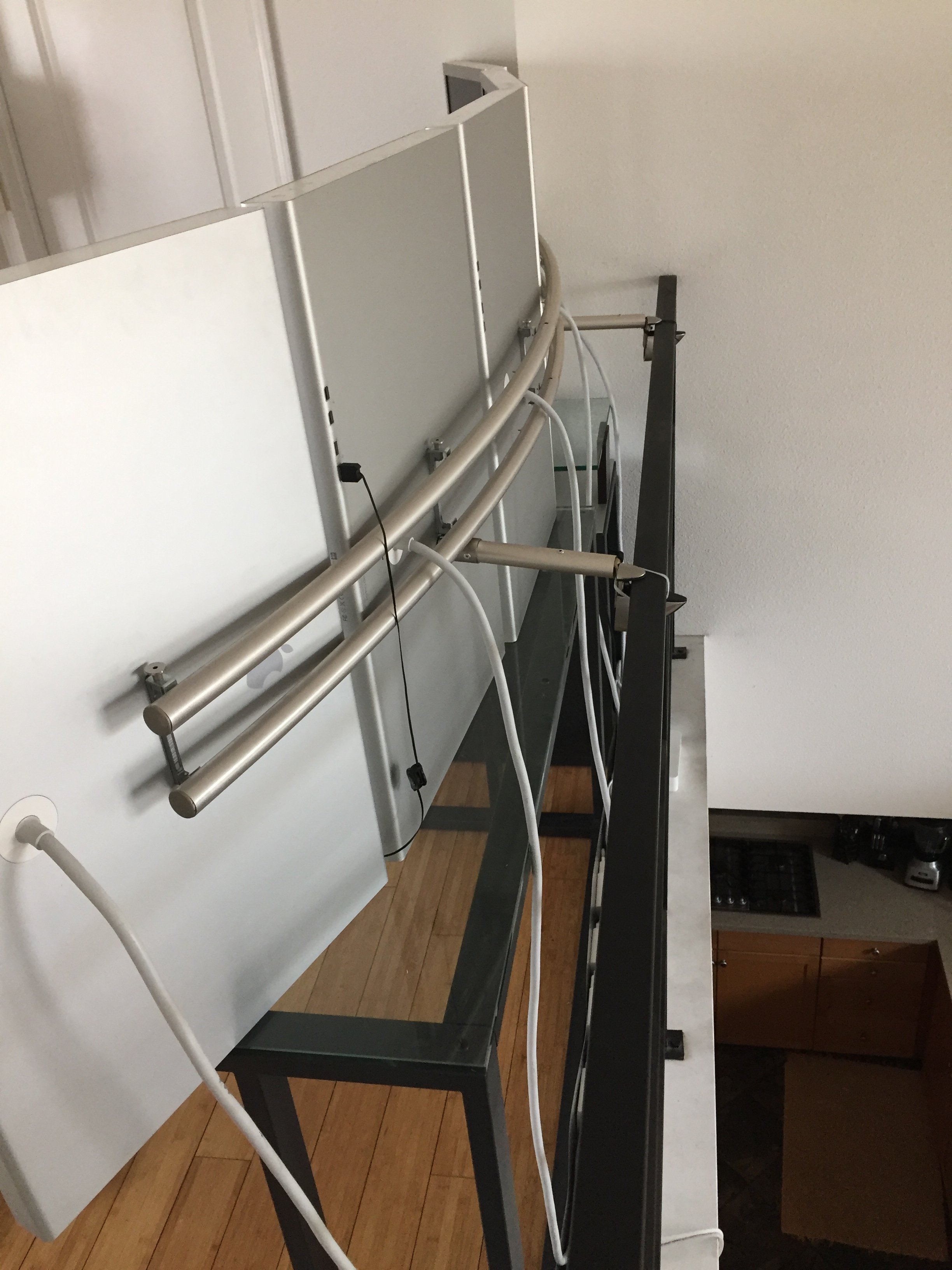

I've lost for words, FANTASTIC !
I don't know if it's the 5 monitors that impresses me or the fact that the desk isn't full of clutter like mine.
