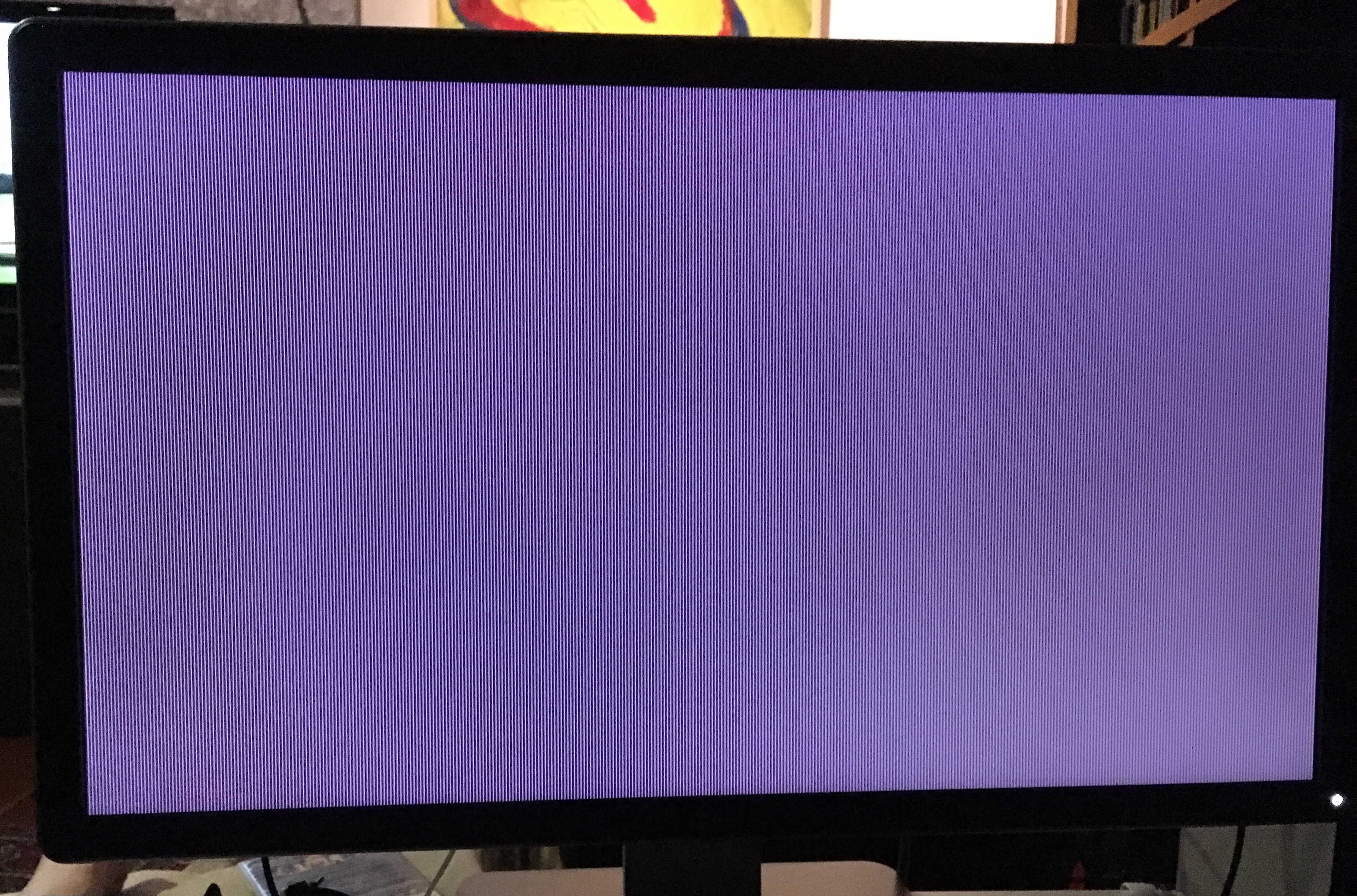

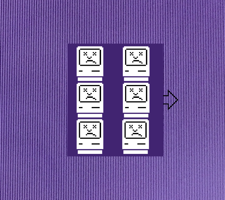

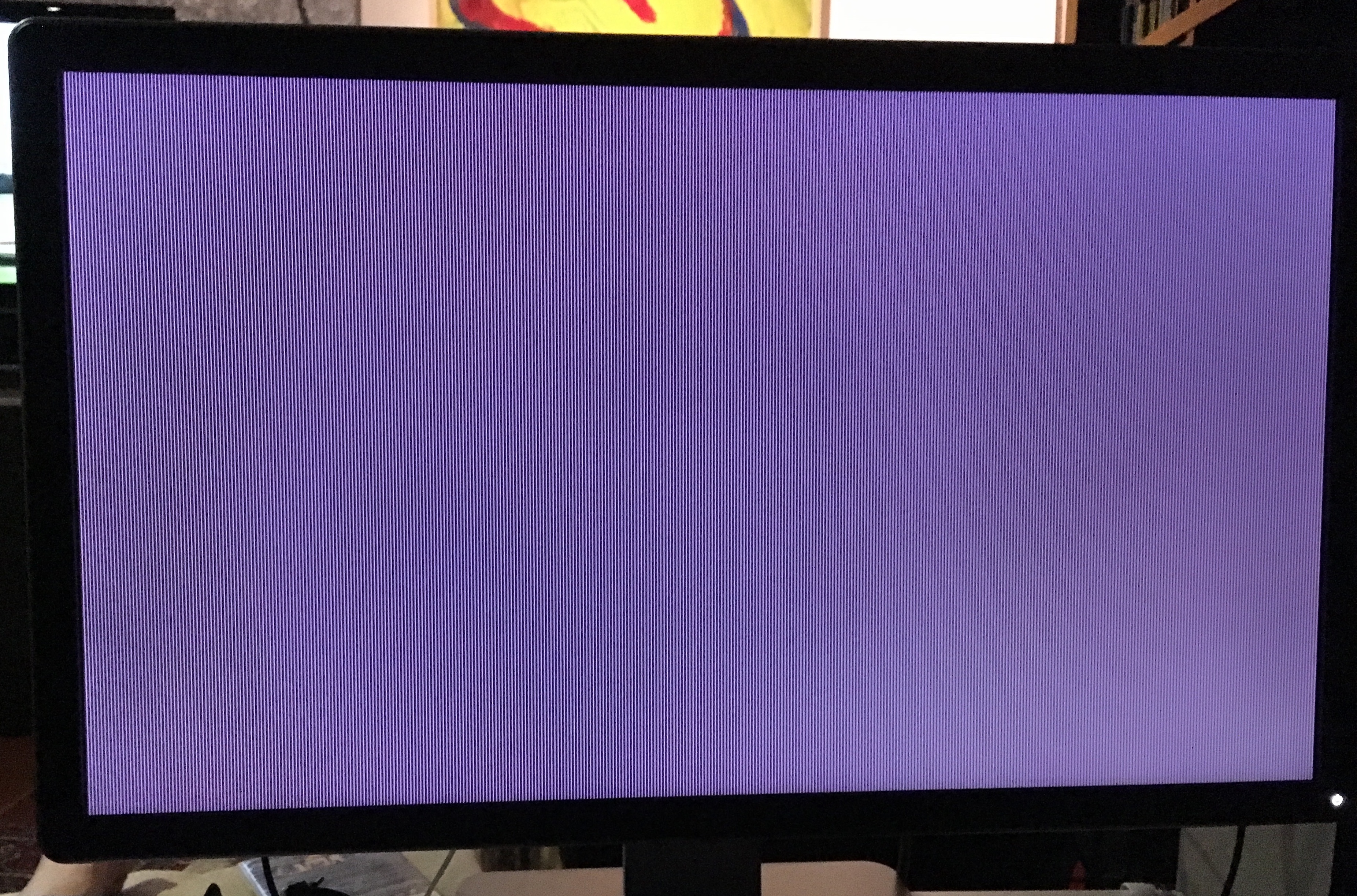

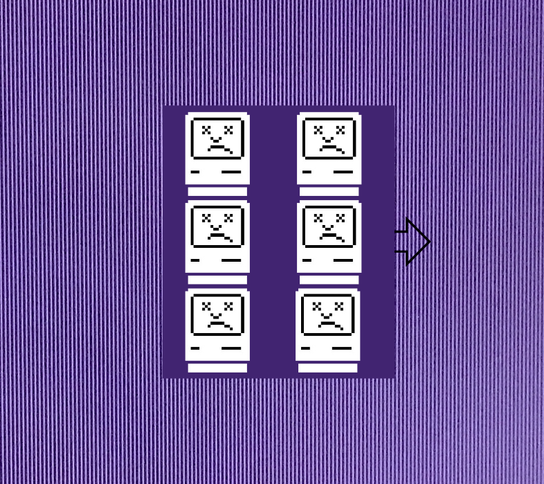

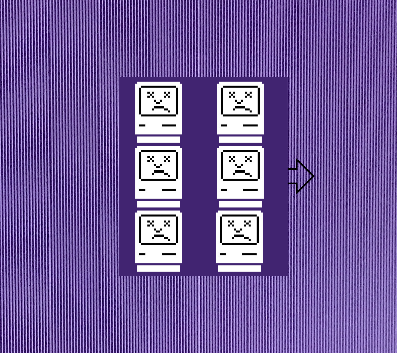

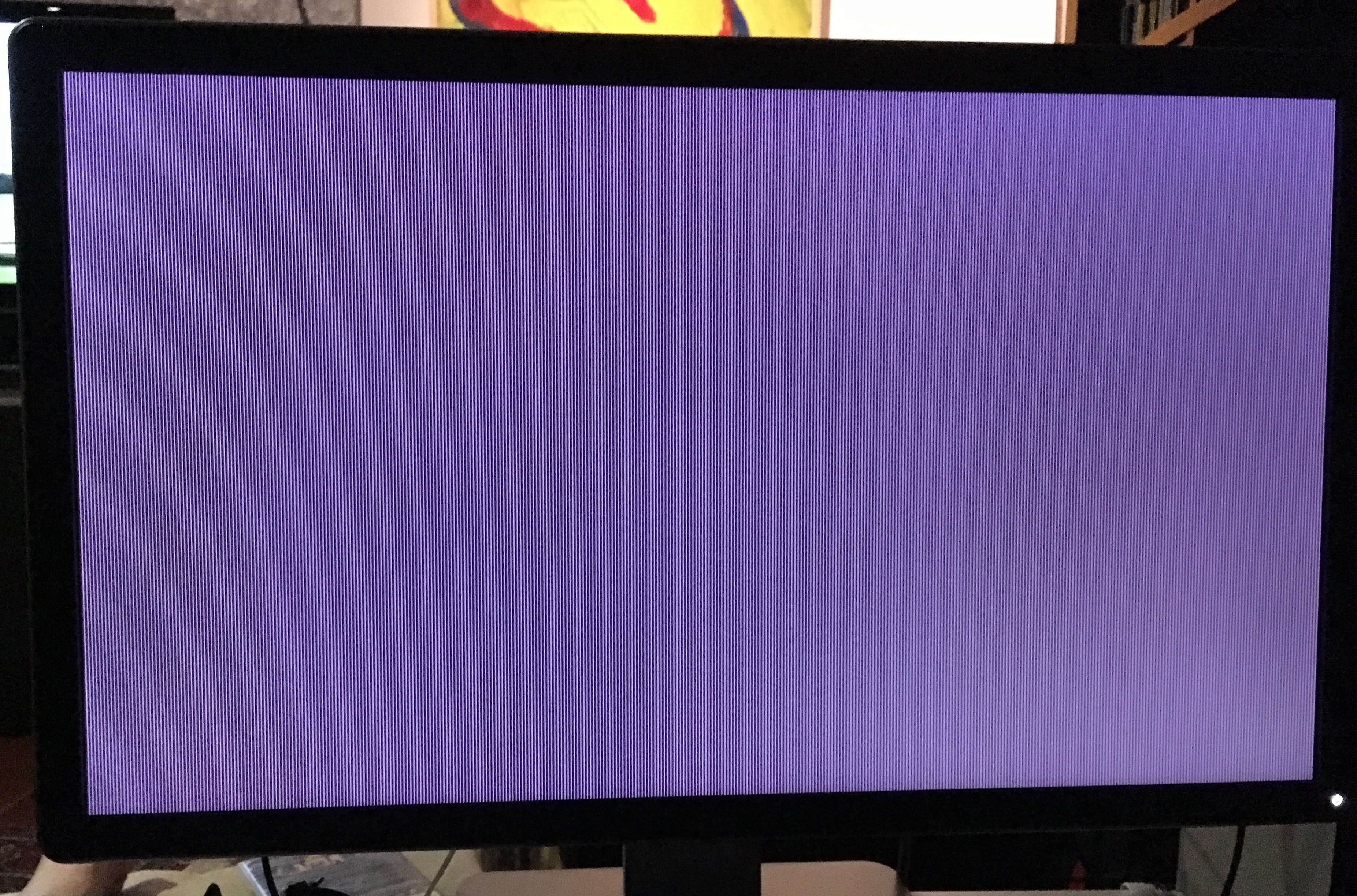

So much for Sierra 10.12.4 here, total freeze after a day. Nothing in the logs, so it must have been more than just a gpu crash.
Total hardware freeze, WindowServer crash ?..it is strange that nothing is noted is sytem logs.
Nothing in the log and the screen went from freeze to gibberish. Gibberish like an overheated gpu or bad cable, lots of fine coloured lines. After 20 seconds followed by a restart. The mac wasn't hot at all, so heat wasn't the cause.
FWIW haven't seen anything like what you are describing
It was a first for me to, but this is what it looked like.
