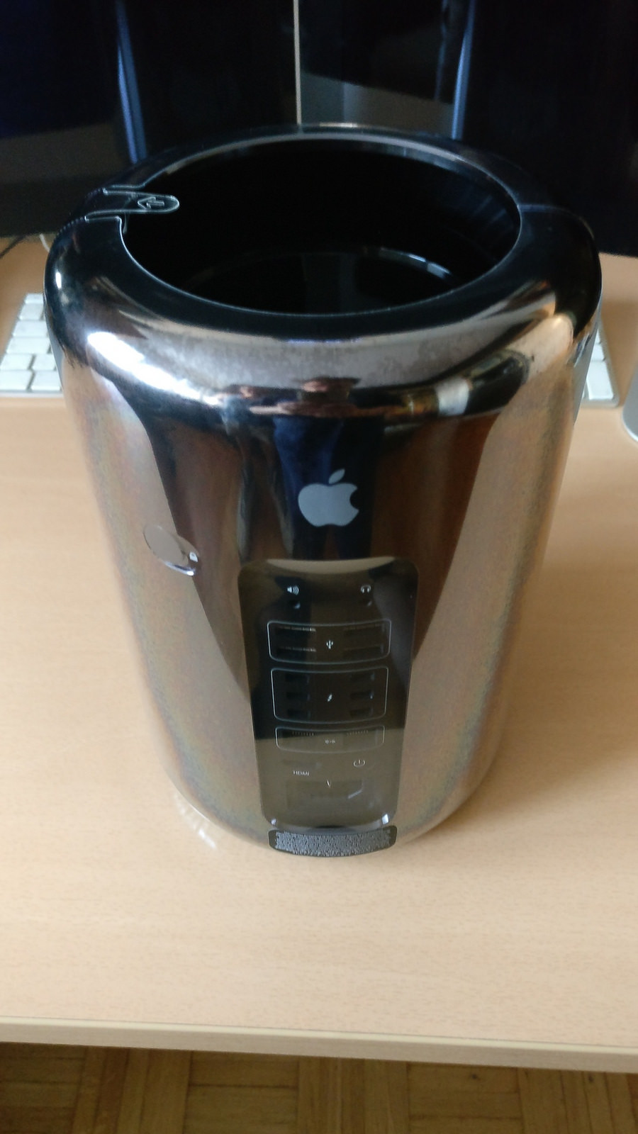

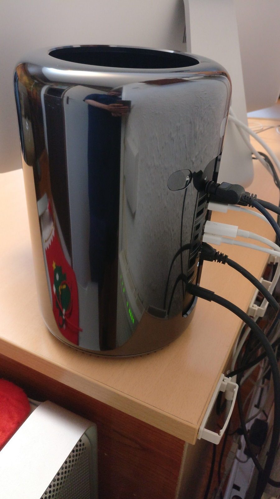

I picked up new machine today, it came with macOS 10.12.5. Faulty Quad-Core Mac is replaced with 6-core due to Quad-Core unavailability.
I am not going to perform any software upgrades until I get full confidence in Mac´s stability.
Everything is ok for good 5 hours :)

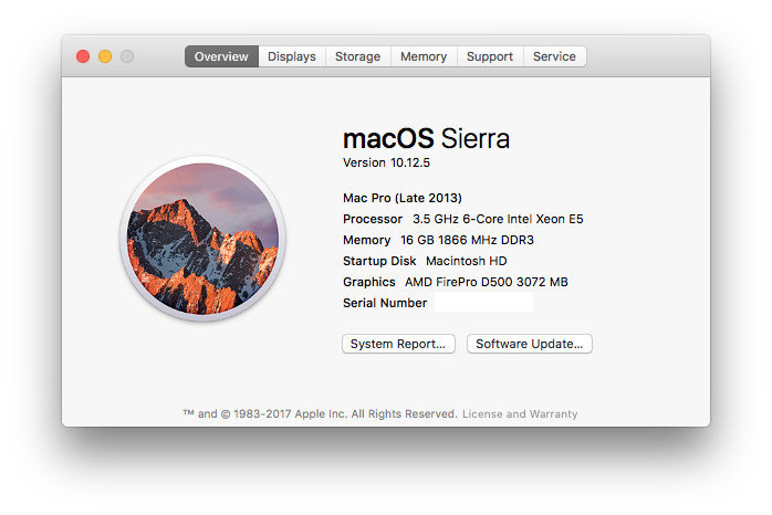

Model Name: Mac Pro
Model Identifier: MacPro6,1
Processor Name: 6-Core Intel Xeon E5
Processor Speed: 3.5 GHz
Memory: 16 GB
Boot ROM Version: MP61.0116.B25
SMC Version (system): 2.20f18
Illumination Version: 1.4a6
Connected displays:
- Thunderbolt Display
- 27-inch LED Cinema Display
- 24-inch LED Cinema Display
Peripherals:
- Apple ALU Wired Keyboard (to 27" LED USB hub )
- Genius Mouse G300 (27" LED USB hub)
- Logitech Z906 connected via Toslink
- USB 3.0 Orico 3-port hub
Network:
1GbE connected to NETGEAR GS116 switch -> Internet Provider Router
....Fingers crossed.... :D
