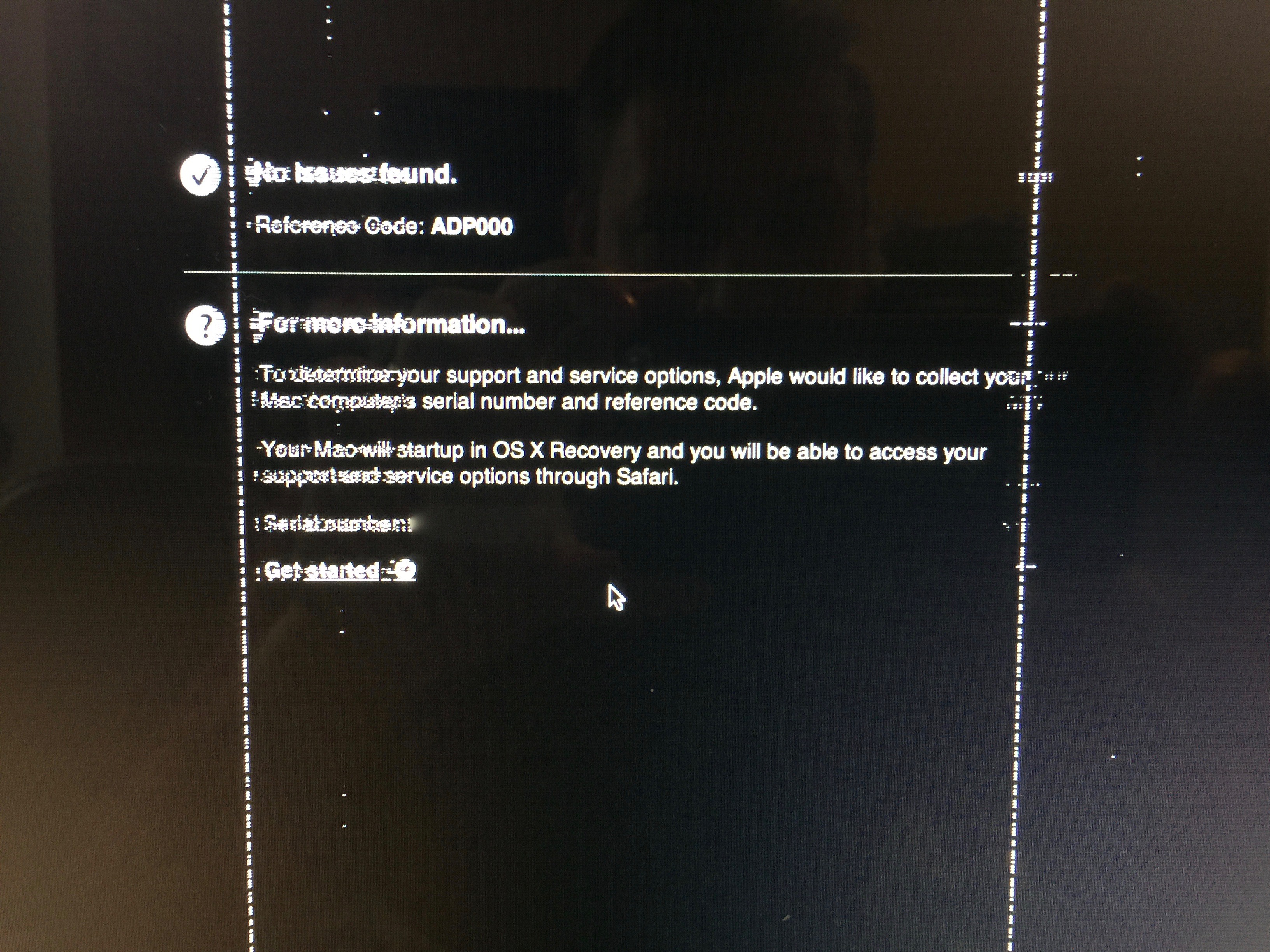

I had the same/similar problem with my D700s. The hardware diagnostics test has limited ability to find problems as evidenced by the pic I snapped. 😉
