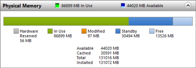

Also, take a good look at how your system reports memory usage. For example, my home workstation shows:
Right now it's not doing much, so most tools report about 44 GiB available. A closer look, however, shows that only about 13 GiB is unused, and about 30 GiB is used for filesystem caches. Sometimes I'll see just a few hundred MiB as "free".
Depending on what you're doing, having dozens of free GiB for the caches can make Safari much snappier.
