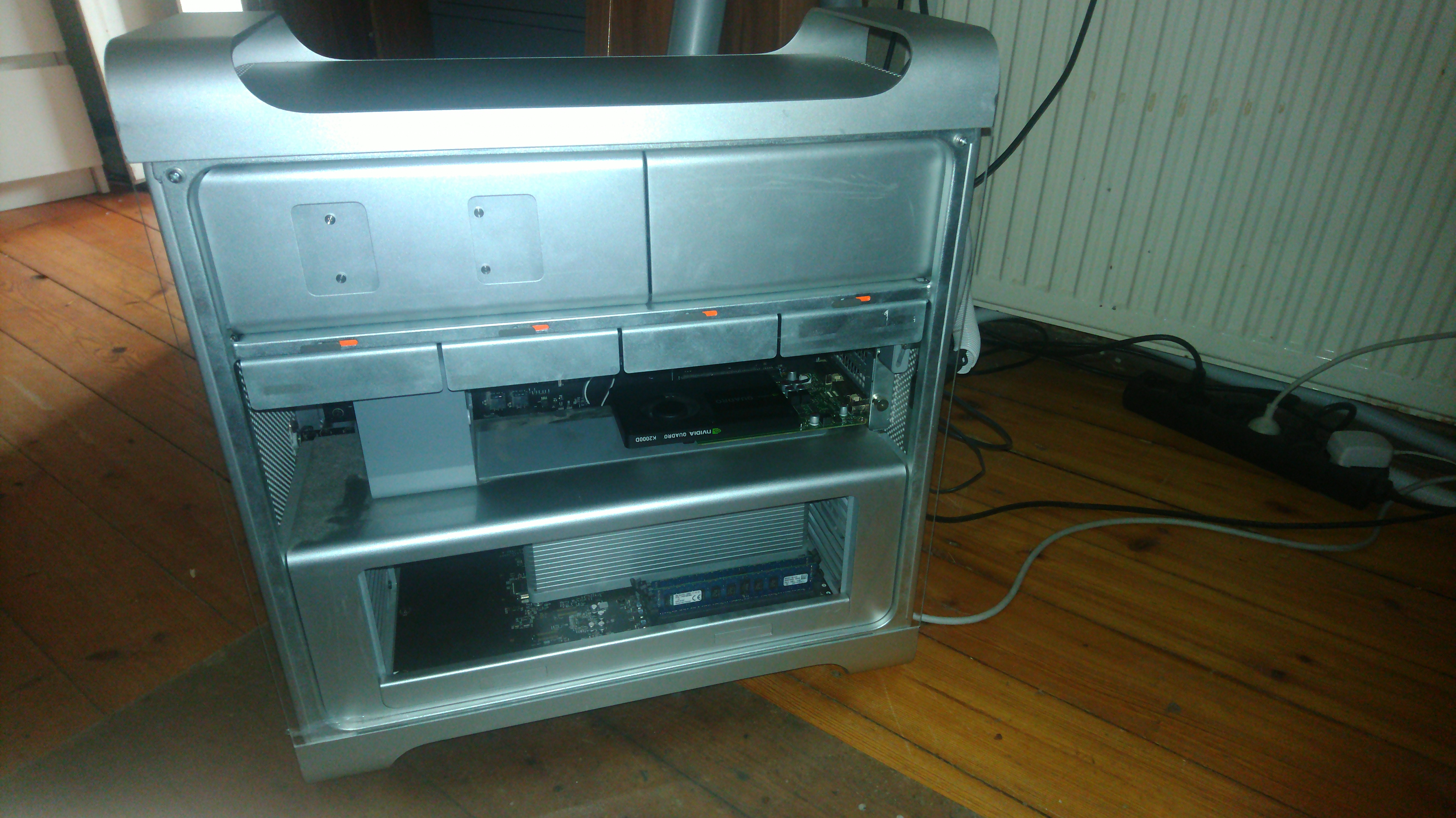

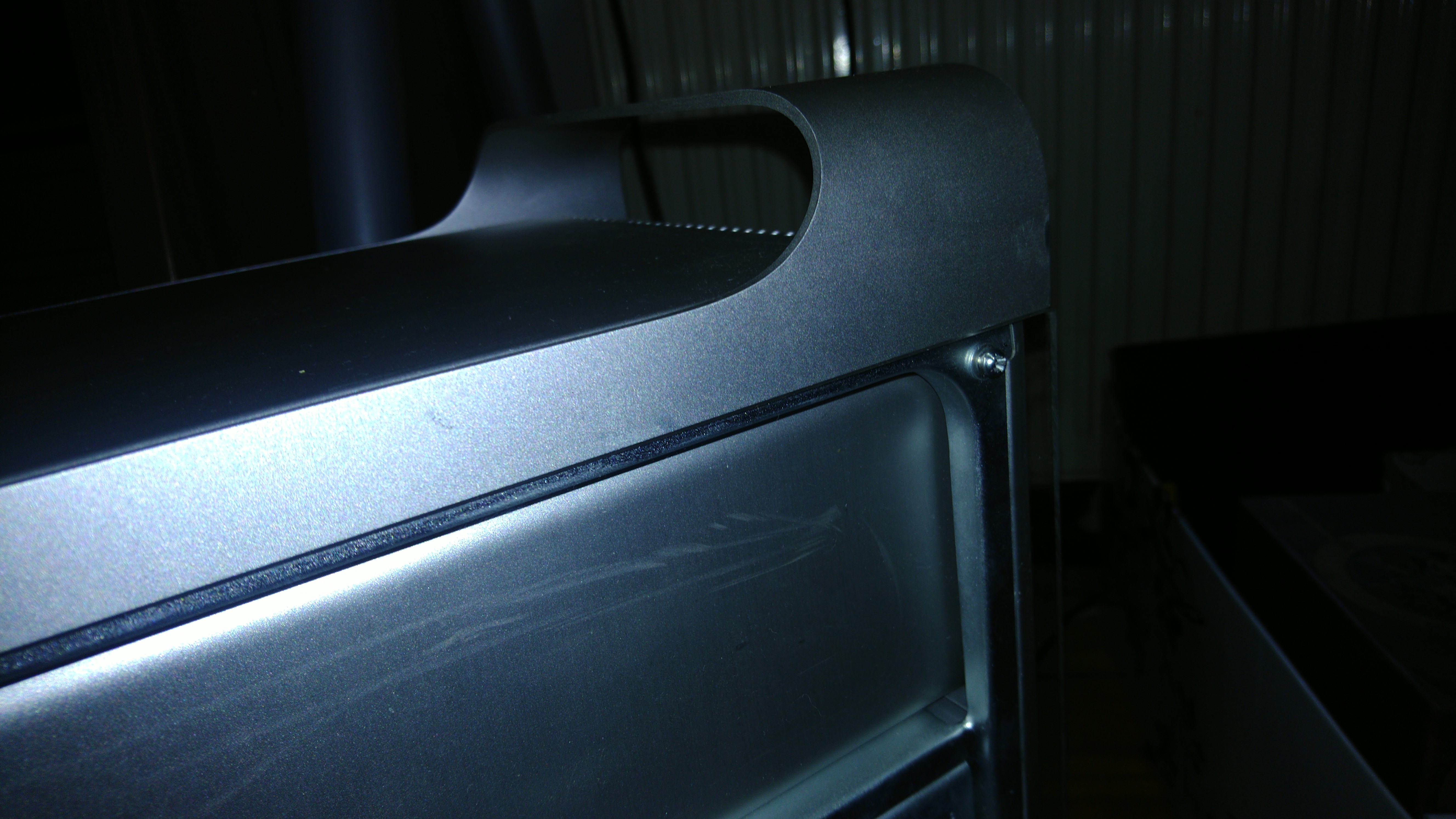

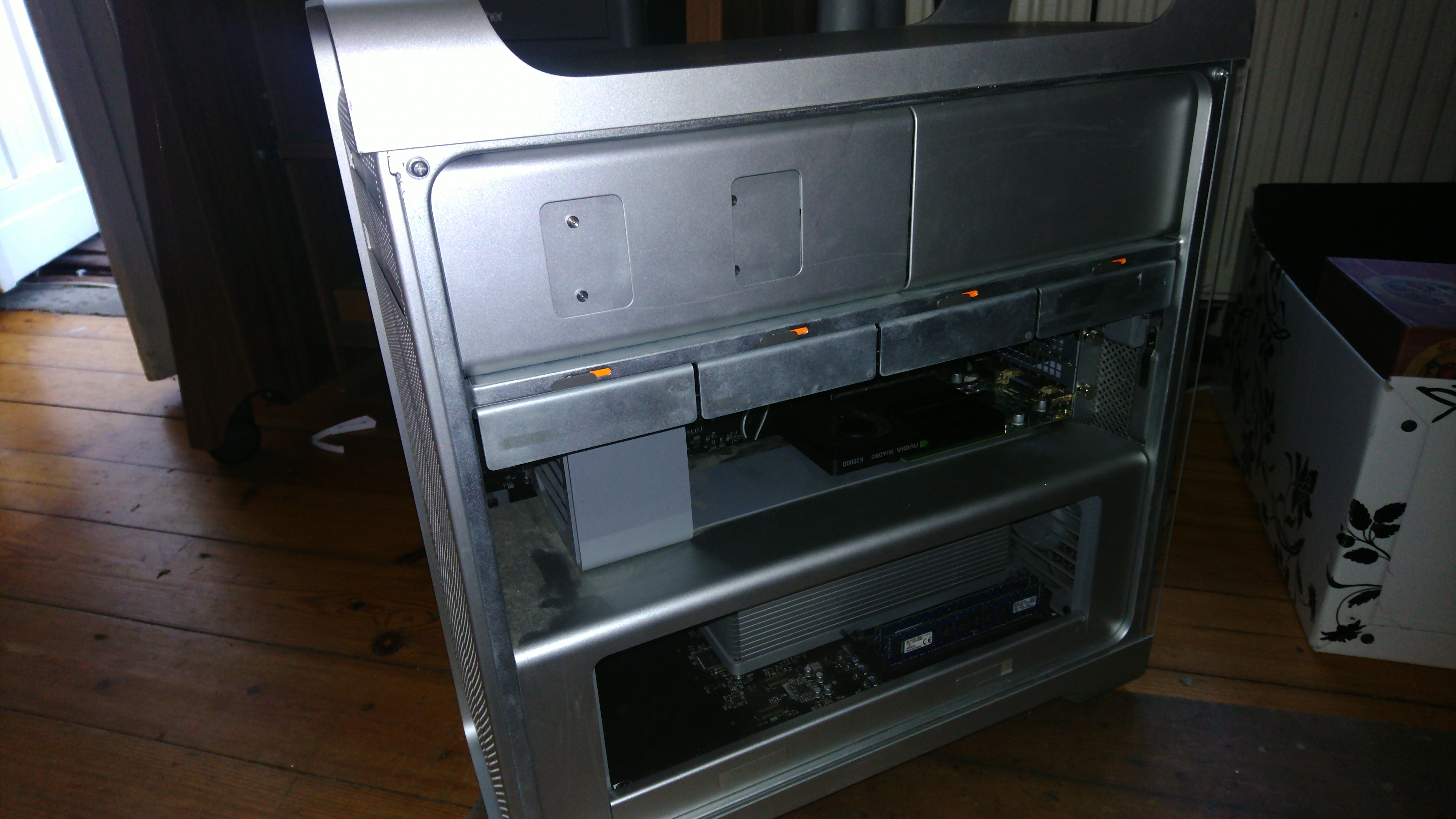

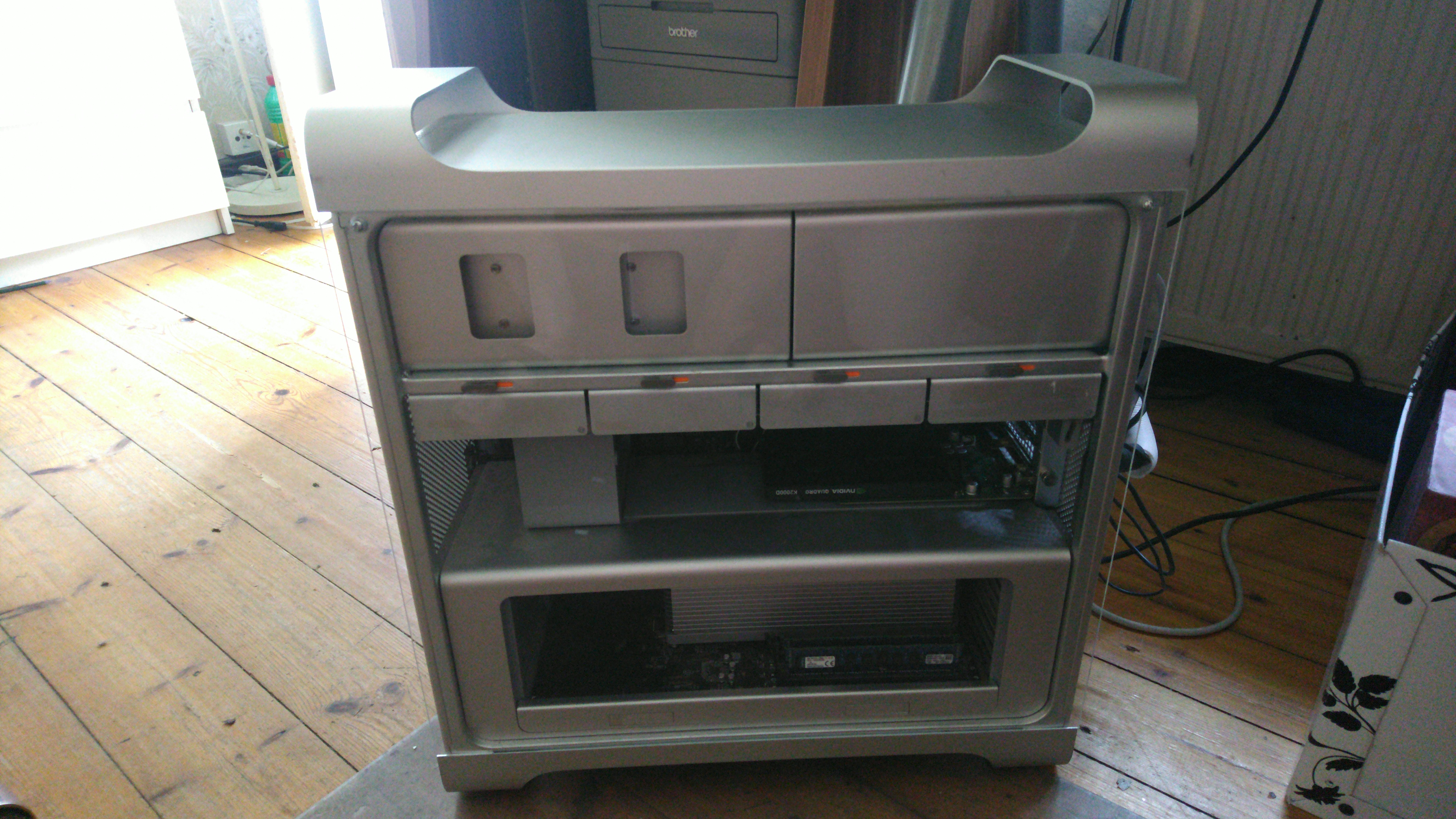

Hello guys!

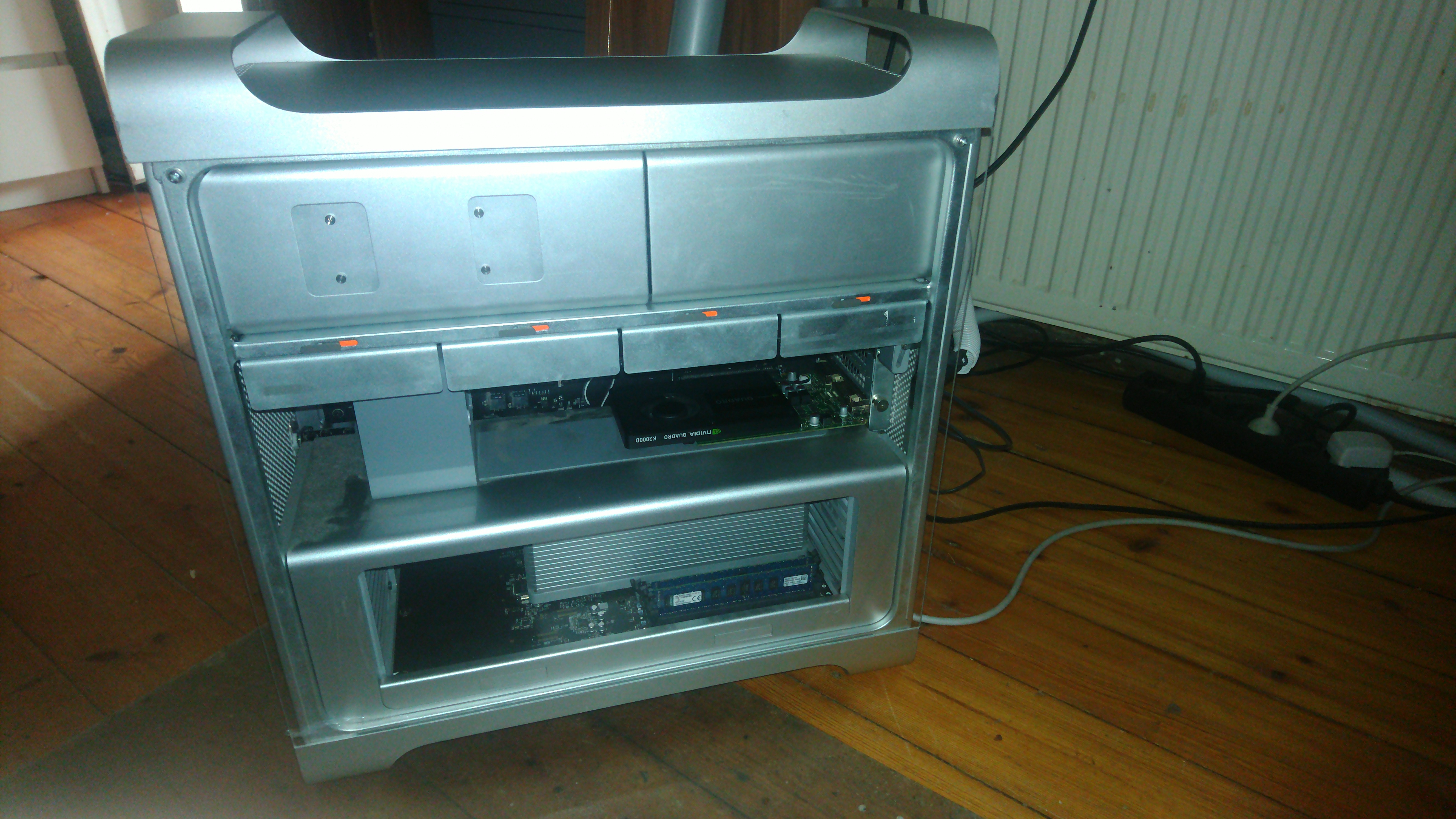

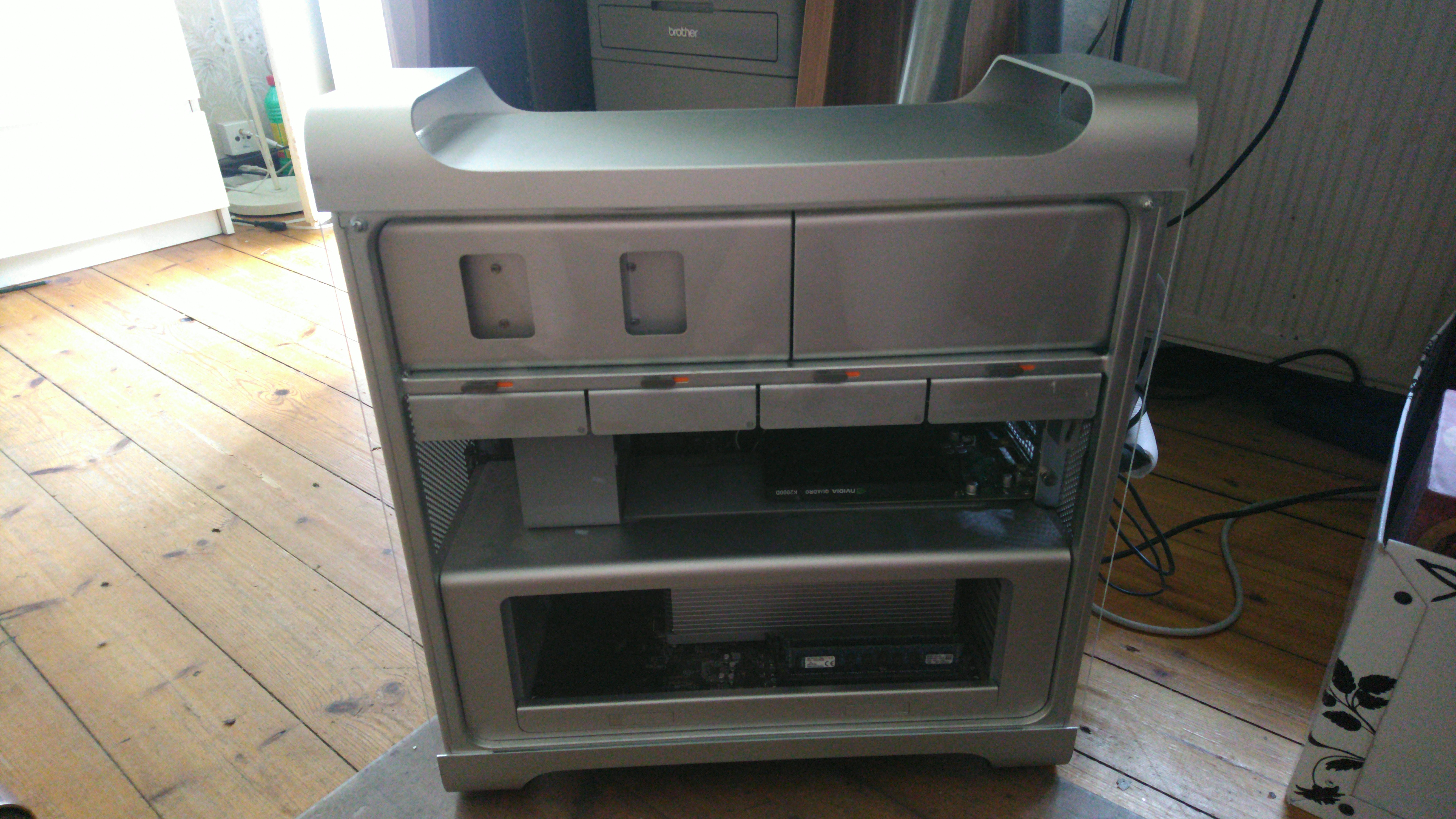

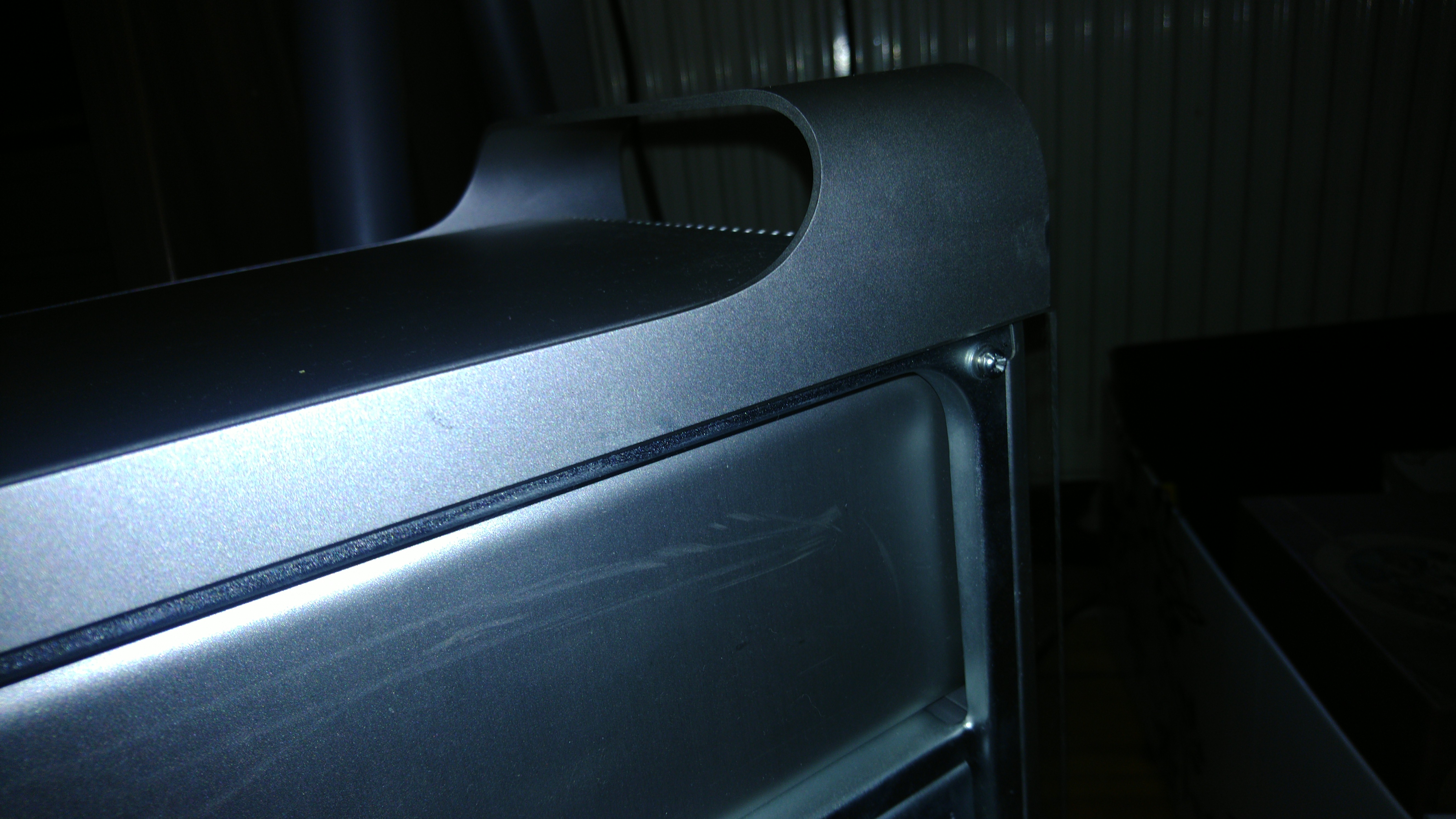

My friend and me made some Plexiglas Door for our Mac Pros 4.1(5.1)
Instead doing it the regular way:
https://www.instructables.com/id/Mac-Pro-Mod-Transparent-Side-Panel/
We found much more simple tecnology:
  • Plexiglas can be purchased with the correct size of the aluminum door
  • 2 upper holes of the Mac Pro are made a bit wider
  • 2 rivet nuts (German: Blindniete mit Gewinde) need to be installed in the holes of Mac Pro
  • 2 screws to tighten the door
Very simple technology, easy montage, looking great.
I want just share my experience.
