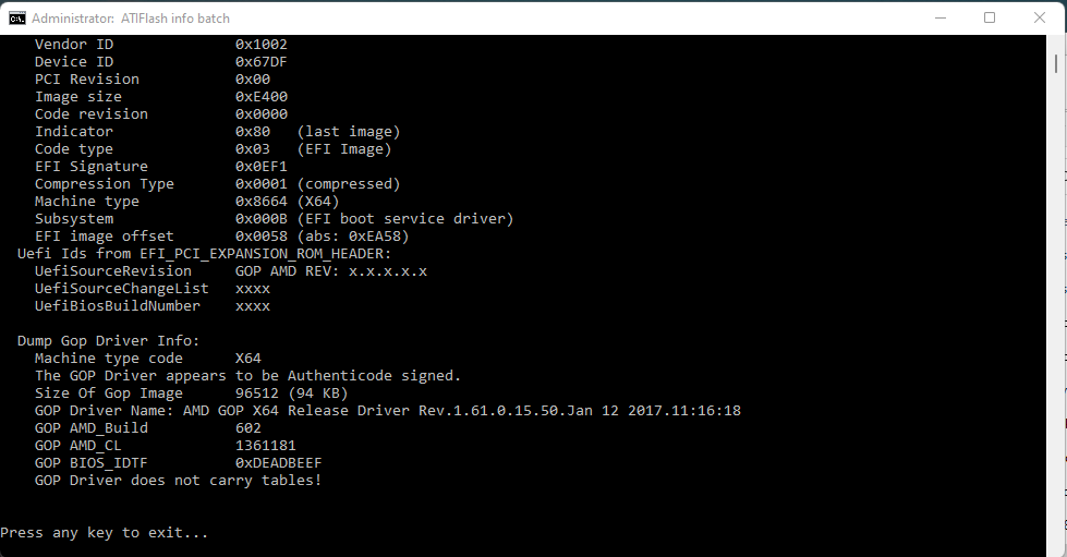

The RX580 has booth PC VBIOS and GOP, if the card was used and the old owner edited the 'protected tables' in the PC VBIOS to try and get the card to preform better that invalidates the GOP ROM so you won't get any boot screens on a Mac Pro.
You can check your vbios for a valid GOP ROM
Just drop the original file on #AMD_ROM_Info.bat
