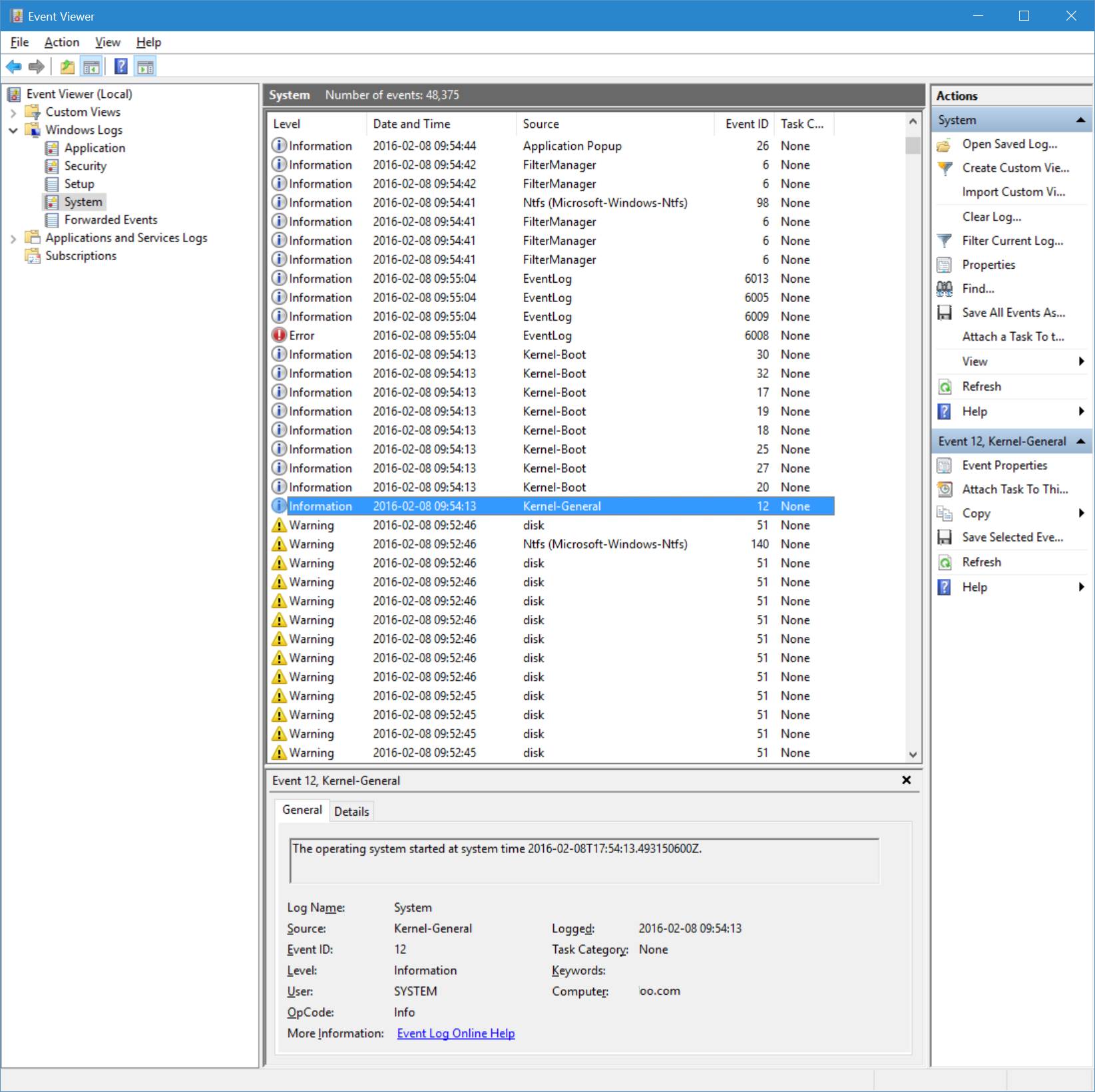

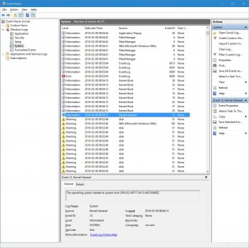

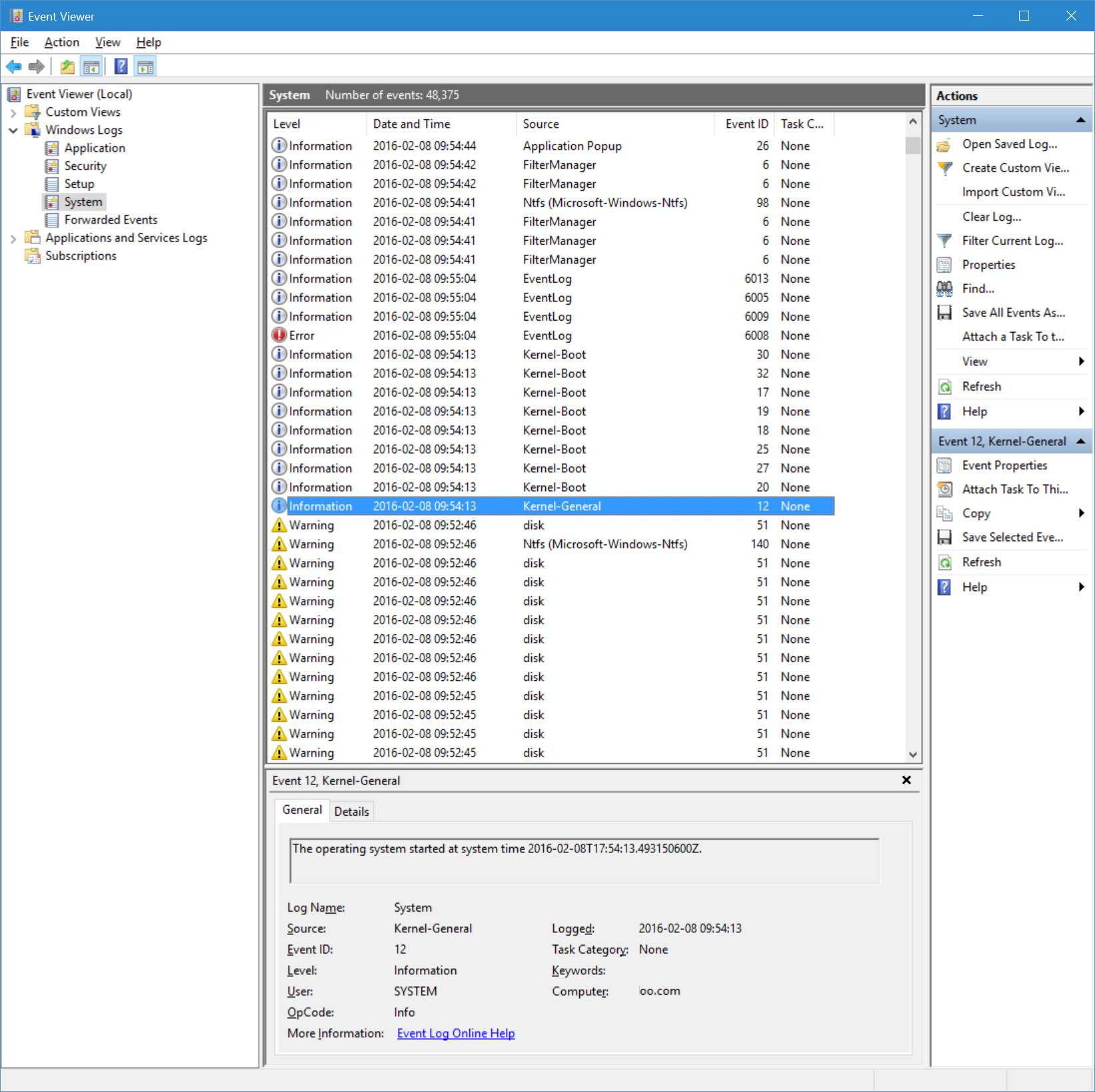

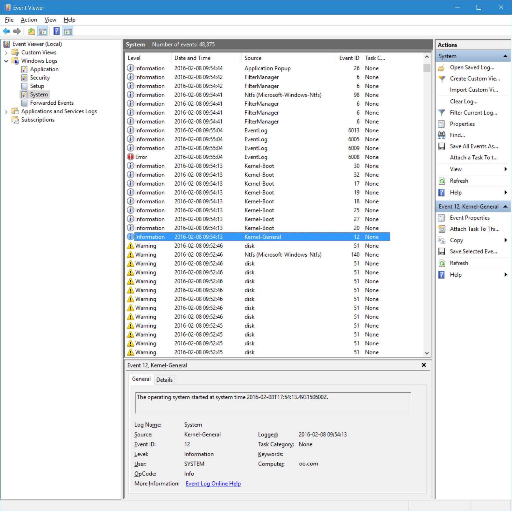

Look in the Event Viewer for system messages right before the restart. Post a screenshot if you want help.
The attached screenshot shows a system that rebooted following a string of disk errors.
