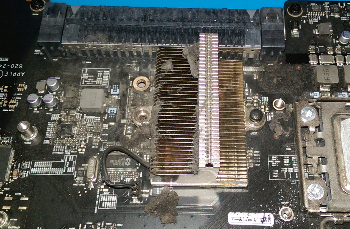

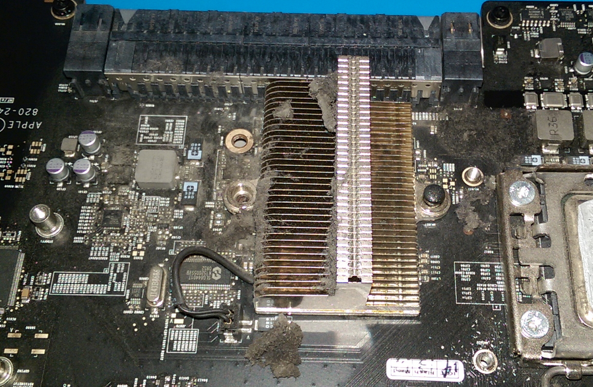

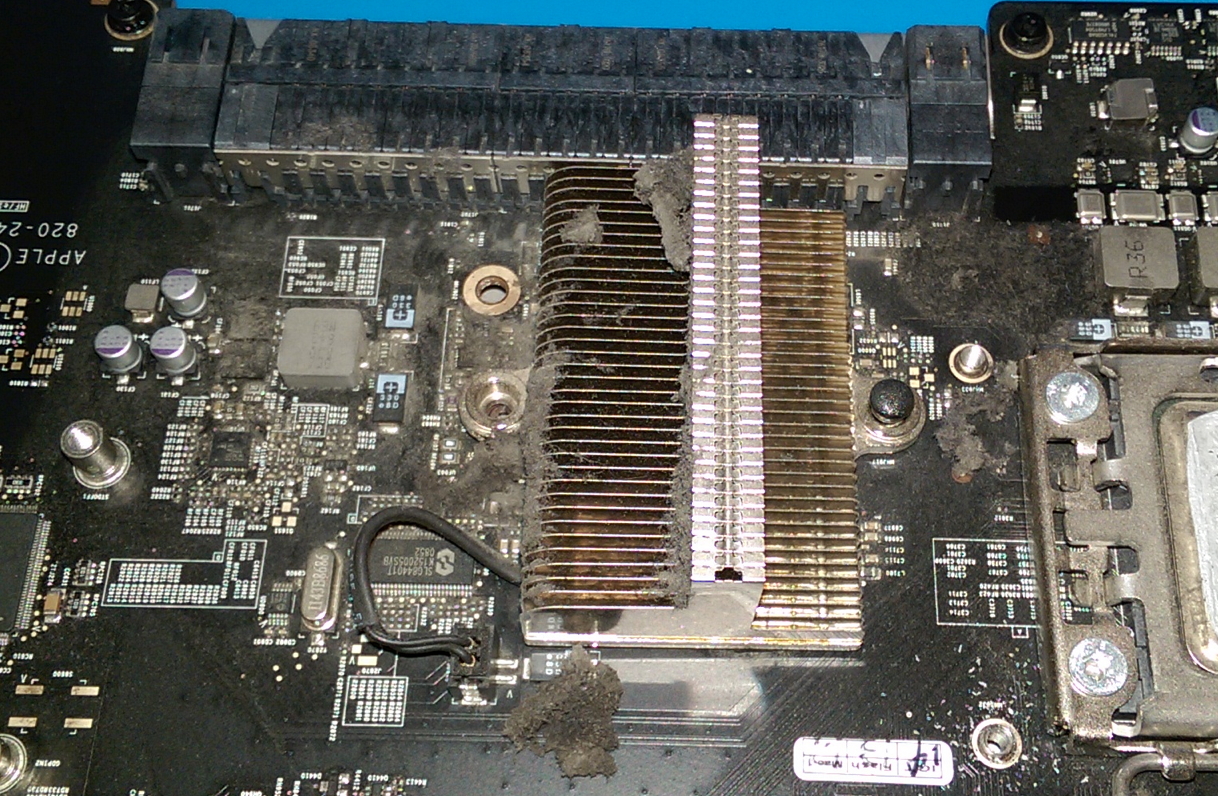

Uh oh...forgot to mention I have an active red LED next to my single CPU (2.66GHz). 🙁
So.....bad CPU or processor tray, right? Hunting down another CPU should be easier for me than finding a power supply. Hope it isn't the whole tray. Not ready to spring for one of those yet....although it was part of my plan to upgrade to a dual at some point.
The plot thickens...
...removing the heatsink (I really need to find a single, long 3mm hex wrench instead of this lousy kit I was forced to buy) reveals [even MORE dust!] AND the infamous broken heatsink rivet (just as h9826790 mentioned) !! I read about this a lot on a Mac news site I frequent but it never sunk in that the 2009 Mac Pros were affected. Always thought it was happening on older models.
So, this alone could also result in the no boot scenario according to my research. I may have some rivets I can pull from GPU coolers I have floating around to test this theory.

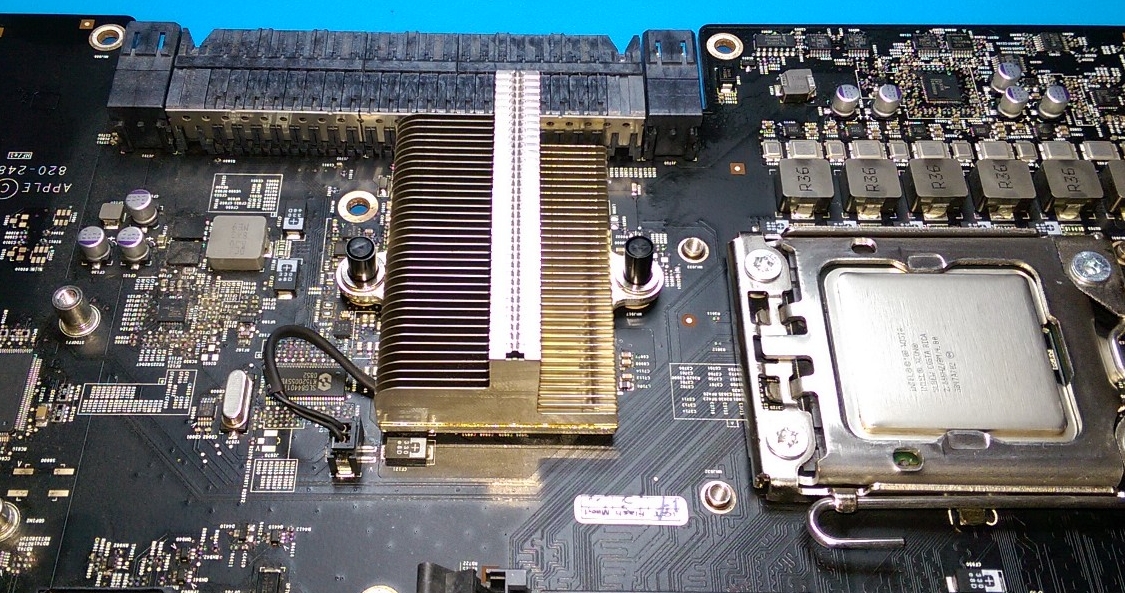

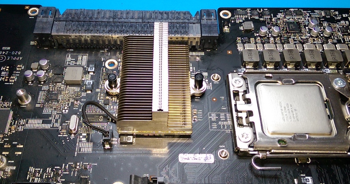

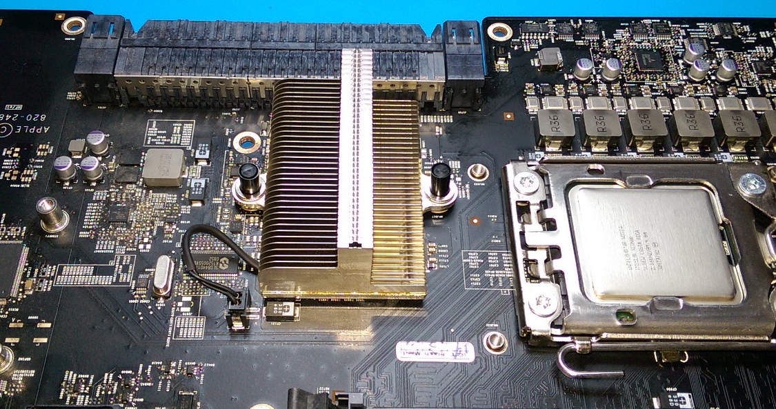

Found some clips, cleaned up the processor tray, reapplied thermal grease and the system is booting now!!
Amazing how this lack of a properly seated heatsink can result in no boot. Even though there is a temp sensor right on the heatsink, I would still think more time would be needed to detect a problem. The chip it is cooling must heat up fast.
