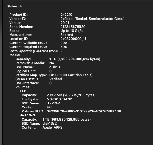

I can see that the drive requires 896ma but the Mac can provide 900ma, which seems a very slim margin. Are people running NVMe drives via USB 3.2 from their Mac Studio without issue?
So... it is a power problem? Or heat? Or a bad drive?

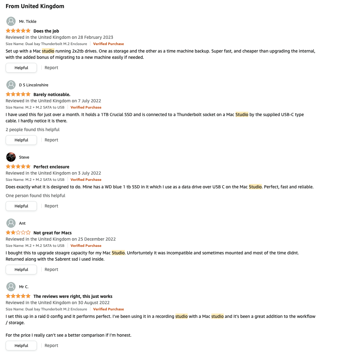

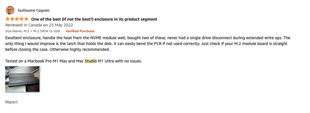

Edit: seems plenty of reviewers don't have that issue?
I've got a Samsung 990 nvme in an Acasis M.2 NVMe 40Gbps SSD Enclosure and it works perfectly, no issues whatsoever.

Out of interest, what does the current available/require show on your Thunderbolt enclosures?
Try a different brand USB cable for the interim, but ultimately it would be better with a Thunderbolt case. That specific Sabrent case you have I also got and it always ejected after computer sleep, while the rugged waterproof USB 3.2 case they make had been trouble free except for very rare disconnects. The Acasis TBU401 has been flawless and faster.
So this is a power issue? Does Thunderbolt require less power? What is the power draw for your Thunderbolt drives/enclosures?
