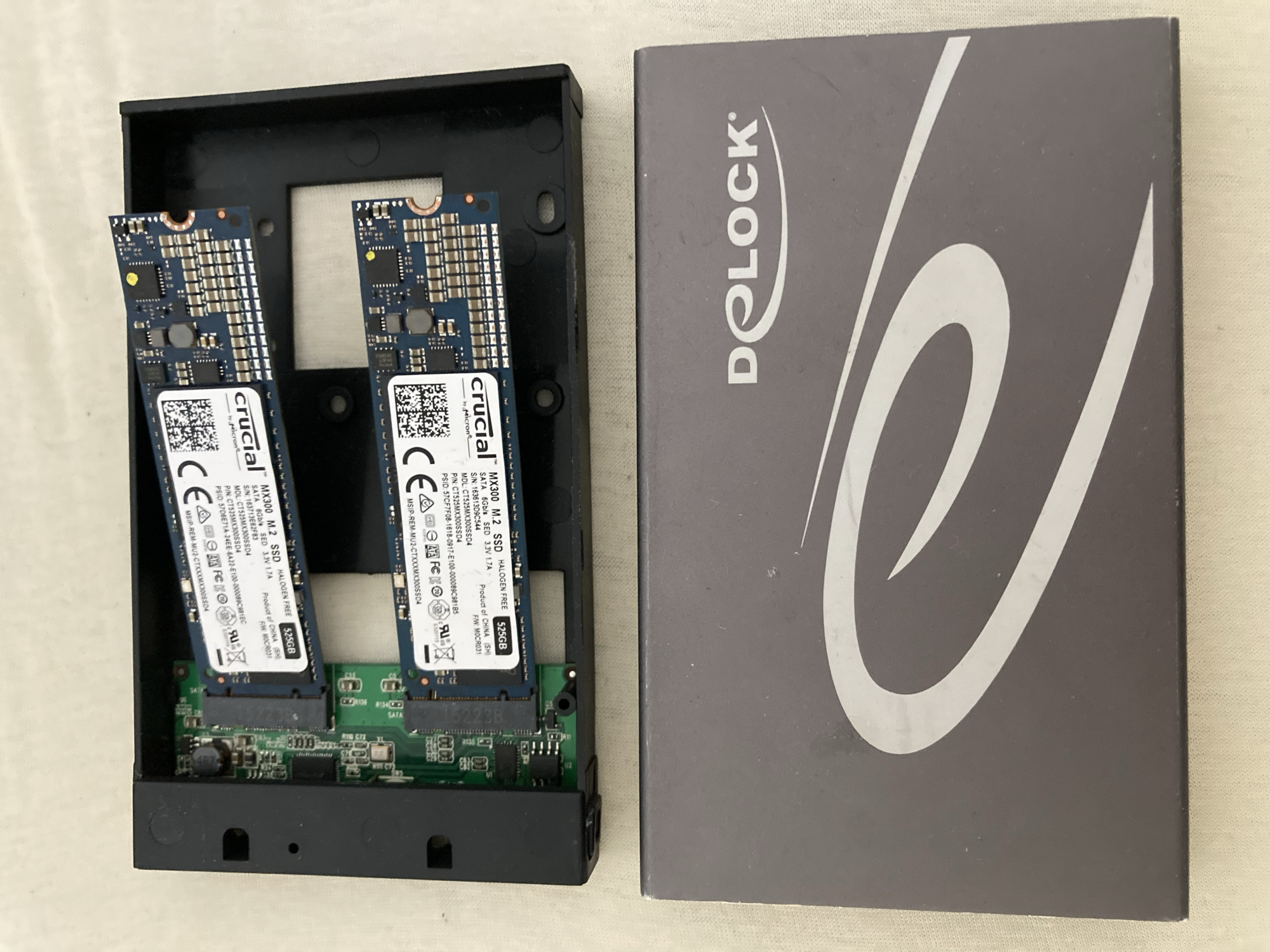

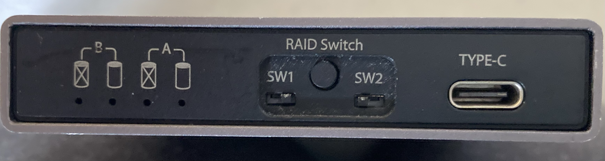

I found this RAID-enclosure that is doing good work for me since 7 years on any port. But there is no model name or number anywhere and it's also gone from my Amazon purchases list somehow. I will search somewhere else and put the link in here if I find it.
Good German quality, of course made in China. 🙃

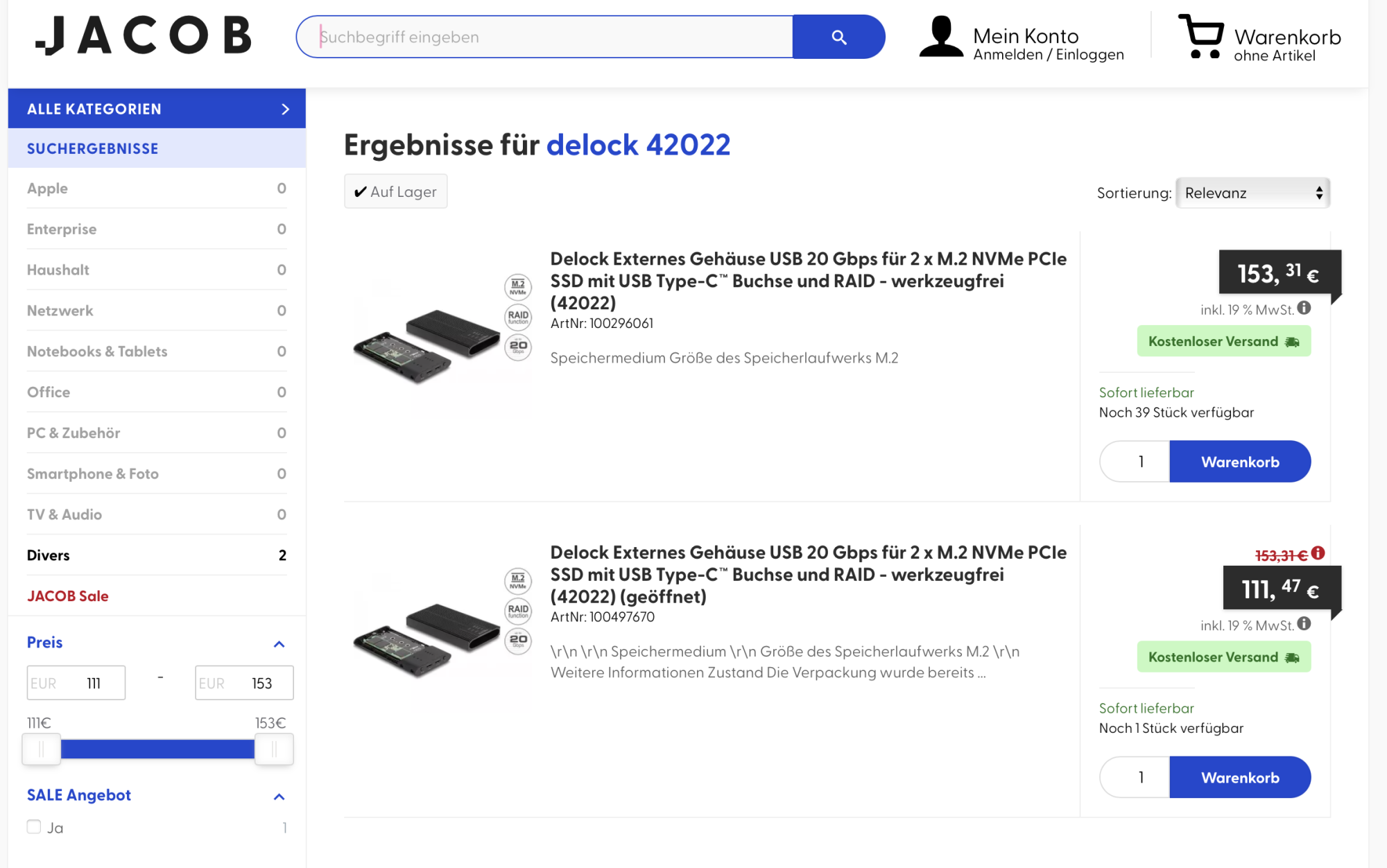

There is a new one with 20 Gbit/s now and some others:
One of those must be mine, only SATA but it's from 2016 originally:
MacOS isn't even mentioned only Linux and Windows, but for the newer ones it is.
Thunderbolt is also available, but this is only for one drive:
I wonder why they are not on Amazon anymore...
Many European countries are listed and even South Africa for shops to buy, but not UK.
Found some prices, not very cheap the cheaper one on the first pic is open box:

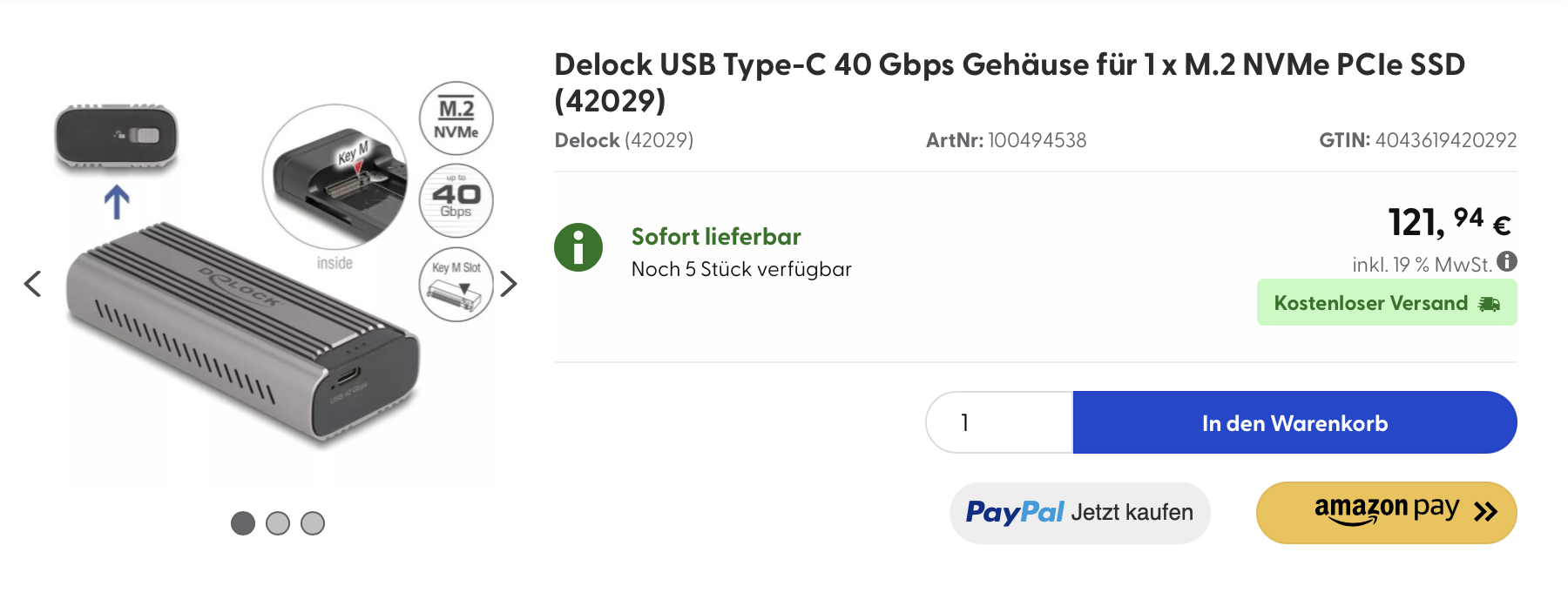

Same shop (they somehow have two) but cheaper: https://direkt.jacob.de/produkte/delock-usb-type-c-42029-artnr-100494538.html
