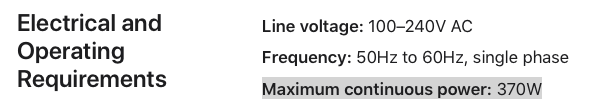

Apple states that the Mac Studio’s maximum continuous power (draw) is 370 W.
I assume this refers to a top specked M1 Ultra.
Does anyone know the continuous power requirements of an M1 Max 32c GPU with 64GB unified memory?
Thank you!
That 370 W figure is the capacity of the power supply, which is probably why Apple lists a 370 W max continuous power requirement for its electrical and operating requirements (perhaps it's a safety requirement that the former doesn't exceed the latter):
But the actual maximum wall-socket power consumption is well under that (it's probably good engineering to not have your continuous power consumption go right to the capacity of your power supply).

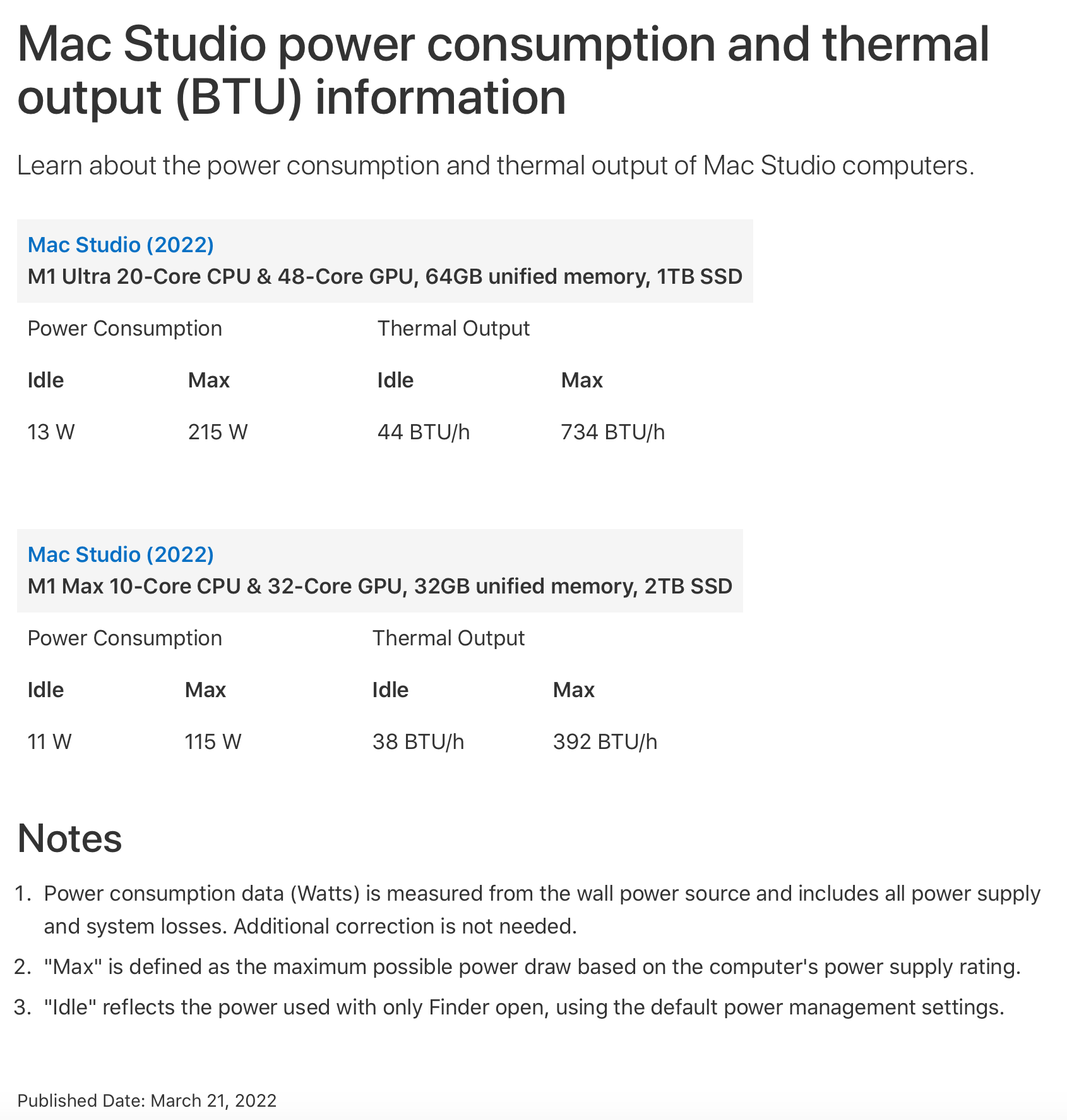

According to Apple, the max (wall socket) power consumption for the Mac Studio Ultra with a 48-core GPU is 215 W; for a Mac Studio Max (32-core GPU) it's 115 W (which is the question to which you wanted an answer). Based on this the extra 16 GPU cores on a 64-core GPU Ultra should add less than 40 - 50 W, so let's say ~260 W max for the 64-core GPU Ultra [Source: https://support.apple.com/en-us/HT213100]

Mac Studio (2022)
M1 Ultra 20-Core CPU & 48-Core GPU, 64 GB unified memory, 1 TB SSD
- 215W
Mac Studio (2022)
M1 Max 10-Core CPU & 32-Core GPU, 32 GB unified memory, 2 TB SSD
- 115W
I think the 370W is the PSU's max output assuming all I/O ports are charging/powering a device.
Without those I/O ports then it drops nearing 215W and 115W respectively.
Edit: Looking at Page 2 I see someone answered your question.
I was looking for the actual power consumption of a M1 Ultra as I was hoping that M2 Ultra would come to the MBP 16" with a 240W USB PD charger.
Someone did do a wall socket reading when the Mac Studio Ultra droped last year. He pushed both CPU and GPU to the max running Blender, without any bus powered peripherals, and only had like a single display; I believe his meter never exceeded 140W.
The PSU with 370W is never going to operate at 100% with no loss, it is typical to give like 30% headroom and then some.
