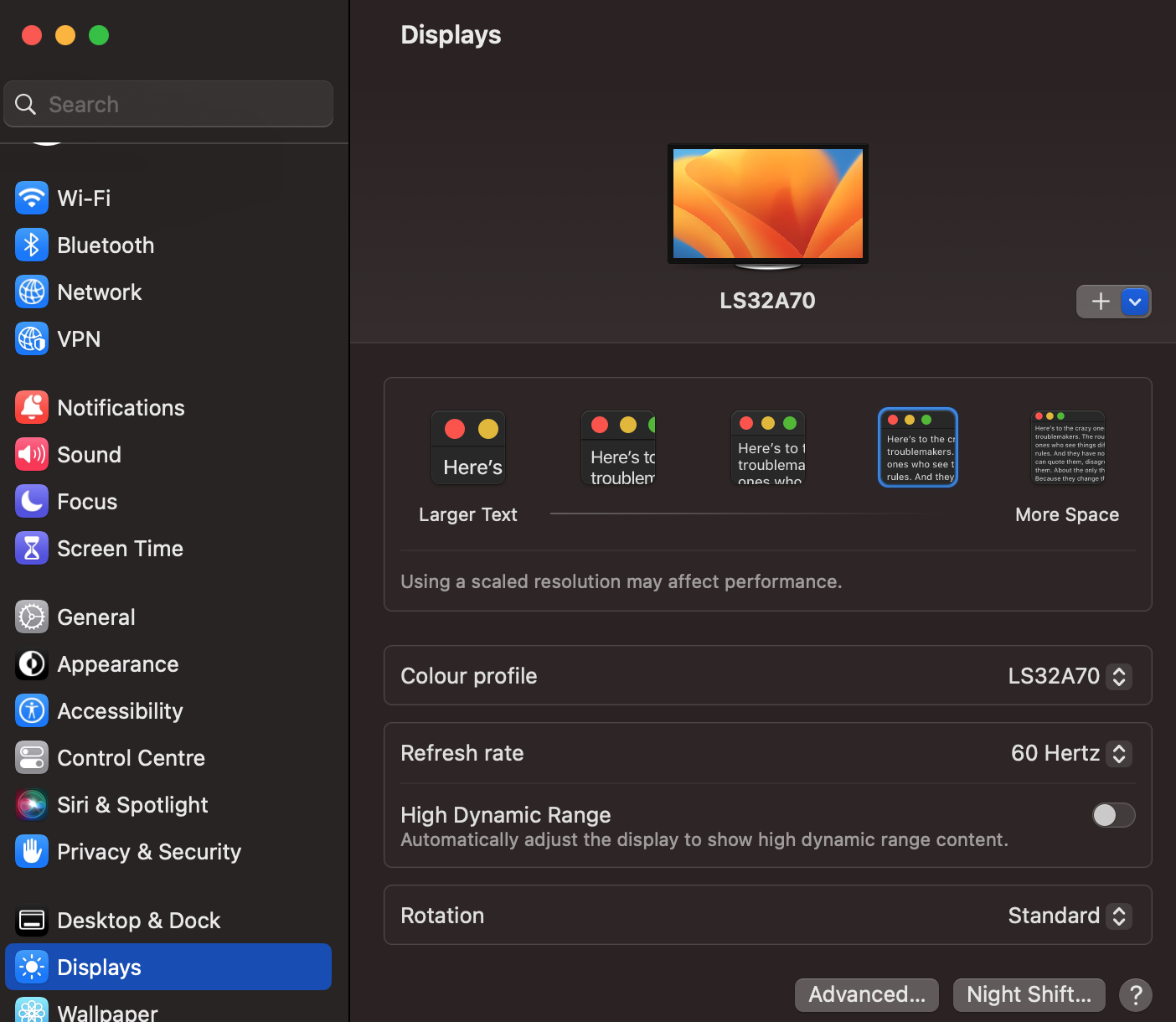

I have the screen flicker issue when using Mac Studio (base version) and Samsung Monitor 32" UHD (60 Hz). From my observation, the problem occurs if there is a change from dark to light (and vice versa). For example: in action movies, bright changes a lot. Here are my records
1.
2.
I share this monitor with my Mac Pro (core i9), but it doesn't have any issues. Definitely, the problem is not due to my monitor or HDMI cable.
I figured out that in the Displays setting, if I turn the High Dynamic Range option on, the problem solves (Screenshot is below). Unfortunately, I got another issue, HDR option makes my monitor dark than usual :oops:
Seem the root cause is due to either MacOS or Apple Silicon chip, seem some monitor makers do aware this, for example BenQ https://www.benq.com/en-us/knowledg...o-fix-mac-m1-m2-external-monitor-flicker.html
Update:
- Change color profile can solve too
