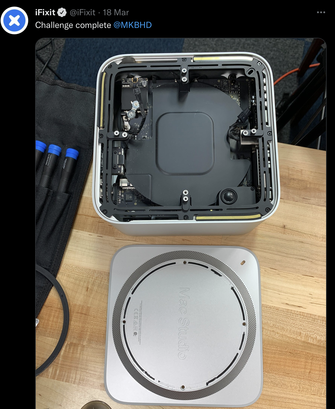

I’m sure iFixit is on it, LTT said they’ll do a video on it, but have to remember they got their units on Friday and it’s the weekend. I’m sure we’ll get more info next week.
IFixit posted on Friday that they’d started. But they then posted later that they would finish and post their results next week.

MaxTech is clearly not Apple sponsored. They almost never receive review units directly from Apple. For this teardown they ordered minutes after the keynote is finished, and received the "retail unit" as soon as any other customer doing the same thing. Not to mentioned review units must come with NDAs specifically prohibiting disassembly.
In this regard iFixit is more of less in the same position, but I reckon their teardown is more "professionally done" with clear top down photographs all laid on white backgrounds for their website guides. Then they need some time to identify and research the on-board chips if they are new. Some times they add x-rays and other measurement tools. Then in the case of the Studio maybe they are doing both the Max and Ultra versions for comparison as well. Therefore they need significantly more time to roll out a teardown.
