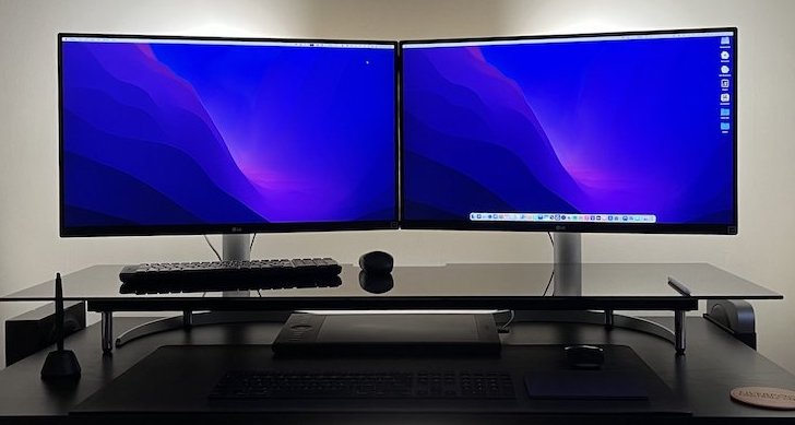

I have 2 LG 27UP850-W monitors connected to my Mac mini 2018 connected with TB>HDMI cables, run great. I, like you, needed a DisplayPort free for my PC on the left monitor and a HDMI on the right monitor for PS5. The monitors have USB-C as well. I am hoping to just swap out to the Studio if I decide to upgrade using same cables.
Nice clean setup! Yeah I saw this one, sadly it only support amd freesync not nvdia gysnc, also refresh rate is limited to 60.
