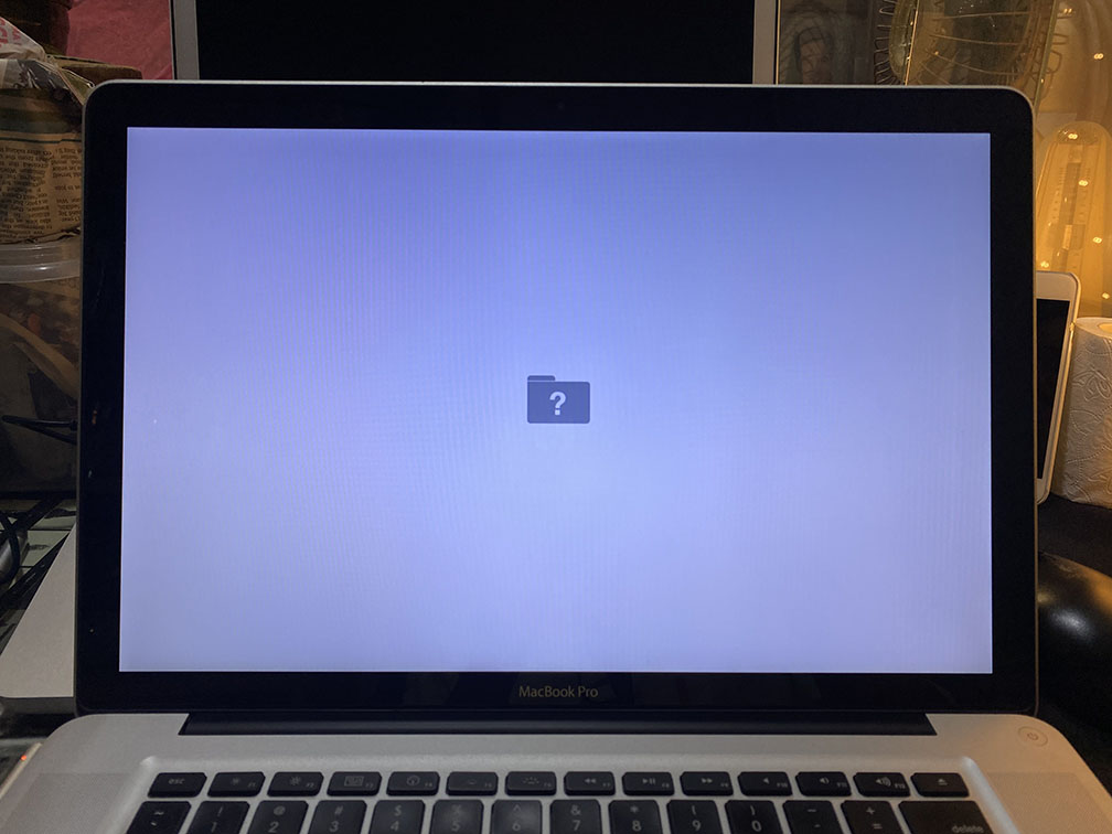

Hey guys, I have a radeongate Macbook 2011. I swapped out the SSD hard drive to another Macbook to install High Sierra on it then swapped it back into the the Macbook 2011. Then I tried starting it up again in single recovery mode wanting to try dosdude's solution:
But I keep getting the question mark folder. Have tried resetting SMC, PRAM, NVRAM, safe mode and all gets the question mark (some with a screwed up pixelated screen which I assume is because of radeongate). I have also opened up the Macbook to check that the cable is connected properly to the SSD drive and it looks ok.
Any clue what's going on?
Could be a faulty SATA cable nonetheless. Can you boot from another internal HDD/SSD, or that same SSD in an external enclosure?
Yes, I could boot the SSD when I put it in another Macbook. So it might like what you and ShortTimer says, could be a faulty SATA cable.

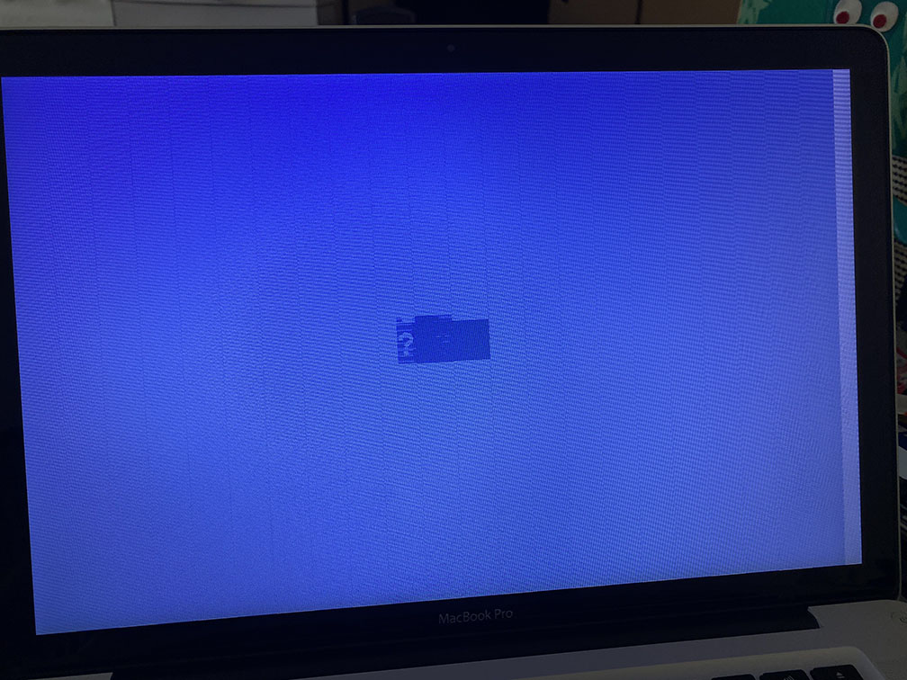

Gahhh... Ok, so I got a replacement drive cable, installed it and started the Macbook up and I still get the blinking Question Mark folder. And the screen now looks 'distressed'? I assume it's because of the radengongate GPU?
So if it's not the drive cable what else could the problem be?
