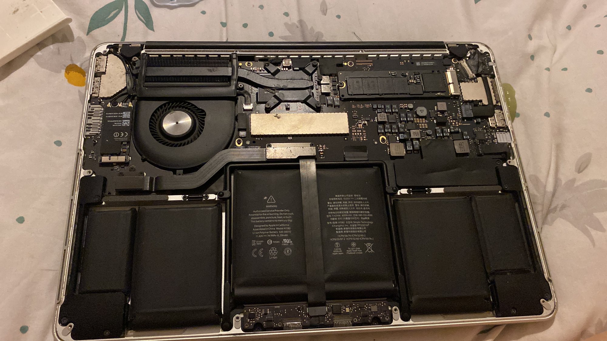

Hi, please remove this if it’s posted in the wrong place/not allowed, just looking for some clarity on wtf is going on with my Mac.
Long story short, I thought my charging cable had broken as it was no longer charging my Mac but maintaining the battery, bought a new one (70W) new one is also not working. My mac will now only turn on when plugged in and power off instantly if the cable is disconnected, maintaining only 1%.
Opened up the back to check out how the battery was looking and didn’t seem to me (tech noob) that anything looked swollen or broken. (Attached photo)
Ran a diagnostics test which concluded the ‘battery may not be charging correctly’ could this mean it’s an issue with the charging port?
Am I being dumb, is the battery actually done in and needing replaced? I’d love to be able to save myself a trip to the repair shop if anyone can help me out with the best course of action.
Thanks!

You can try resetting the SMC power management system.
If that doesn't work then most likely your battery needs to be replaced.

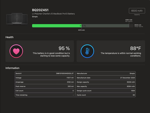

It says my battery condition is 'good'. But it's not, the laptop consistently goes from 20% to 7% every time it's used now. Was there a 'very good/excellent' before the 'good', I can't remember, but charge and design capacity drops and drops, but it still says the battery is 'good'? So now wondering how much use that app is to me anymore?

Sensei shows the status of my battery in this manner shown above. To me it sounds like your battery is gone which is why you have to keep the laptop plugged in. To confirm you should have an app that monitors your battery. Replacing the battery is not too difficult and the iFixit web site sells replacement batteries as well as have detailed fixit guides to reference.

Getting back to Coconut when I put the battery in few months back it always said it was good, and when I posted this 12 days ago, said 'good', but now, after months of it behaving strangely, it now says 'check battery', so I don't think it's accurate at all.
Coconut went from 'good' to 'check battery'. Is there no inbetween? Battery OEM 8 months old.
Mac readings says 'Service Battery'.
The descriptive term (good, normal, failing, etc.) is not worth much.
What about the reported values for Cycle Count, and Full Charge Capacity?
You may also see a battery health percentage. Less than 80% is usually an indication that the battery is ready to be replaced.
I also agree with ApolloBoy in post #7--some of the cells in the battery are visibly swelling...
Yeahhh I'd get that battery replaced because the swelling will only get worse and it can damage your machine if you leave it in there long enough...

You are offering the information about the descriptive term that you found. I am simply saying that is not enough, without also showing the reported numbers that are also available, which show more detail about the health of the battery.

The most helpful relevant part of your screenpost is Design Capacity, showing the present number of 74.8%
Again, less than 80% is a baseline number that is often considered to be an exhausted battery, ready for replacement.
