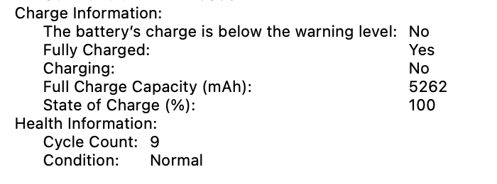

After the replacement system report looks like this
It does not look bad, but battery is maybe like 2-3hrs tops with mostly web browsing, movies.

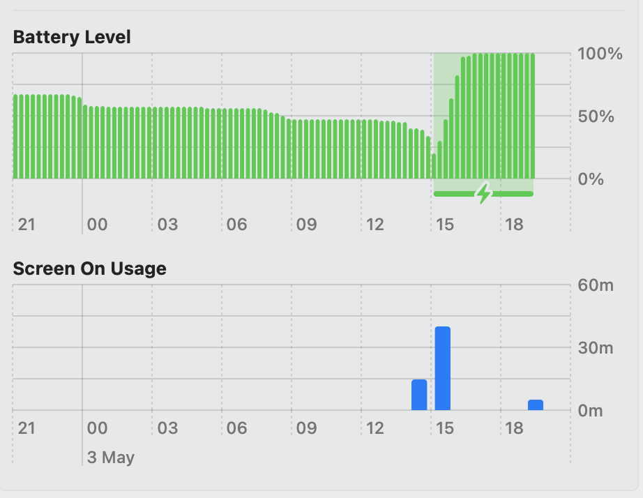

Even when lid is closed, it is still draining battery much faster than I would expect. I have turned off power nap but batteru consumption looks like this:
Between last night and 2:45pm I was not using it, but it was constantly dropping as above. When i browsed for 45mins straight, I had drops like 39->34->27->18 in matter of minutes around 3pm.

- what is happening here? It was just web browsing - no streaming services and others.
- I am considering yet another battery replacement, but maybe the first 80% one was not that bad, and problem lies elsewhere?

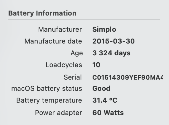

I am in the middle of callibrating the model, but one thing caught my attention.
I have used coconutBattery for testing, and here what is says about the battery itself
Either it stores some default jibberish, or I received some 9 years old battery....
