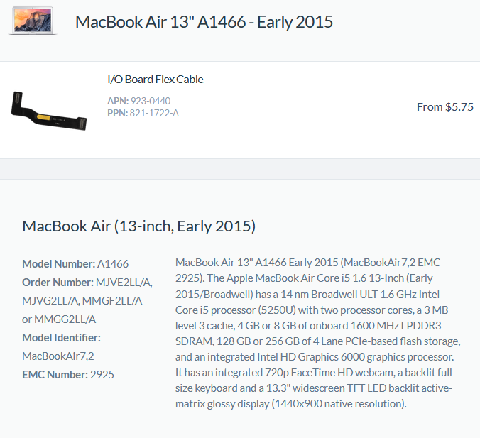

I/O Board Flex Cable
- At this moment, I can only think of replacing the I/O board flex cable that connect the I/O board to the logic board (see attached for a pic of that cable).
