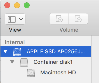

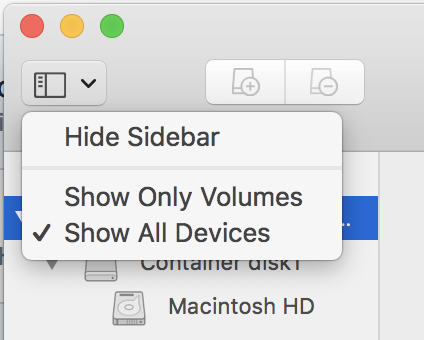

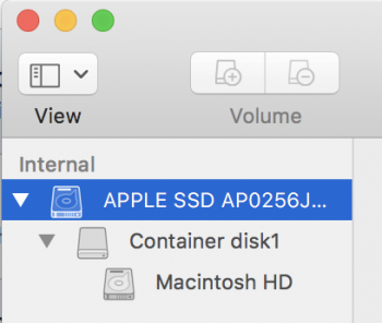

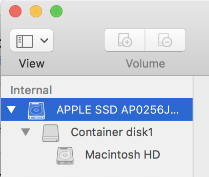

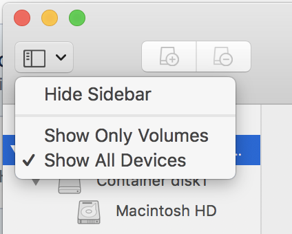

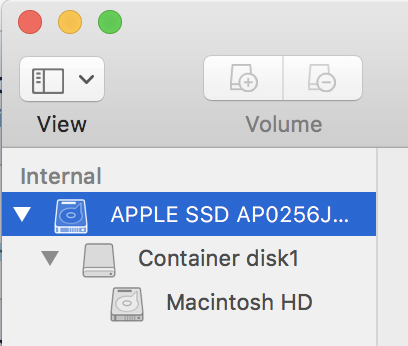

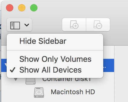

That is okay... the Internet recovery screen looks the same as regular recovery. Open Disk Util and click the dropdown at the top left and check Show All Devices like in my screenshot. Then select Apple SSD like I did and erase like I explained.

It's been erased. I want to reinstall now to see whether I'll be saved from a this stress.
