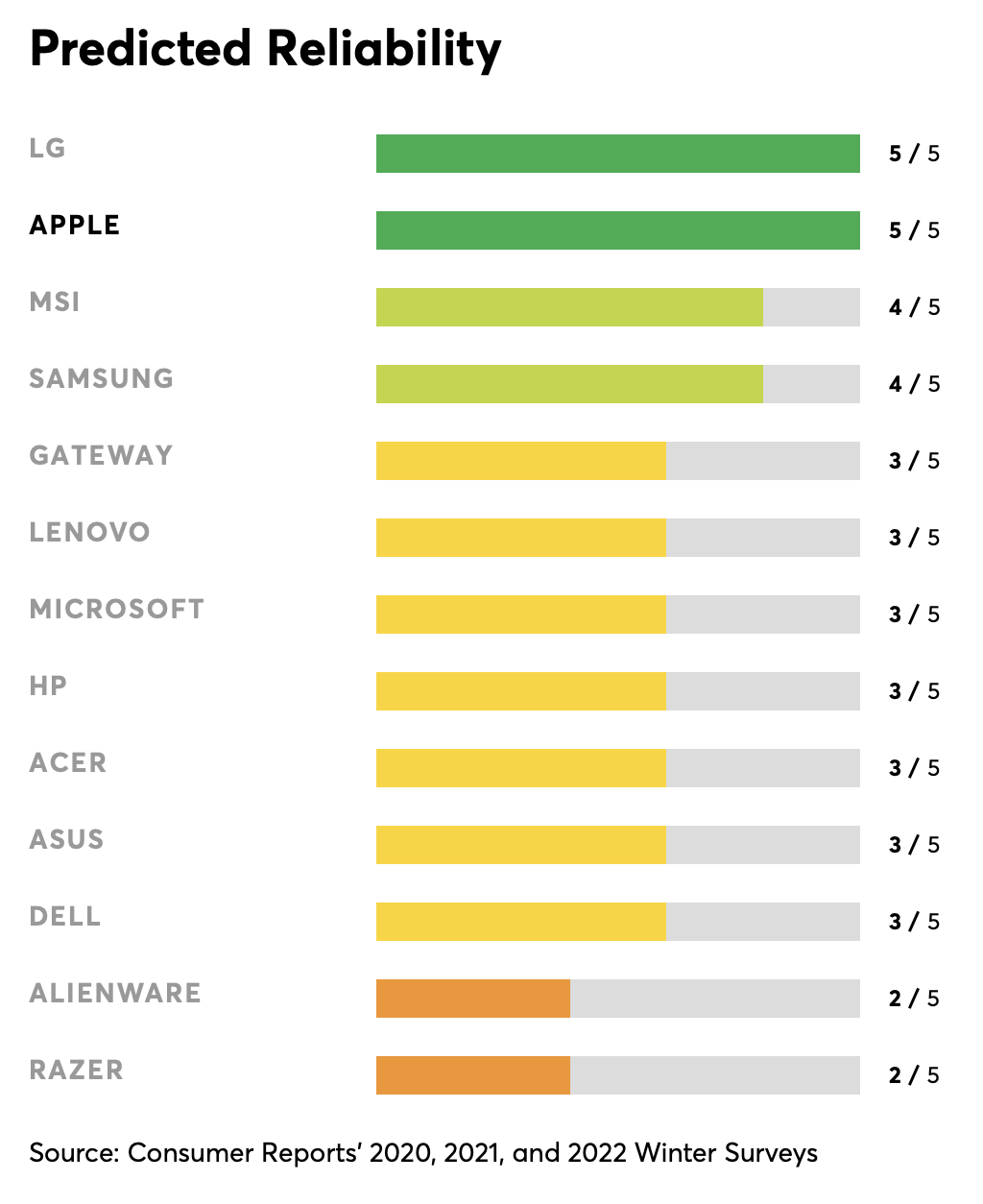

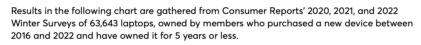

theorist9
macrumors 68040
May 28, 2015
3,880
3,060
2 years is very premature failure...
Yes, it should absolutely last longer than that.
...compared to other laptop brands that last 12 years or longer.
Compared to what brands? Here are the results of Consumer Reports' survey of laptop brand reliabilities:
From your signature line:
Yes, and you should really stop contributing to that.
