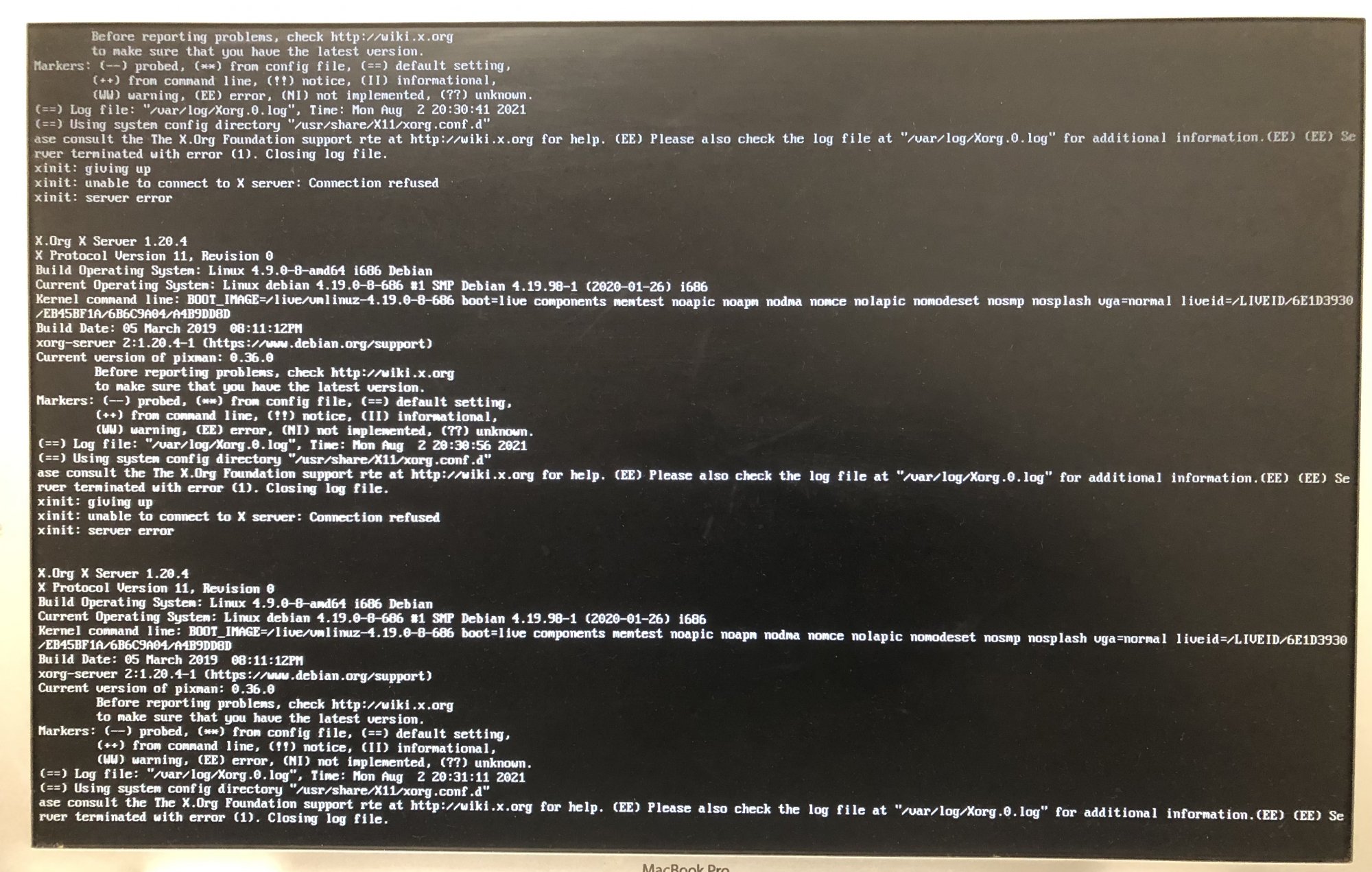

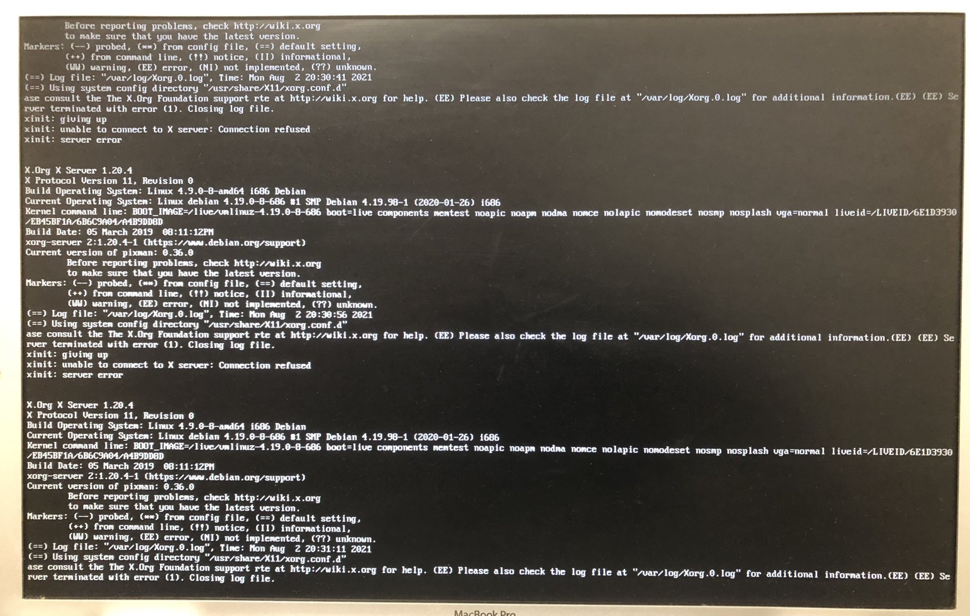

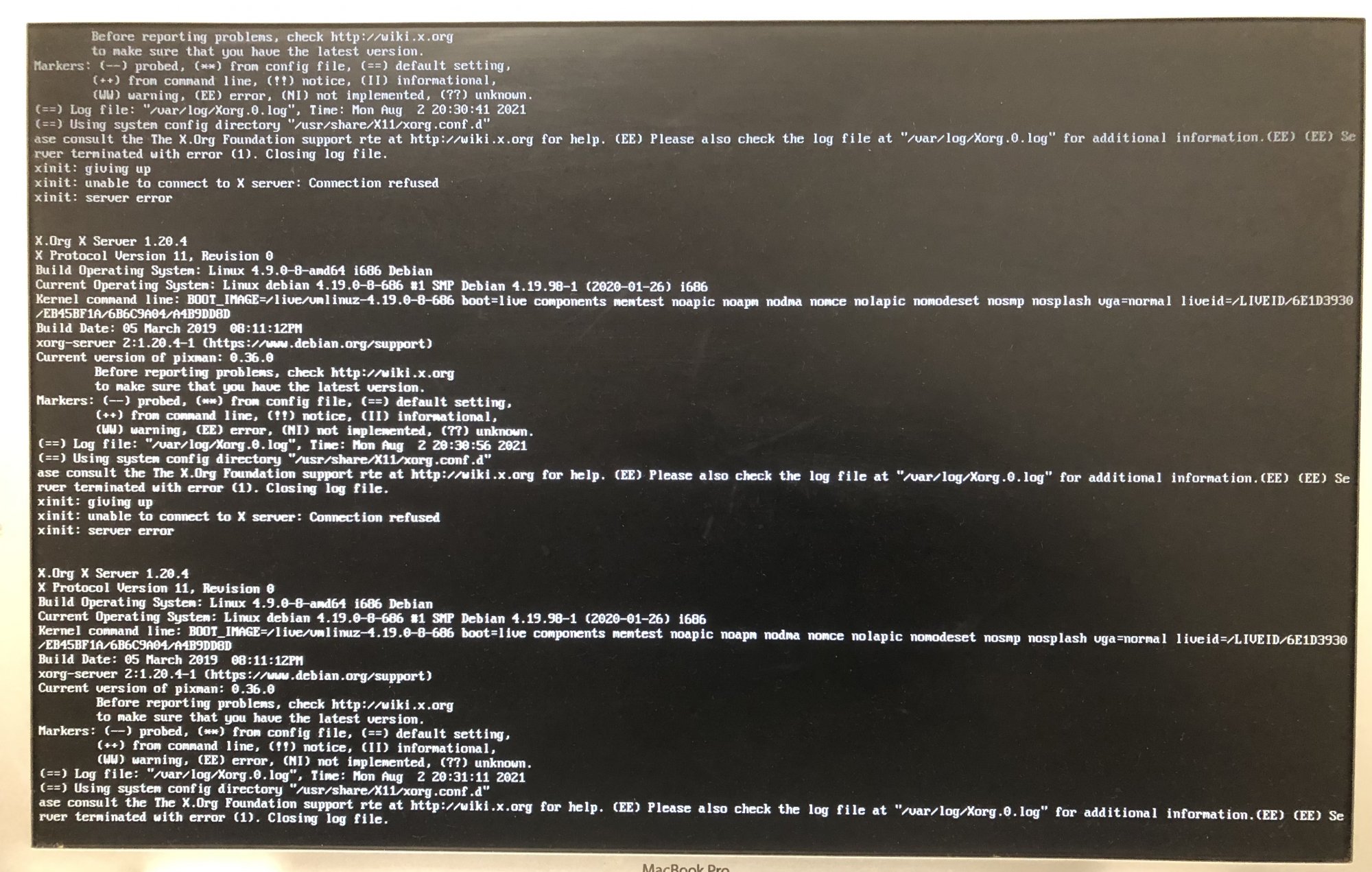

Screens look promising, but it doesn't work 🙁 I need to use "safe mode" because of Radeon X1600, and what I get is shown on the screenshot attached.
