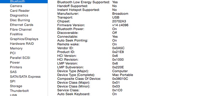

If your "lmp version" is "0x4" you need a new card.
If your "lmp version" is "0x6" you just need the kext mod.
(last thing on screen shot)

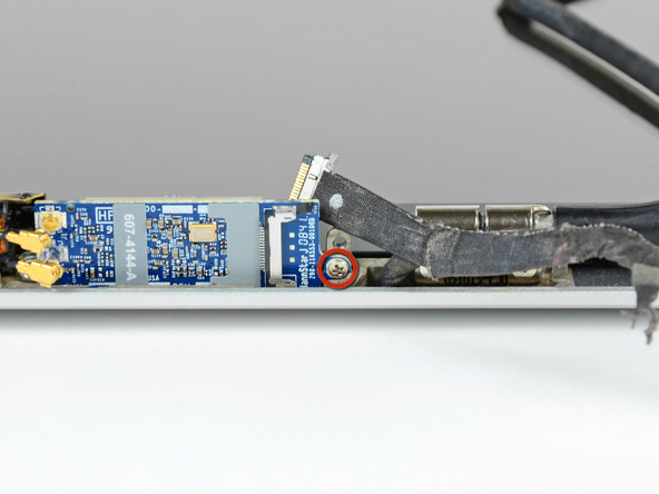

Thanks! Can I buy everything from you? I was visiting iFixit and it looks as though, along with the BT card, I can buy a new bracket for fairly cheap which may or may not fit.
yeah I saw someone bought the bracket too but i'm not sure if it will fit into the 2010mbp, I have just bought the BT4.0 unit and the additional bluetooth antenna cable and crossing my fingers somehow they will fit.

using a BT 4 USB dongle with my MPB 13" 2010, my lmp version is 0x6. Does that mean that using your kexts I'd get handoff support?
Sorry, but are you saying the dongle you're using gave you the LMP 0x6 version? Did you need to do some sort of OS modifying for OS X to be directed to your dongle as the default bluetooth card, or did this happen automatically? Your screen shot indicates OS X is only showing, thus using, one bluetooth card, right?
Which dongle (brand/model) is it?
But most importantly, have you tried modifying the kext and successfully got continuity to work using the dongle?

Yes, that happened automatically using the dongle. It's the IOGEAR GBU521.
Like i said before, I can't take the slightest risk that something would go wrong with my mac, so I haven't tried anything.

Is this upgradeable? I see on iFixit that the connector looks vastly different - a push in clip rather than a push-on ZIF connector.

Although the USB BLE dongle solves the Continuity issue on my mid-2010 MBP 15", I just did the BCM94331PCIEBT4CAX upgrade (to save a USB port). Took only 45 minutes, works perfect as well.

Well, ordered the Correct wireless card as stated above, but was unable to install this on a 13" 2010 macbook pro, as the card originally in it is smaller, and the connector is different from the new one, the old card's connector slides in and clicks, while the new cards connect is a on top push to click connector. did I order the wrong card or am i SOL?
