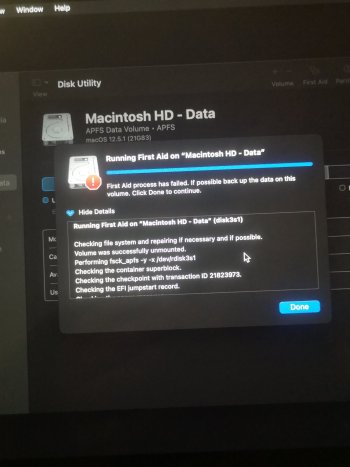

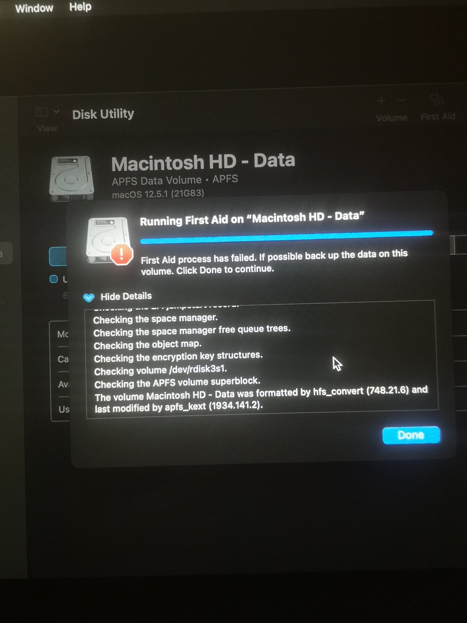

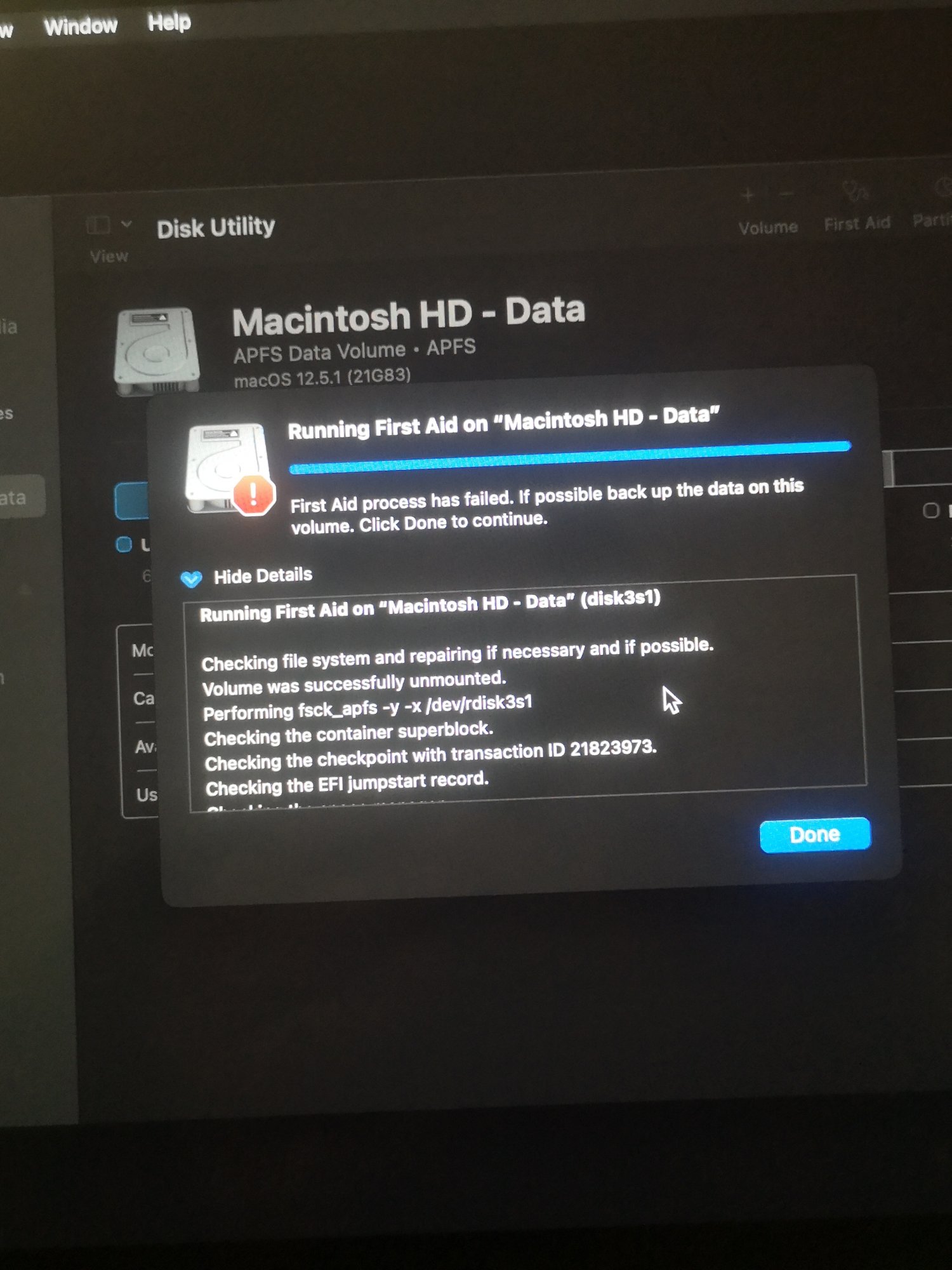

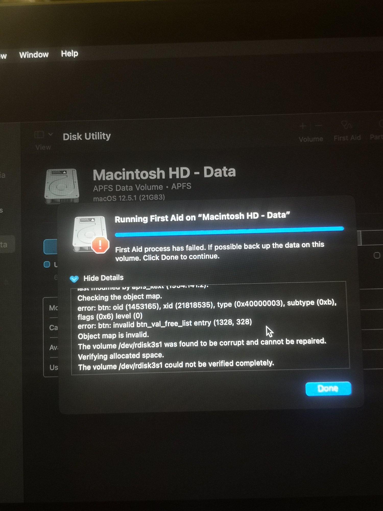

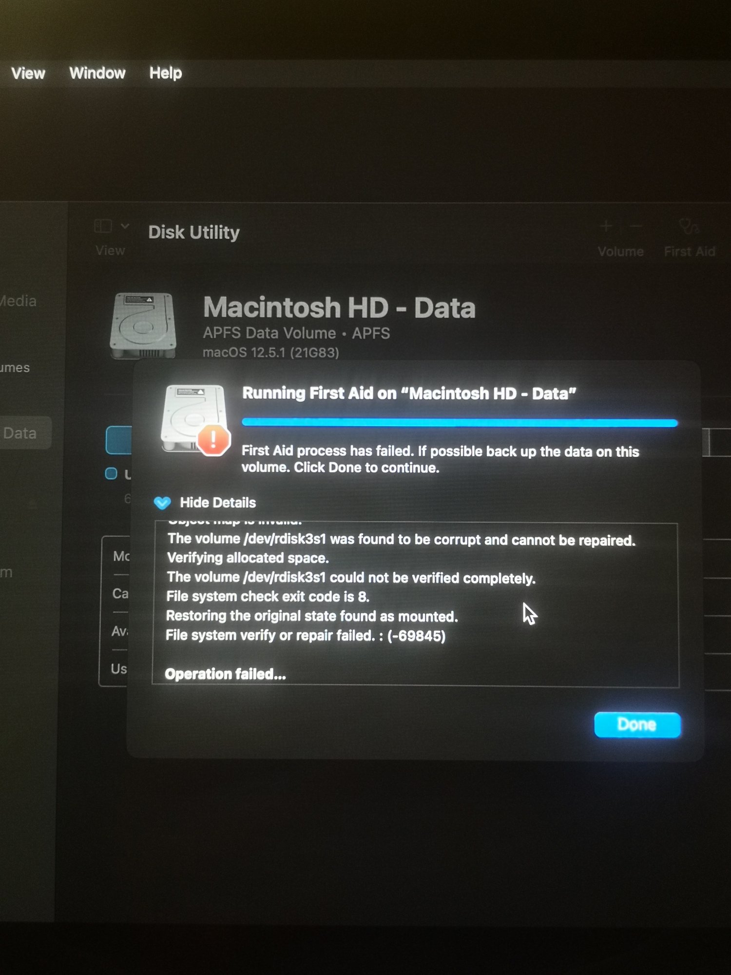

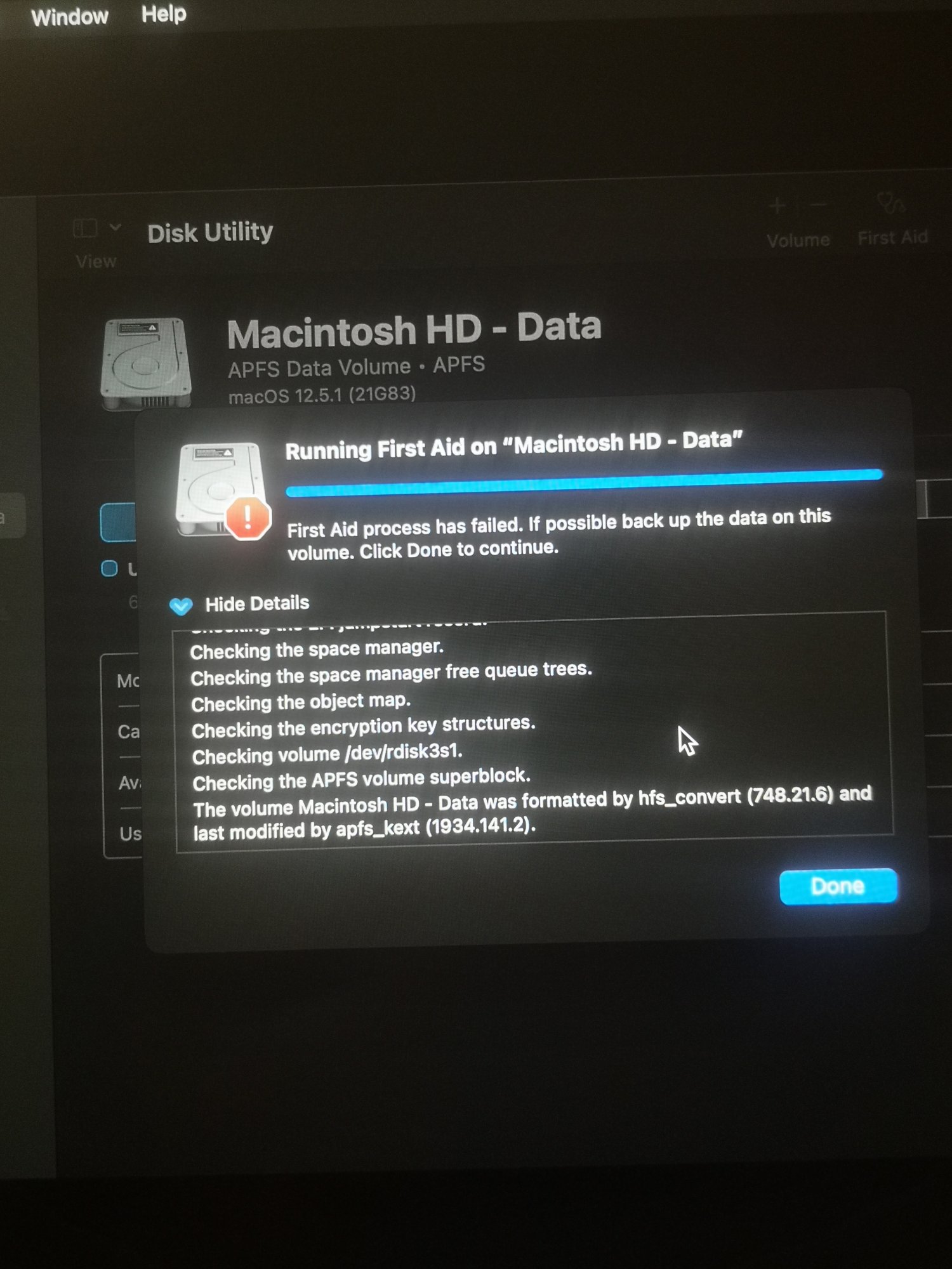

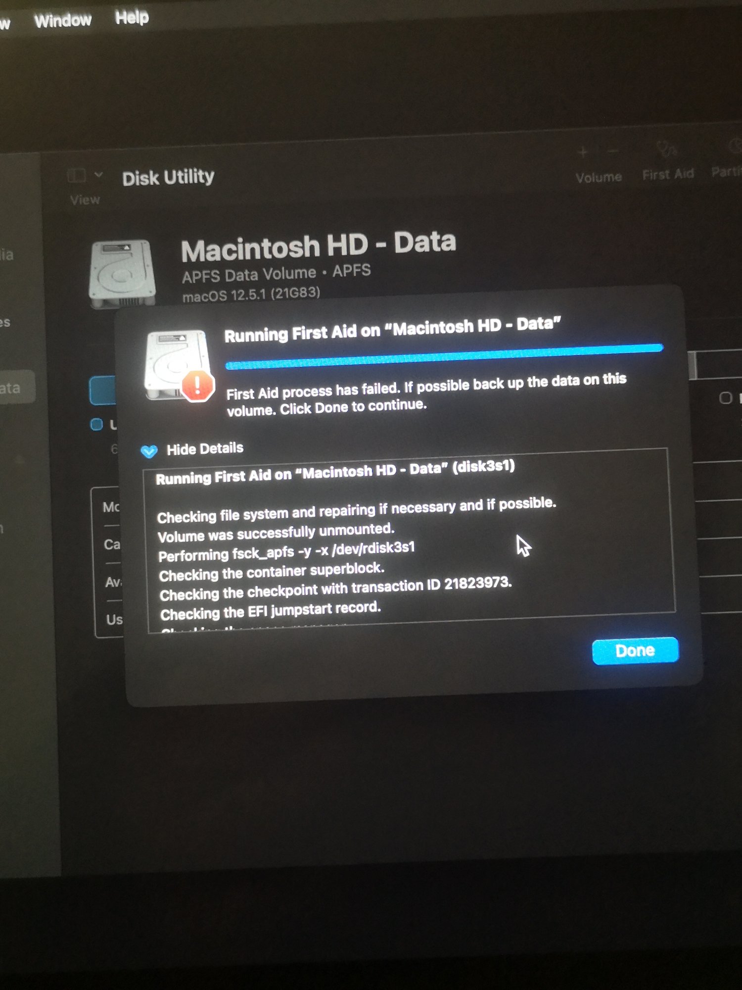

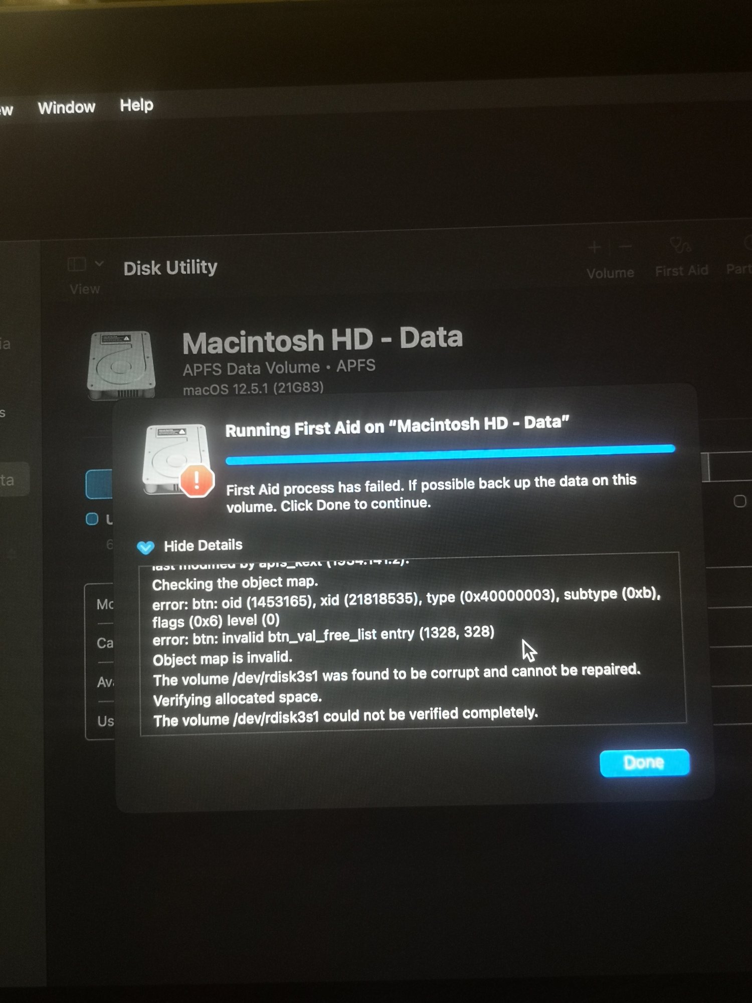

my mac has been crashing everytime I start it up (about two minutes after logging on) I had an error pop up that said hash mismatch so I came to disk utility and it gave me the error that is in the images that I'll attach
tried to clean install and at 2 minutes left it gives me an error, and the same happens when I try a software update

Well if you have everything you need from the drive backed up, do a google search on how to make a bootable USB installer and then boot from that; format the drive, then try a clean install from the USB drive.
Worst case is you need a new hard drive, which in the 2015 should not be too hard to replace, search on iFixit for instructions.
