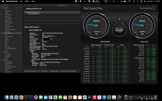

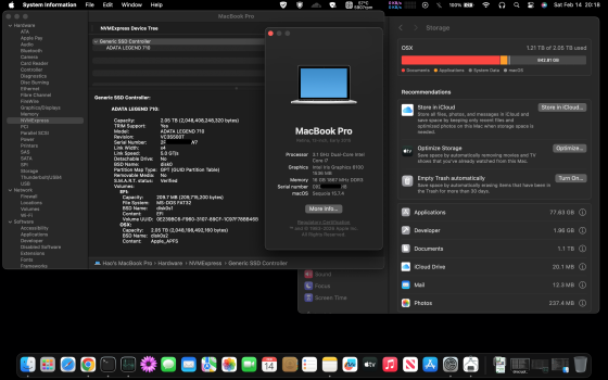

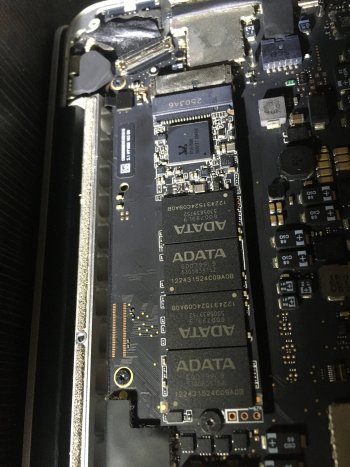

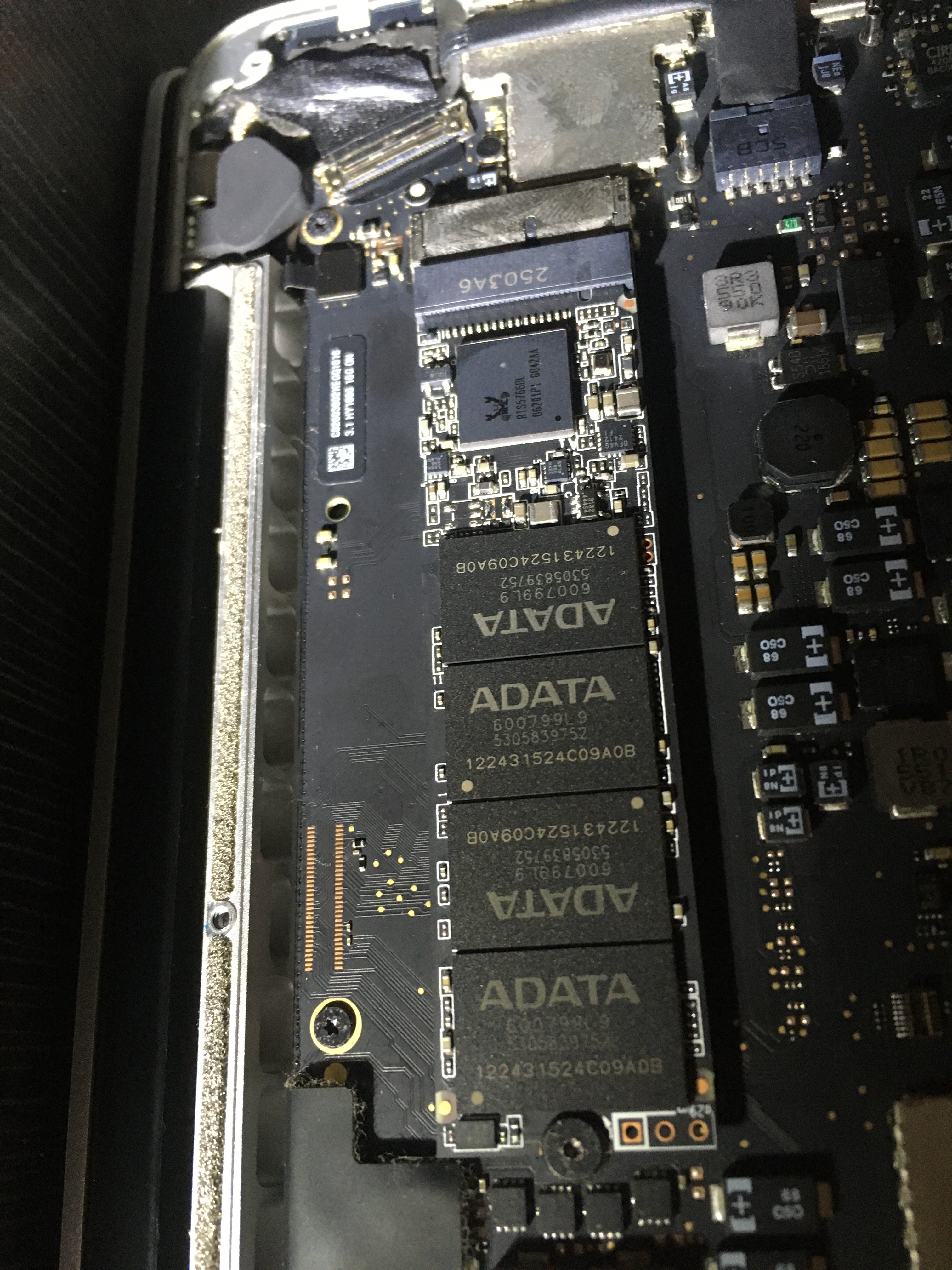

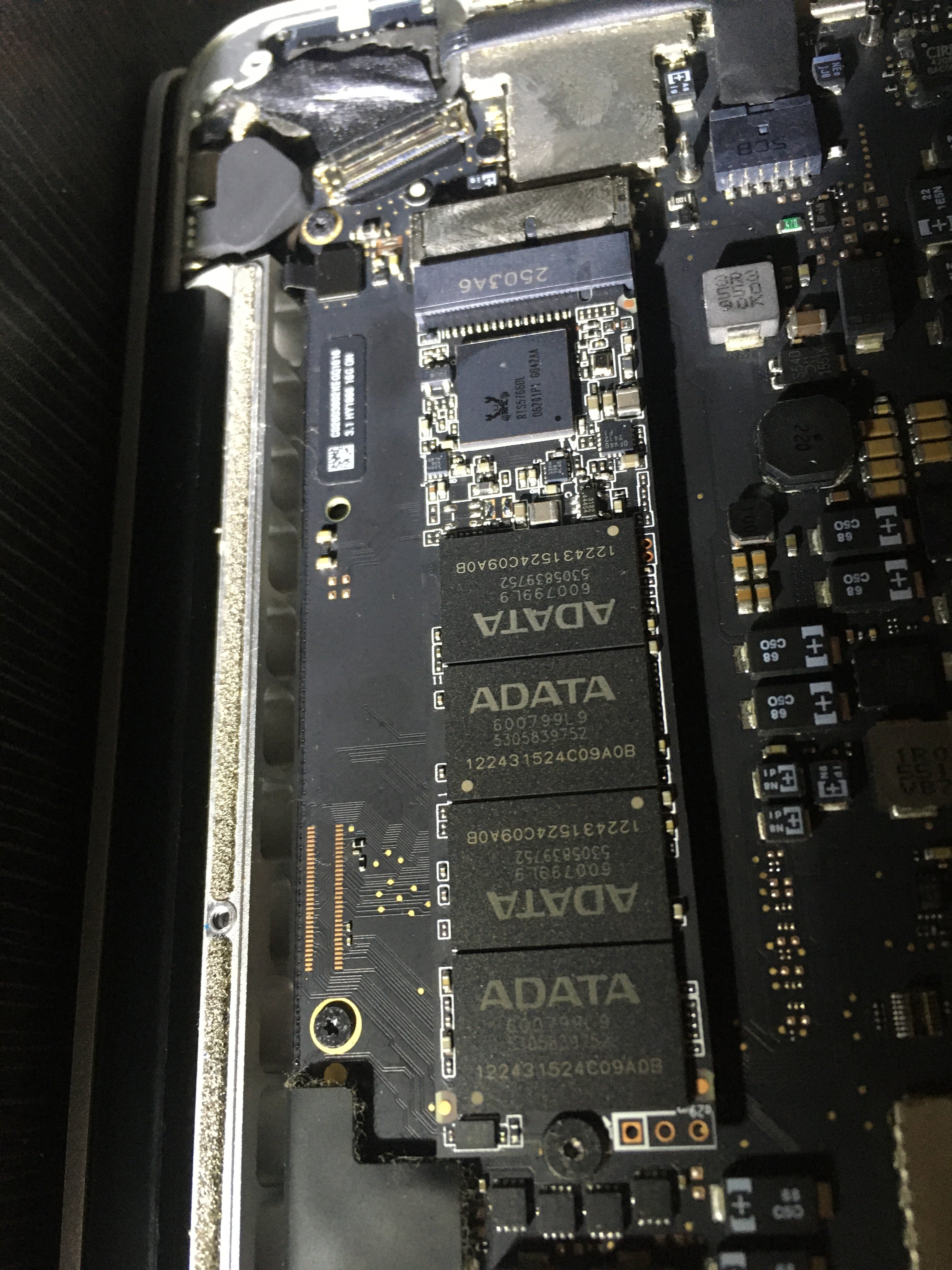

Hello, I'm Brazilian and I'm also trying to upgrade my MacBook. I'm considering installing an ADATA Legend 710 SSD. It's a Gen 3 SSD. Do you think it's compatible with a MacBook Pro Retina 2015?
I've tested and it's work with BootRom 489.0.0.0.0. the Adata legend 710 working well on my Mac A1502 model.
