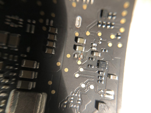

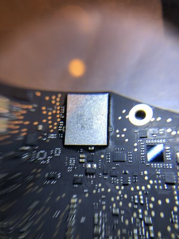

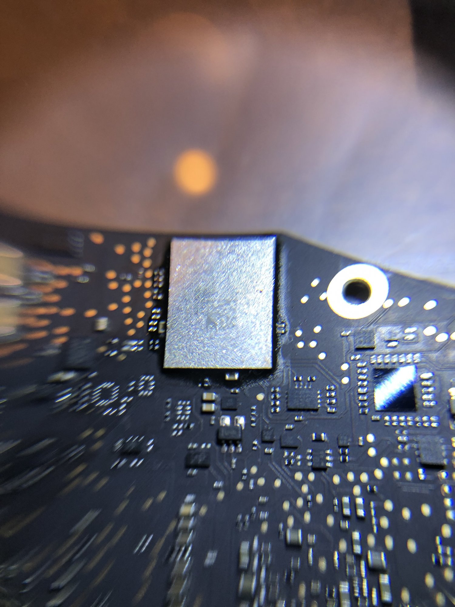

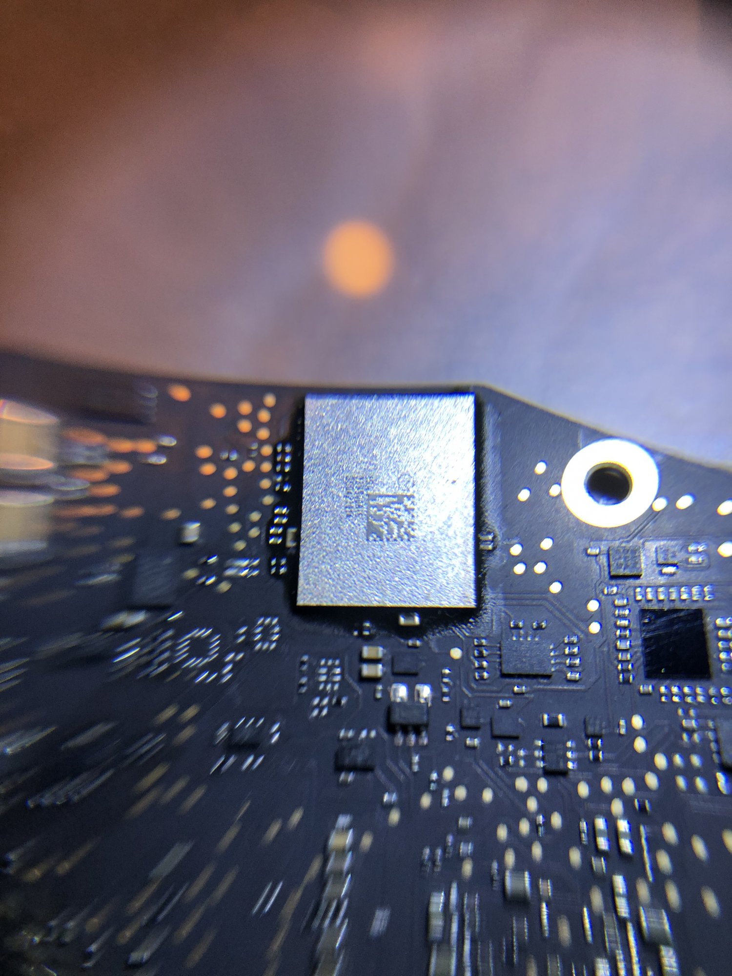

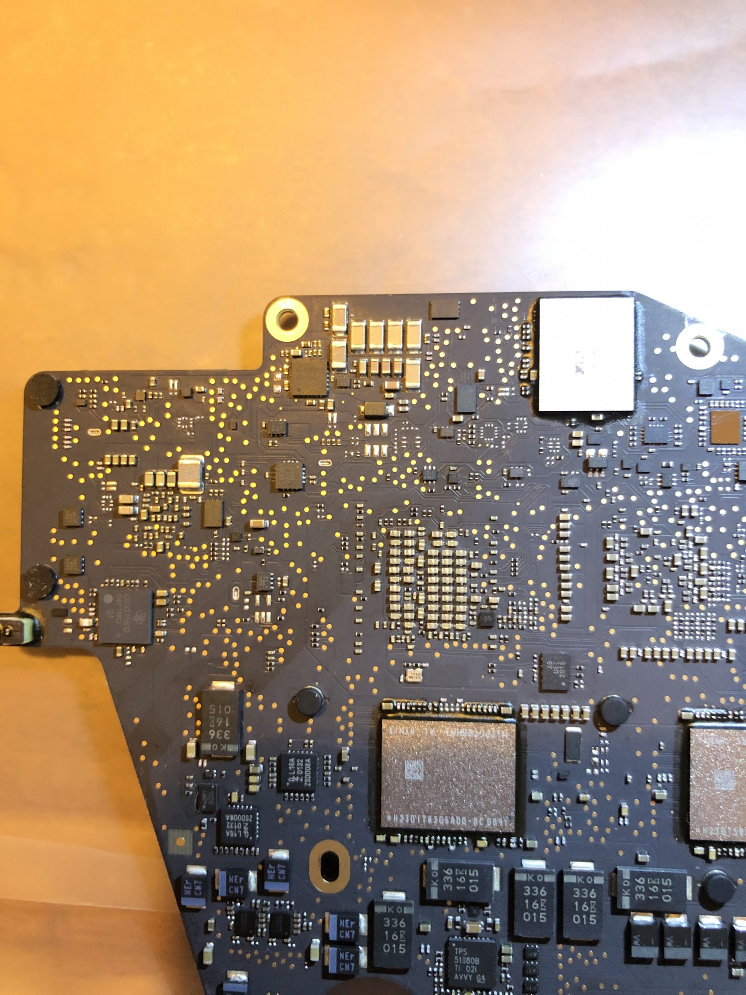

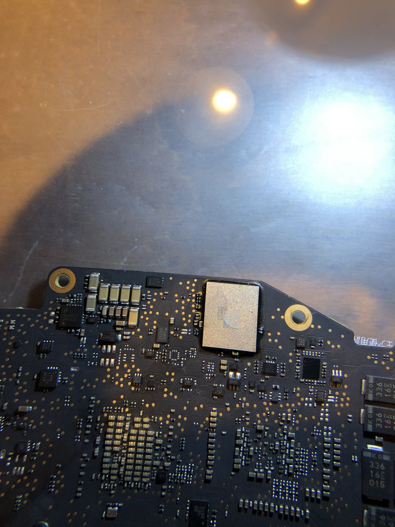

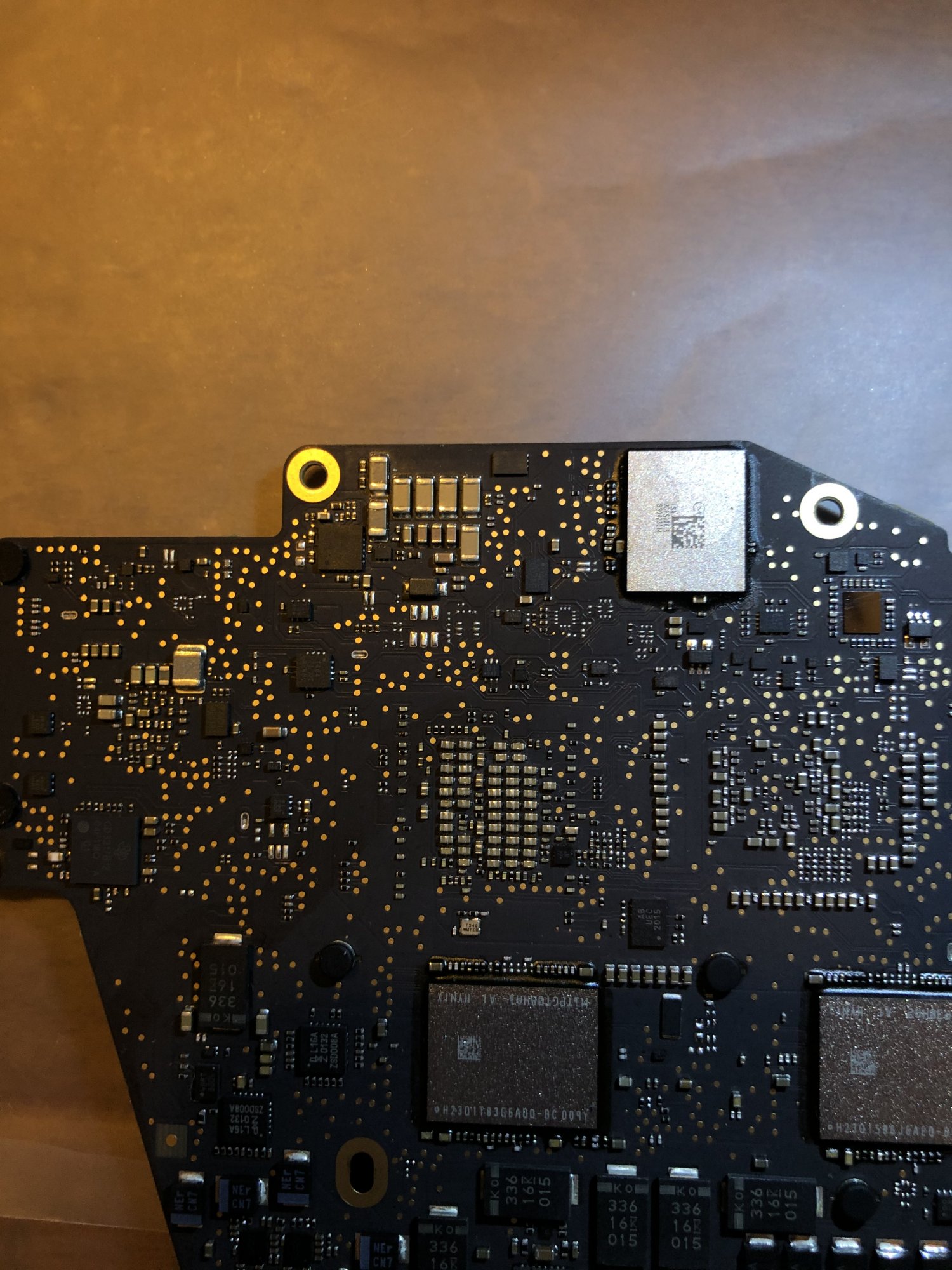

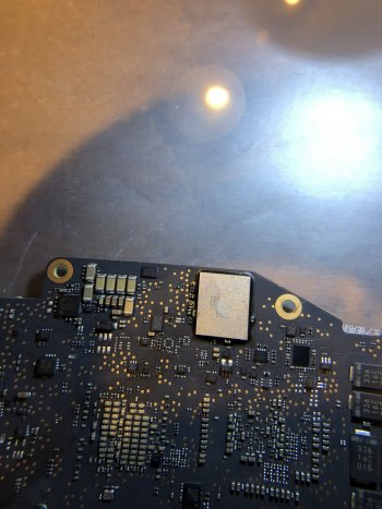

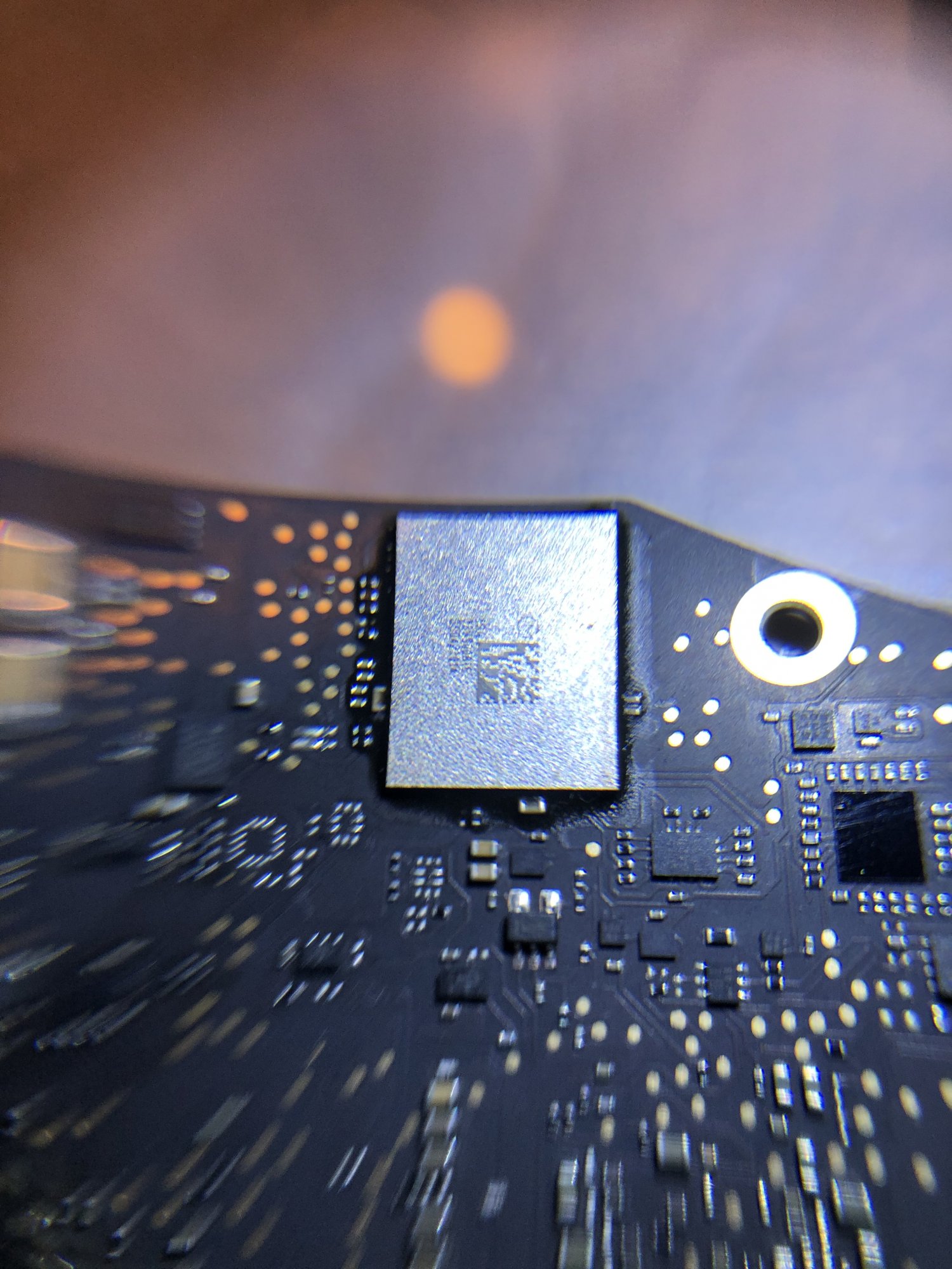

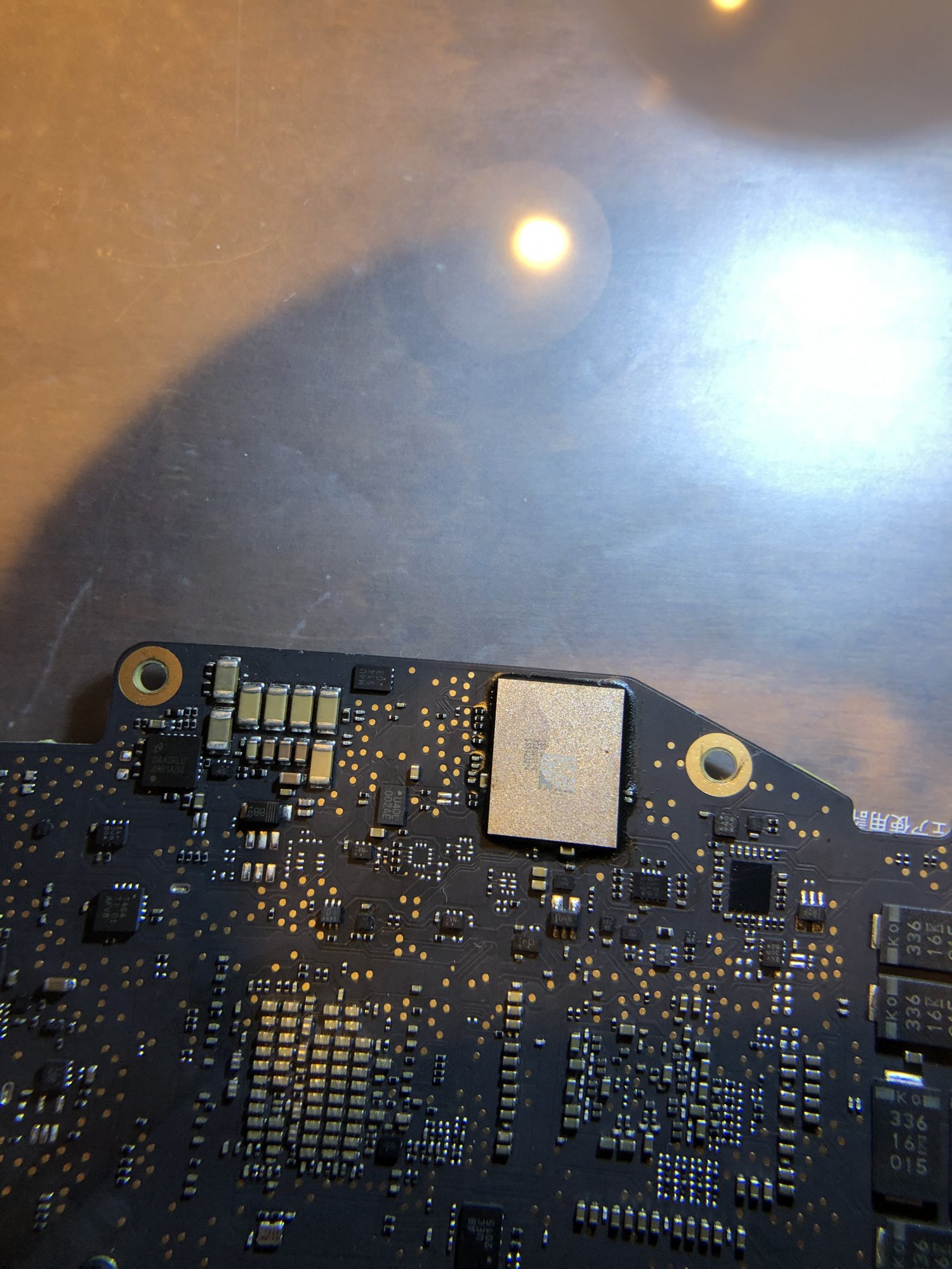

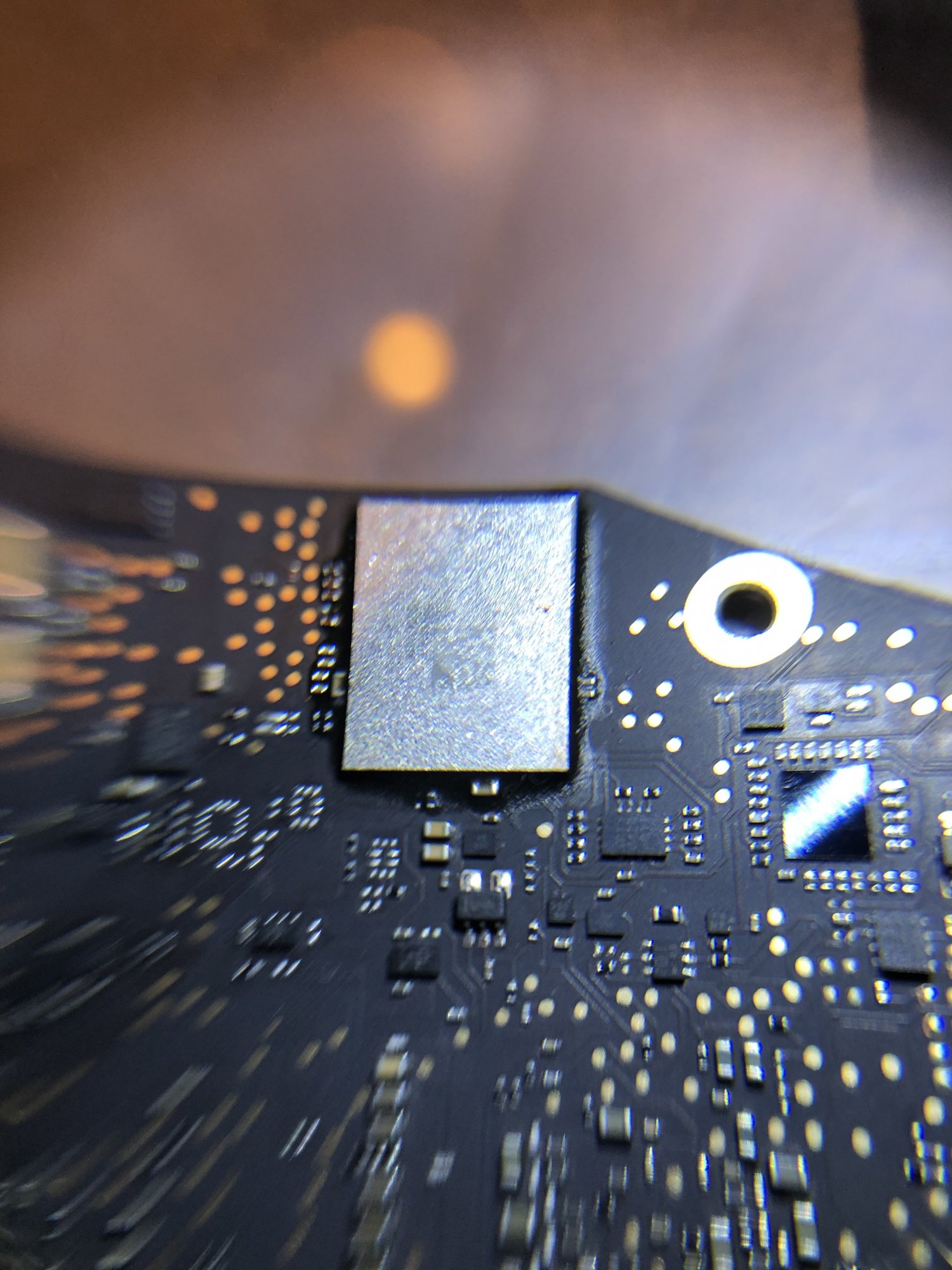

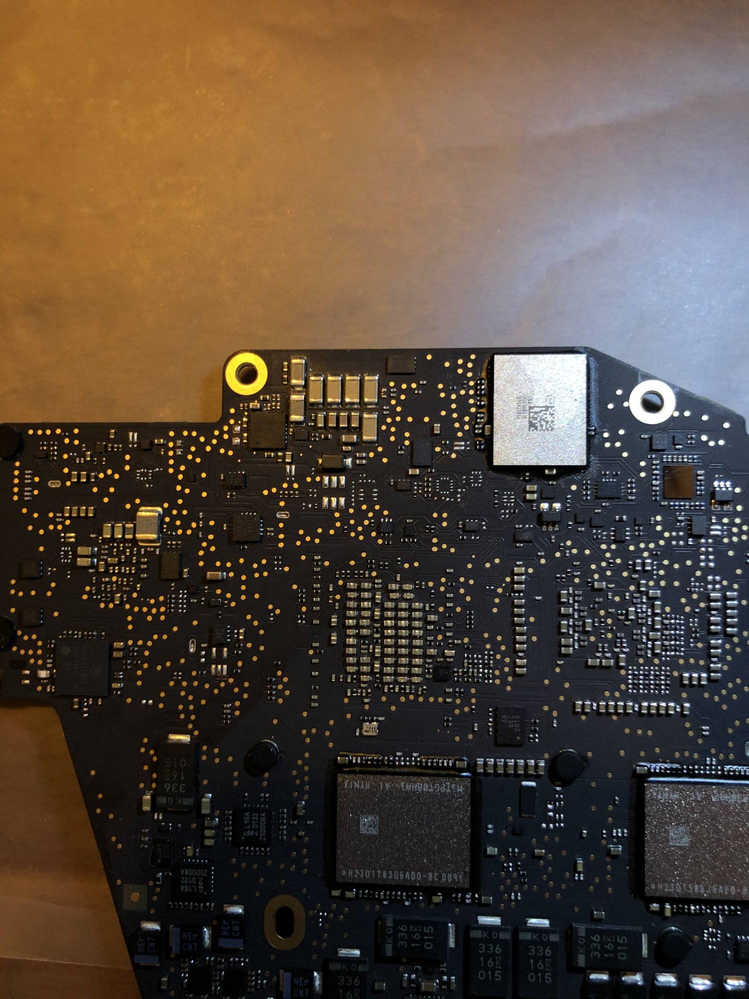

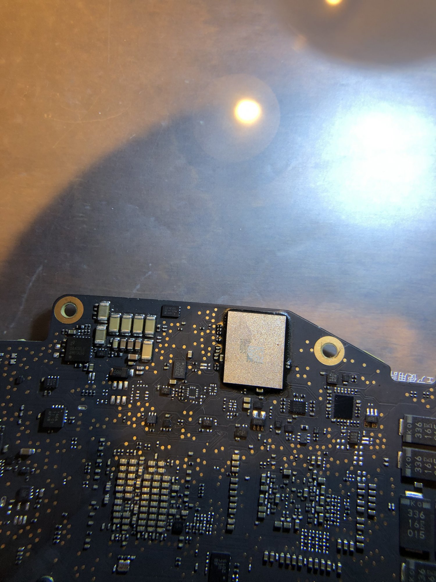

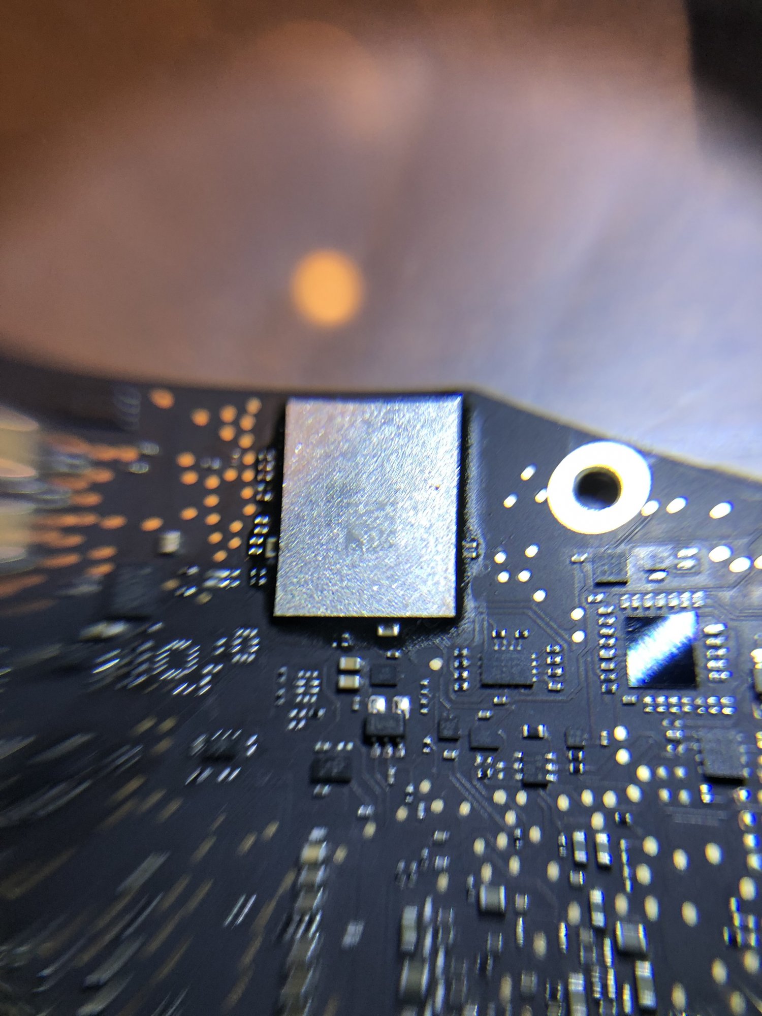

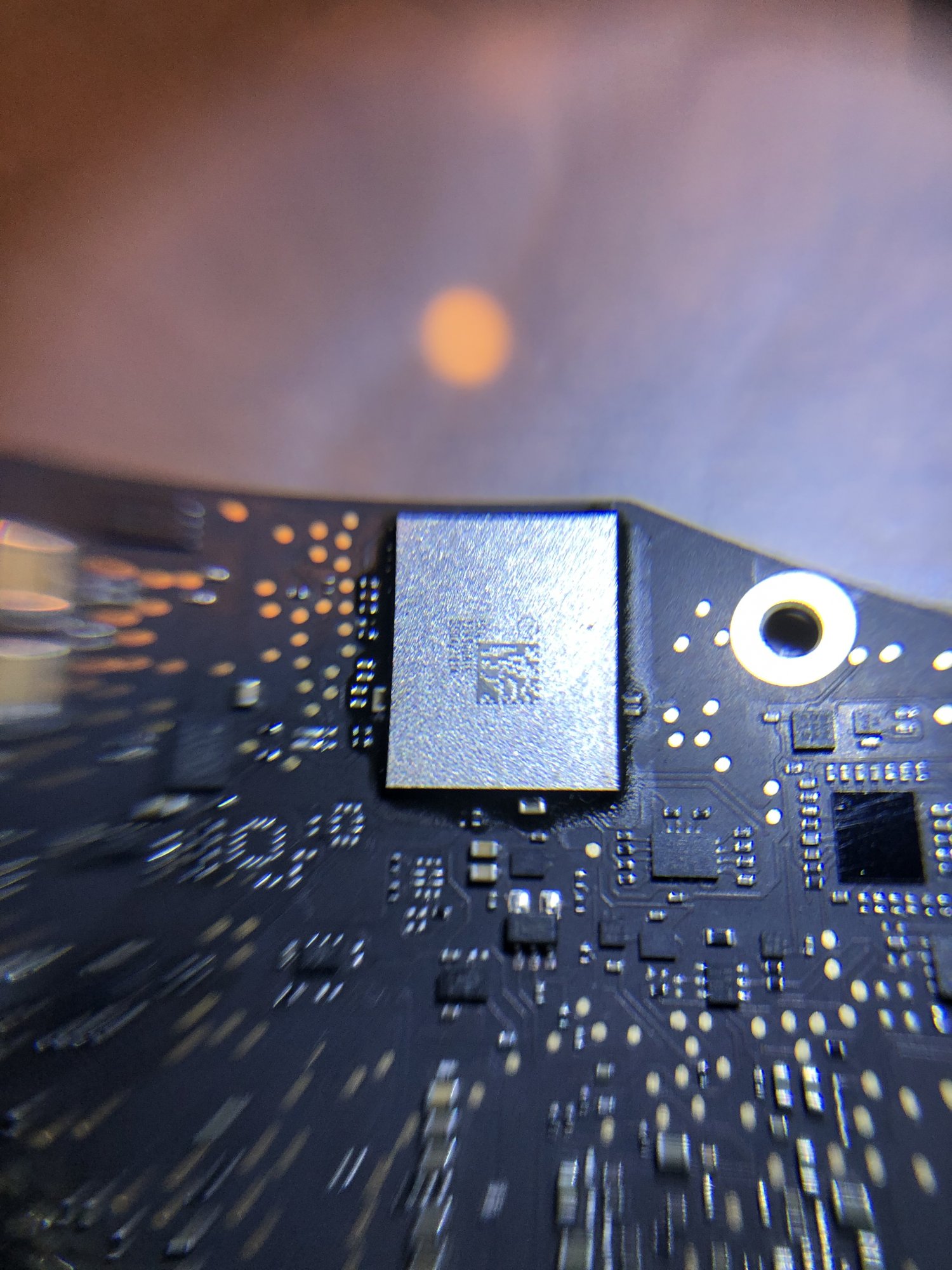

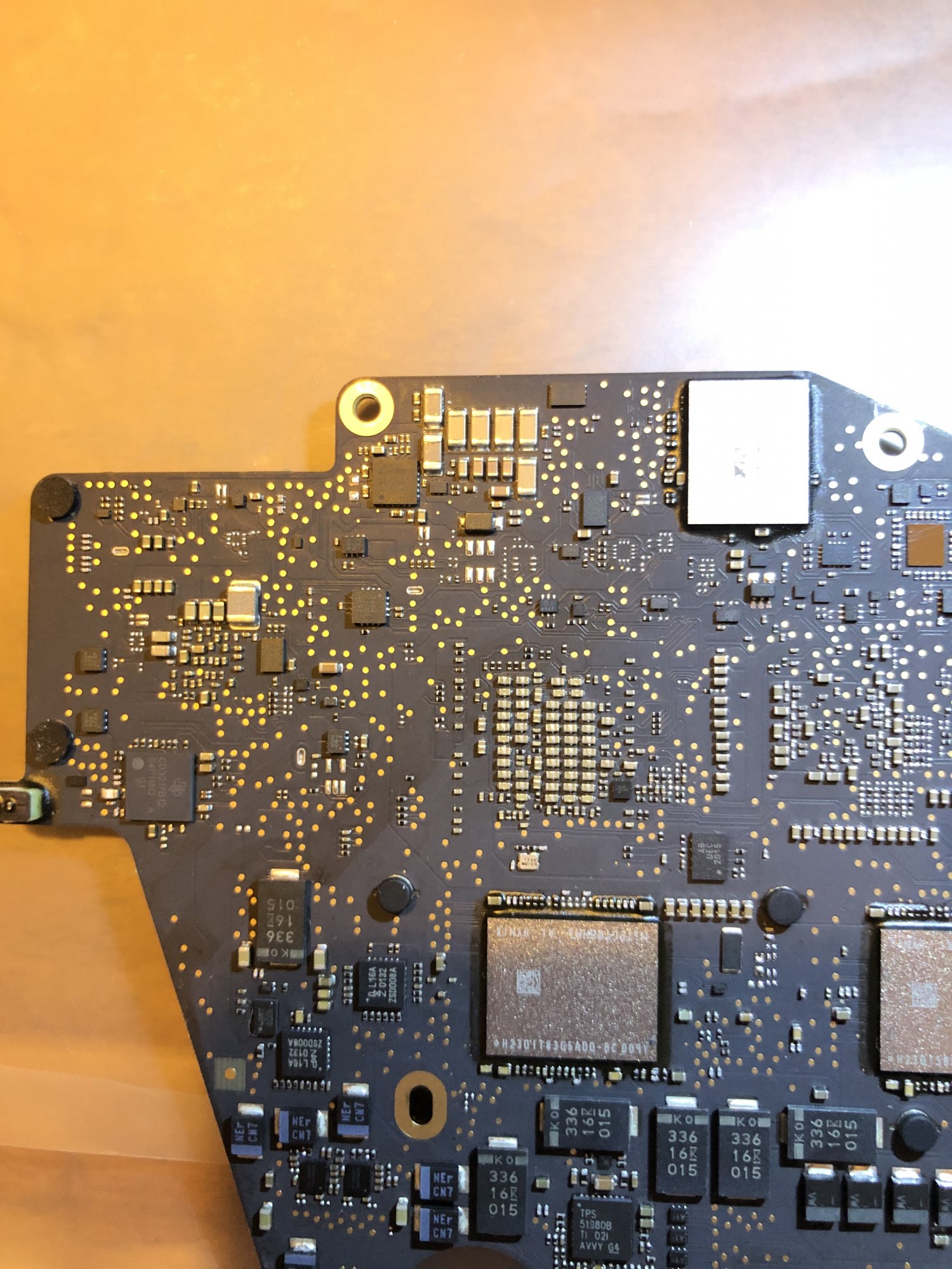

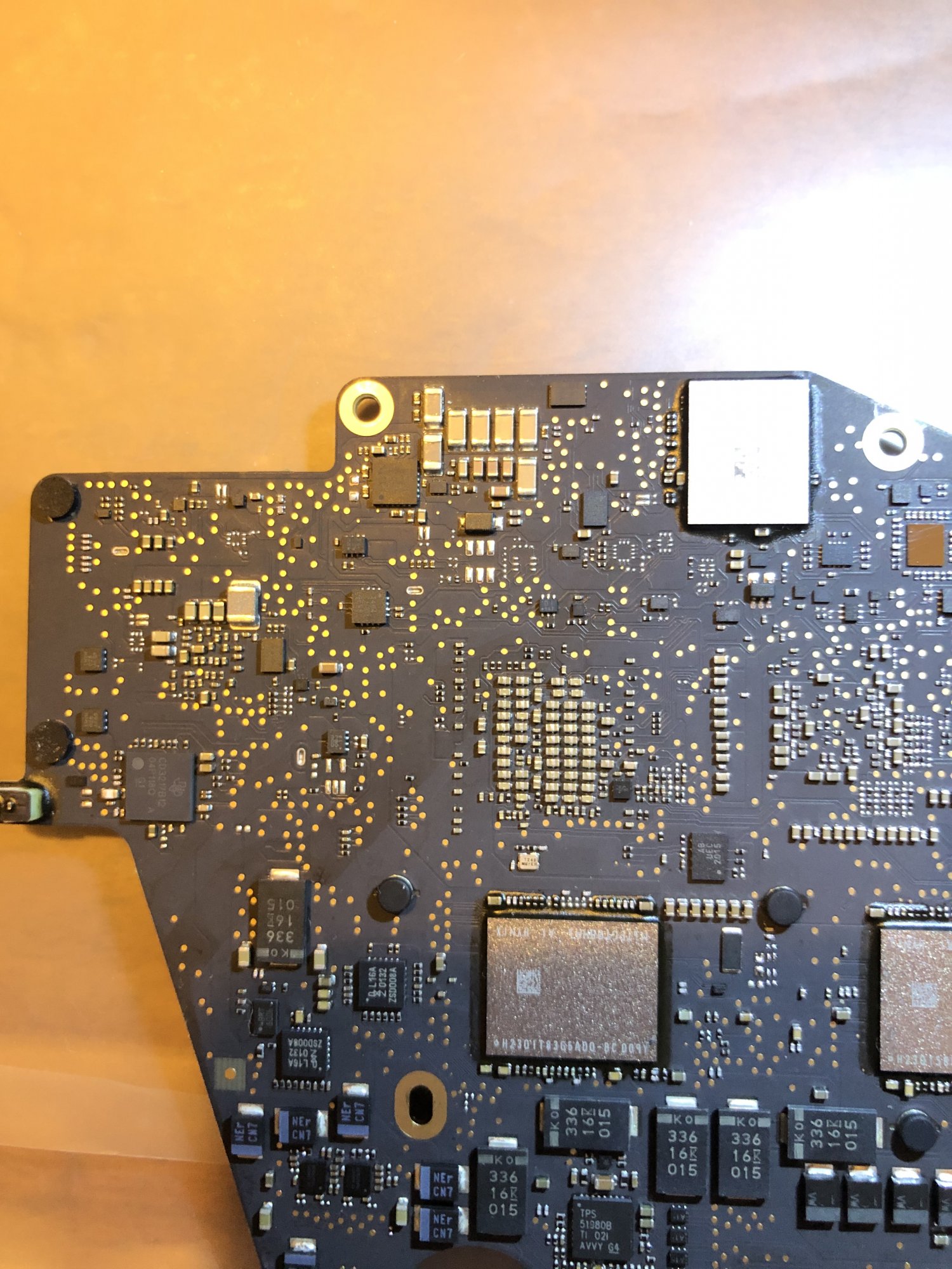

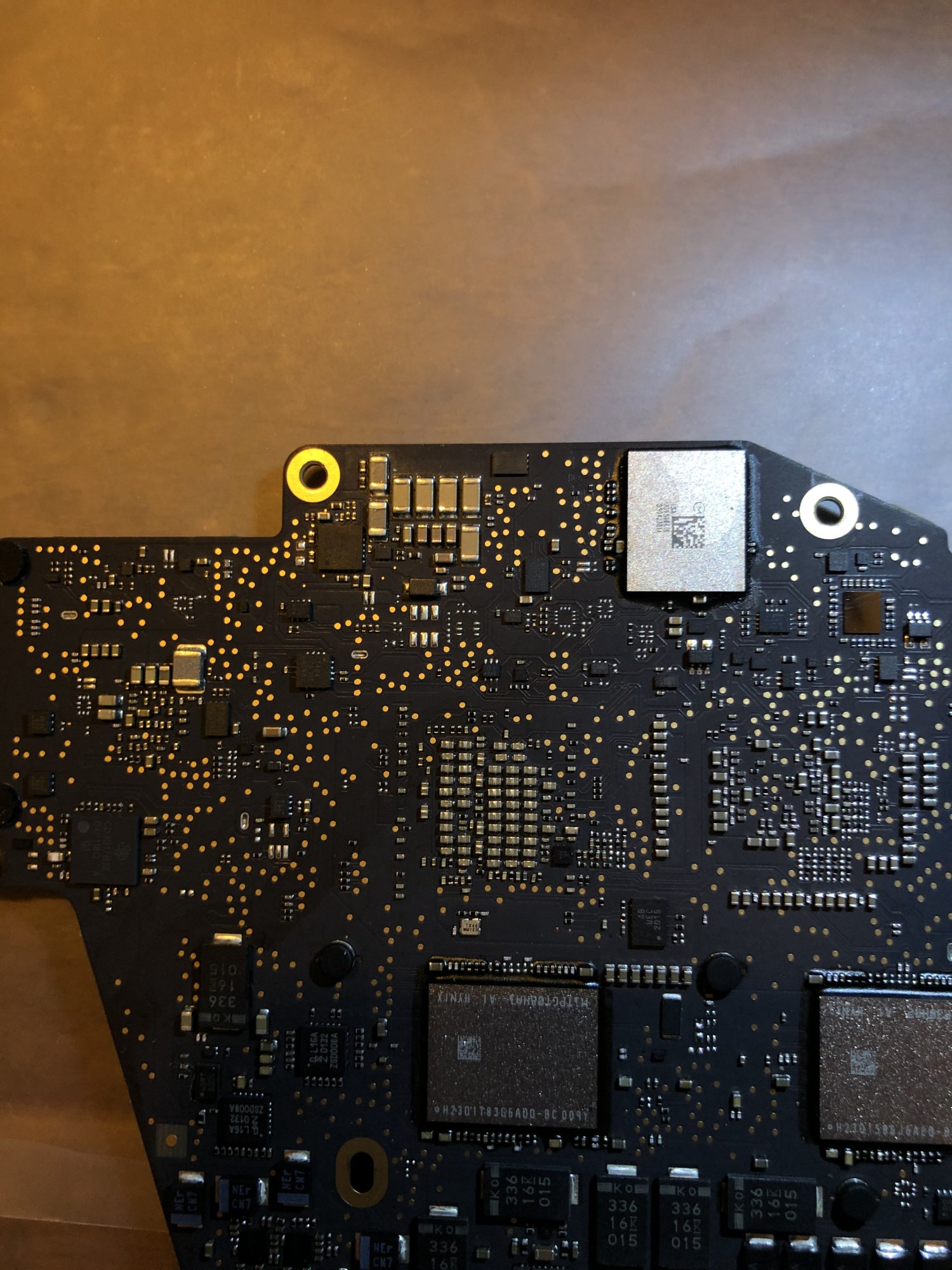

I cannot really let this Mac go, it was a good deal for me. Anyway after teardown the whole mac I noticed what seems a trace of some kind of liquid flow from a to b in the downside of logic board (photos attached). But I don't see any trace of corrosion or water sensor color change. I cleaned all with 98%alchol and reassembled it. Now apple diagnostics show no error detected (maybe it was just fan ribbon needing to be reseat), but keyboard and trackpad still not working at all. Only key working is finger print, and touch bar display image but don't accept any touch.

Putting logic board in ultrasonic cleaner can help me even if i can't see any corrosion sign?
What do you expect to clean with ultrasonic? Water damage is connected as well to shorting circuits if battery was connwected or if there was current flowing. So i would expect some damaged components if there is no proper shorting protection...more on this, i am not sure if the PCB assembly is designed to withstand high frequency vibrations, may cause solder joints to crack etc
You are perfectly right.. My last hope is that problem is not located to Logic board, but keyboard or trackpad itself.

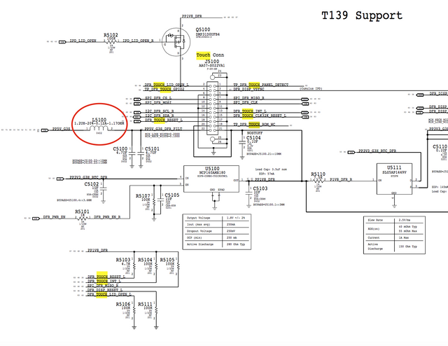

Looking in diagrams i found that there is a component lost:
Can be this the problem? Connectin an other touchbar won't fix, still display but not accept touch control
