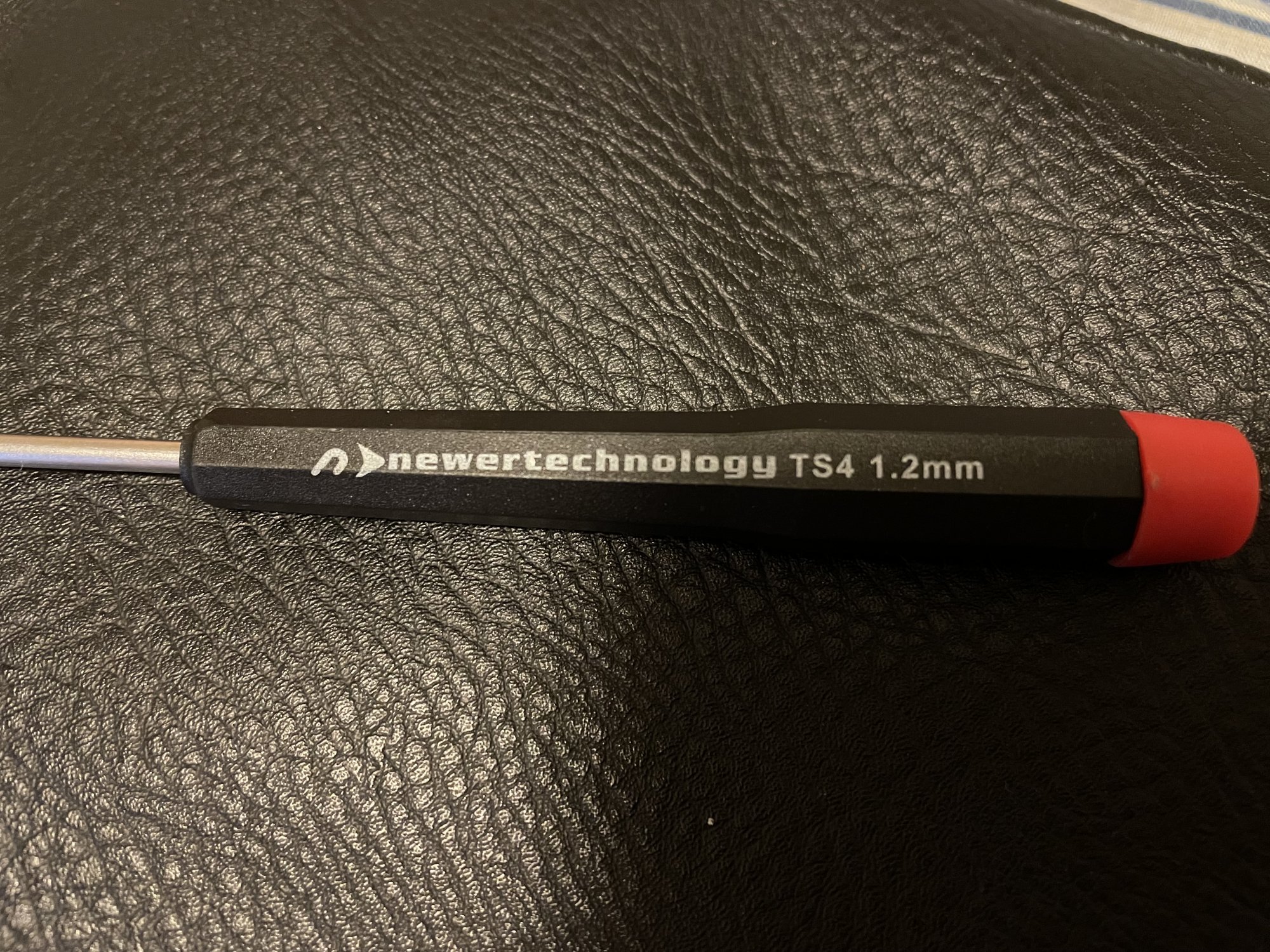

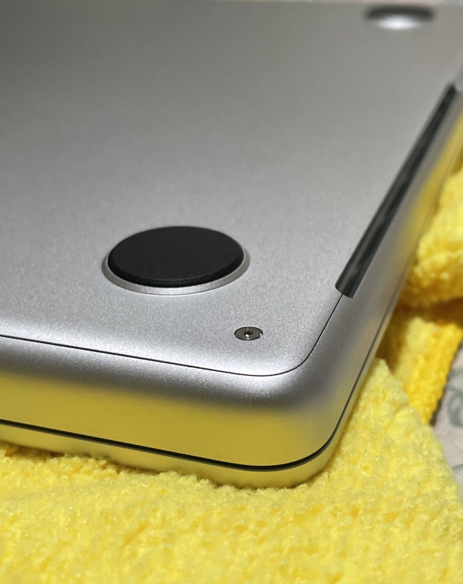

Hello everybody! I have a solution, I recently bought the 14” pro M1 and had the same problem, I have found out you need a TS4 1.2mm driver, it’s like a torx driver but it’s only got 5 points to it’s star head. Step 1, undo all screws on base of case, keep in mine the top 4 along the spine are long screws, step 2 re insert screws, smaller screws first to the bigger screws last. Make sure you go the extra mile and slightly tighten them a little extra without damaging the screws and it should be fixed !
I believe TS4 is equal to a P5, so if you have a P5 that may work too.
