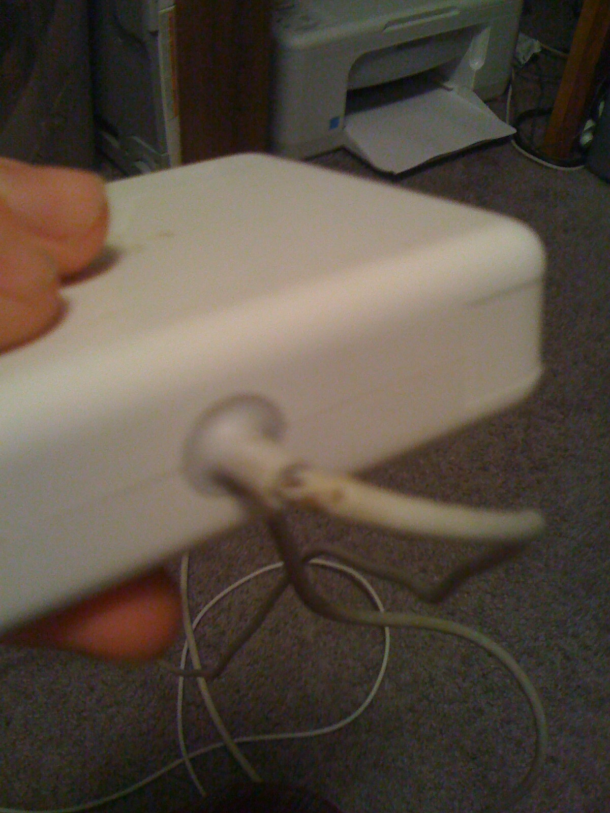

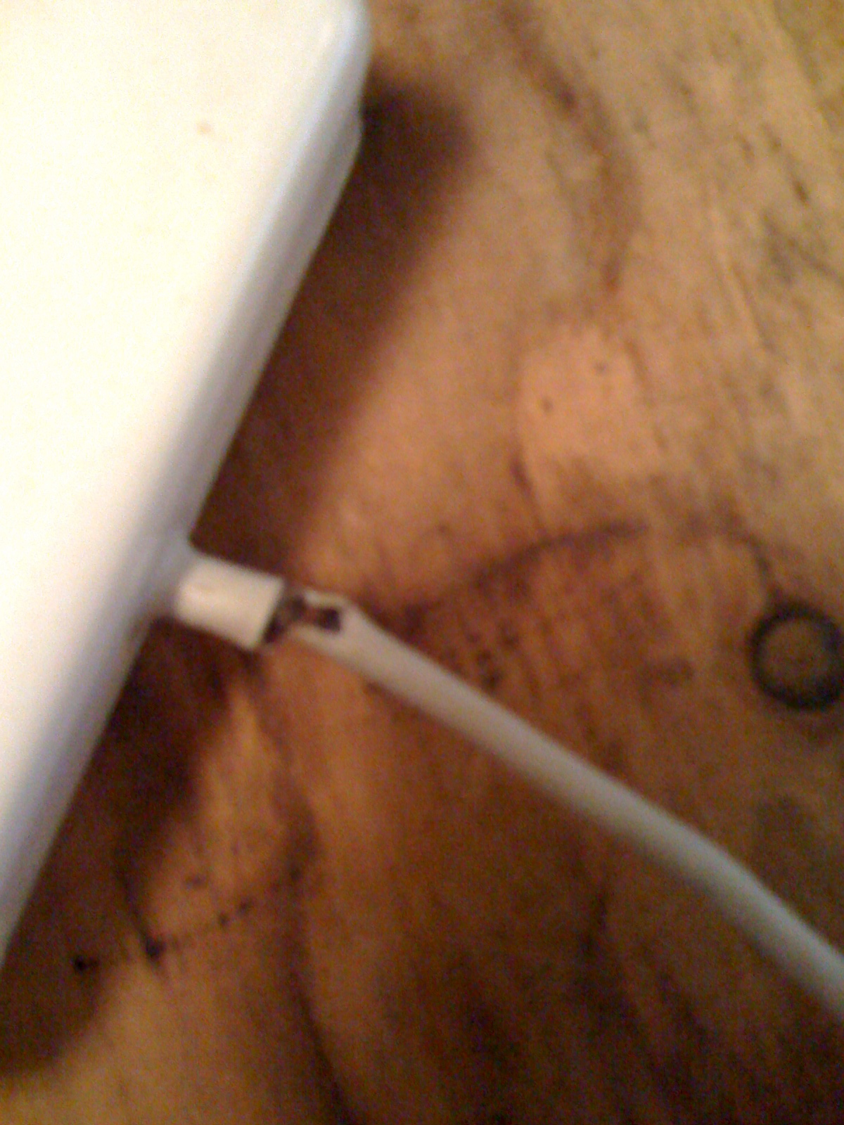

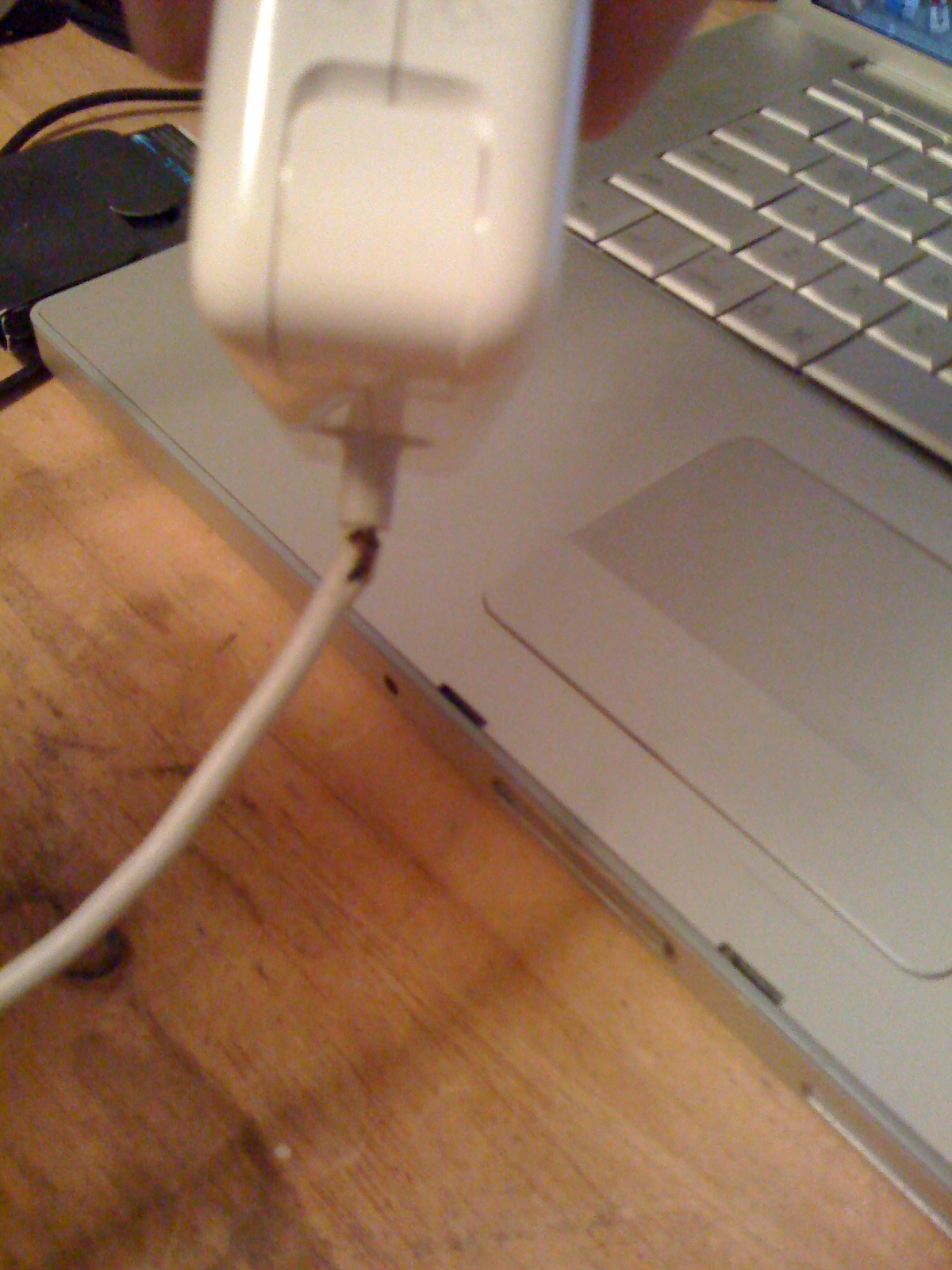

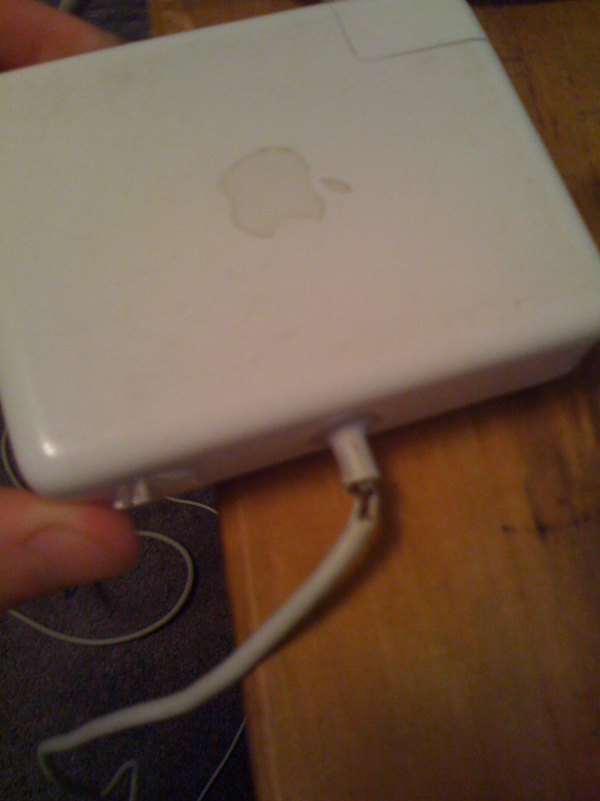

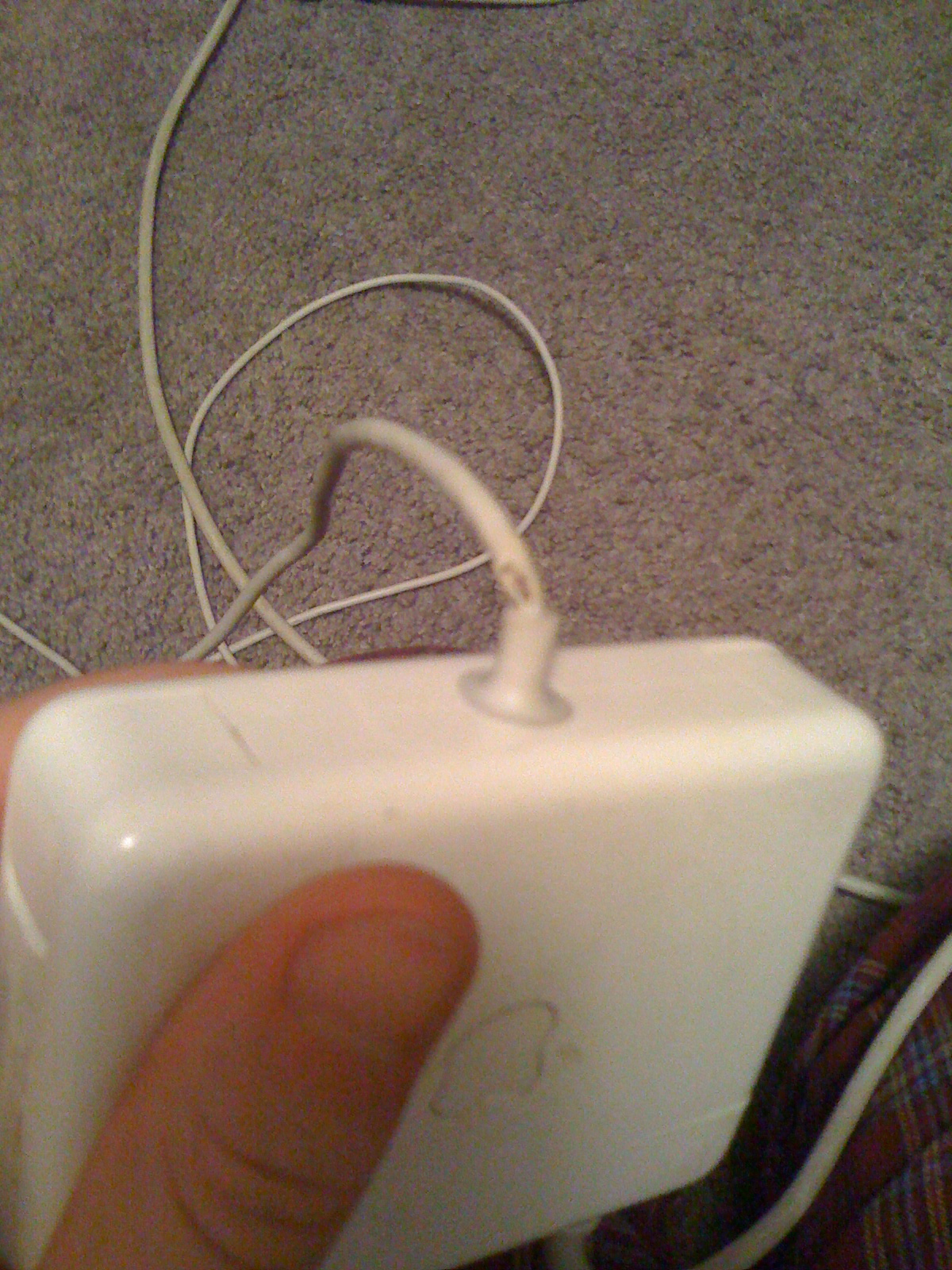

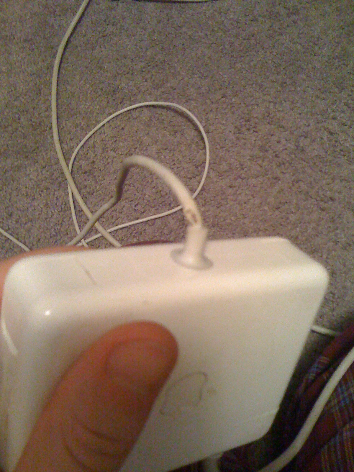

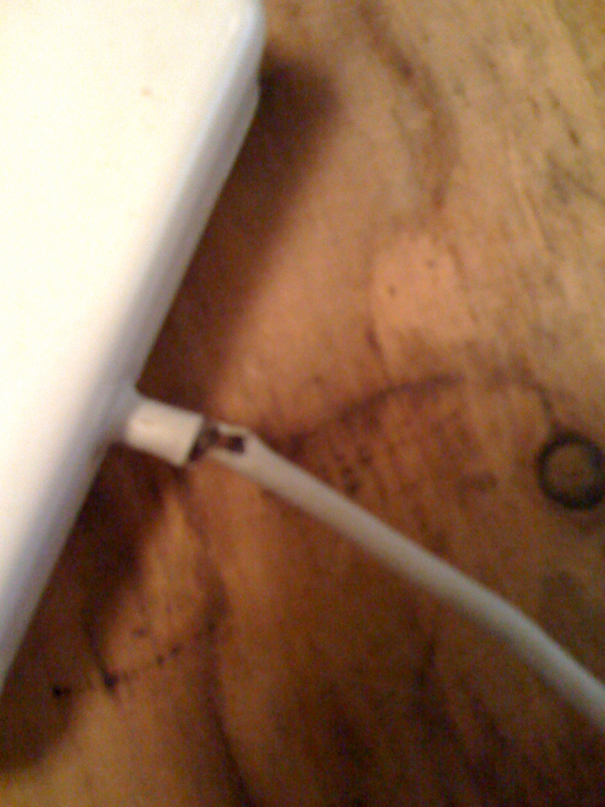

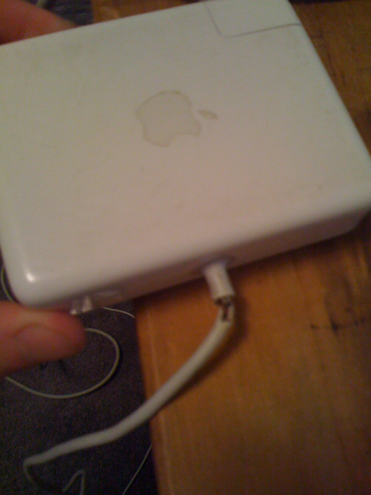

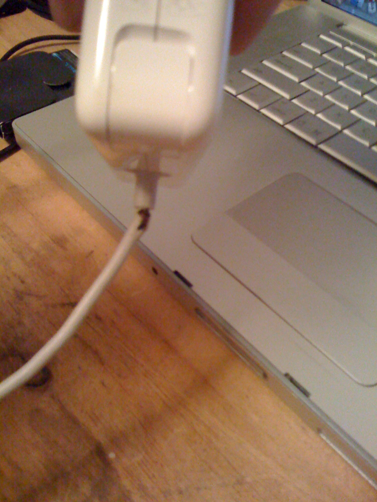

I thought it would never happen to me!
I smelt burning plastic earlier, and inspected my room only to find that the powercord was slightly melted near the box. Since I didn't have any other cord, I decided to plug it back in and watch it very closely.
Very quickly it heated up again, this time melting enough to exposing the inner wire, and making smoke! Needless to say I am NOT plugging it back in, and am now slightly scared! What if this had happened when I was not home?!

As the other poster said, there have been 3 others like this reported. Curious if this is Country bound (Power differences) or Adapter.
It's happened in the USA as well.

Precautions I can recommend ....
Do not allow the wire at the connector to be bent/twisted. I think there may be an internal weakness within the wire insulation that may cause a short, which would heat up and begin the process of catching fire.
ALSO - NEVER Remove the Magsafe by pulling on the wire. Pry out the connector. I've seen a lot of people just pulling on the cable.
Yes Apple made the Magsafe so it would pull out under stress, but they did not intend stressing it as a way of normal use removal.
No I do not work for Apple, but I have worked in engineering for a number of years in a Failure Analysis Lab. Looking at the ones I have seen burned initially leads me to think the wires stressed at the connector from bending and/or being pulled out by the wire.
