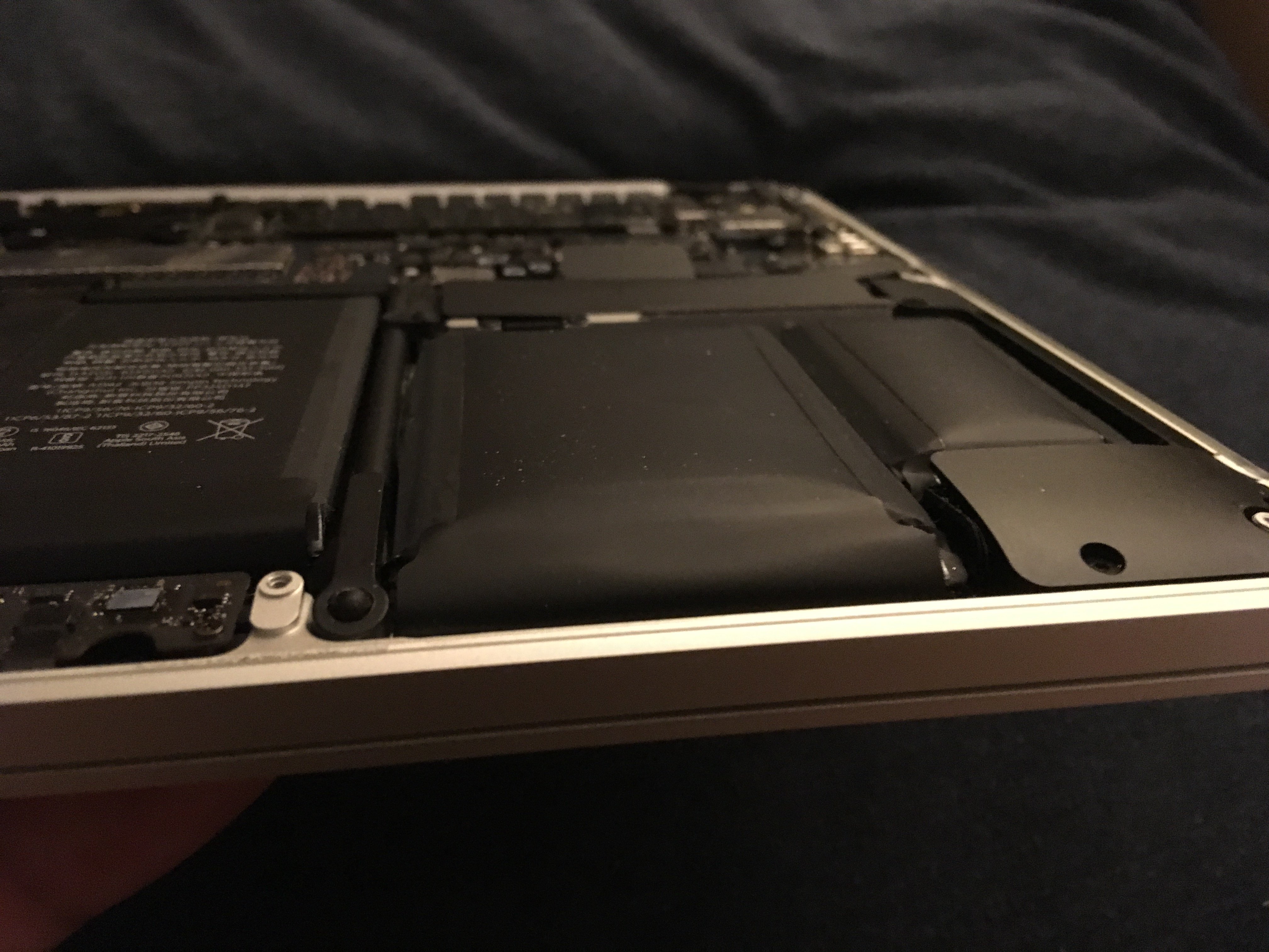

Yes thats the point, thank you! However found the cause. And I think any non original battery ( not the very cheapest ones) will be better than this one. After 1,4 years with 325 cycles. Legend :

I would take it in to an official Apple store. And show them the picture.
That should not happen with 325 charging cycles, and there may be something going on beyond the battery( bad charger, bad power management circuits, etc). See what they say and make sure you let them know you just want a explanation of the battery swelling, and then you will decide what to do. They may offer you a deal.
Reactions: janiwind
I recommend removing the battery ASAP. If it starts to leak or is leaking, it may damage system components.
I disconnected the battery, tomorrow I will book an appointment and I will see...
Good idea, I hope they can offer something because after 325 cycle really a shame
[doublepost=1528482471][/doublepost]Update: I called the apple customer service and the woman said yes it shouldn’t happen after 325 cycle so she booked me appontment for tomorrow for the nearest apple service (Windsor) and the guys in the service will have a look at it. Then this lady will call me back at monday because she need to know how the things went with the service. She also said these kind of failures usually covered up to 3 years but she can’t promise anything yet. I hope they can manage by free od charge
Battery is glued down. Removal is of each pack means heating them and slicing through the glue. I would not touch it and get into Apple and start negotiating
I know the battery is glued down which is why apple replaces the to case during a battery replacement. OP didn't make reference to an appointment with apple when I responded.
They will change the battery free of charge beacuse battery expanded at the first 3 year hurrray! Very good to know because I knew ( and everybody know) there is a battery replacement program but my notebook not in that range as a 2015 model. I checked the serial number on the webpage of course and Im not eligible for it : https://iphone.appleinsider.com/art...-inch-macbook-pro-without-touch-bar-batteries
However in the service they said, yes is free of charge beacause started to expand the first 3 year. Well what I learned, there is a difference between apple customer services. The first woman said in chat, it will cost money to me. When I called apple the other woman said it should be free as very low cycle and something definitely wrong.
