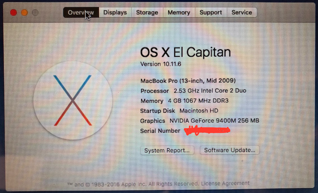

I just got my hands on a MacBook Pro mid-2009 thats in very good condition. I've decided to to upgrade it as much as possible (as per advice I've received on these forums) as it's very slow.
Specs are:
  • MacBook Pro 13" mid-2009
  • Processor 2.53 GHz Intel Core 2 Duo
  • Memory 4GB 1067 MHz DDR3
  • Graphics NVIDIA GeForce 9400M 256MB
  • OSX El Capitan (10.11.6)

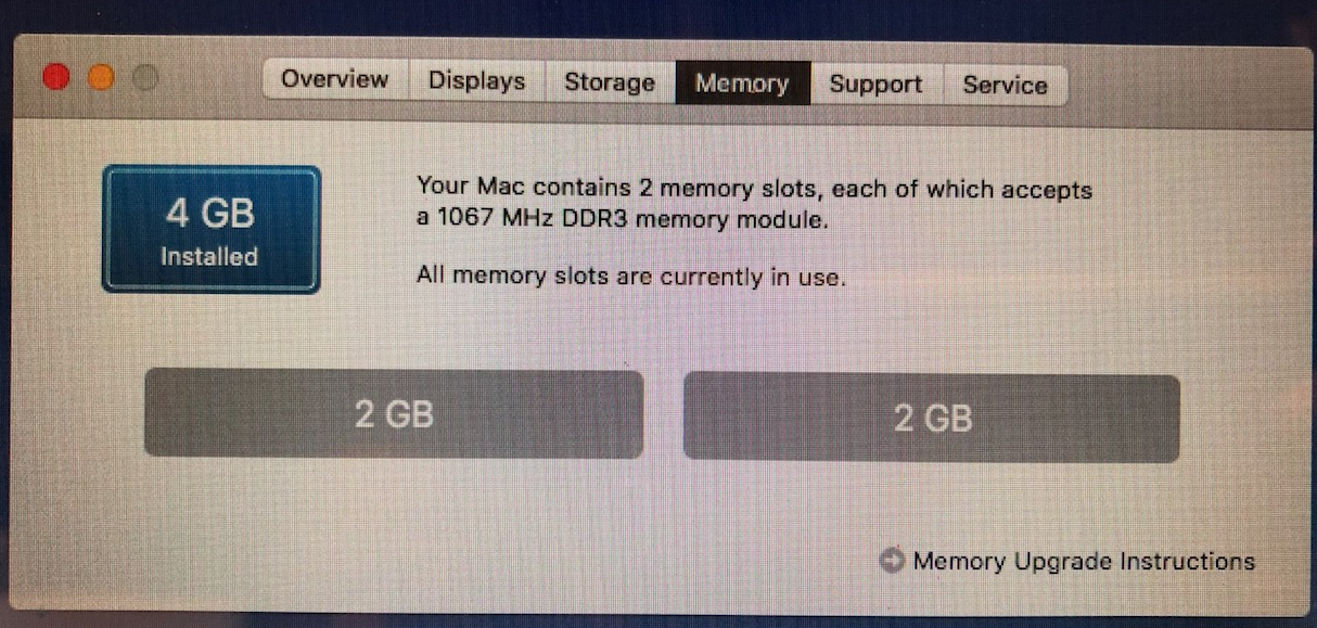

I want to upgrade the HDD to an SDD, and I'll put in as much RAM as possible (there are 2 RAM slots (see attached) ... can this machine take 8GB?). I'm also thinking about replacing the battery (current health is less than 50%).

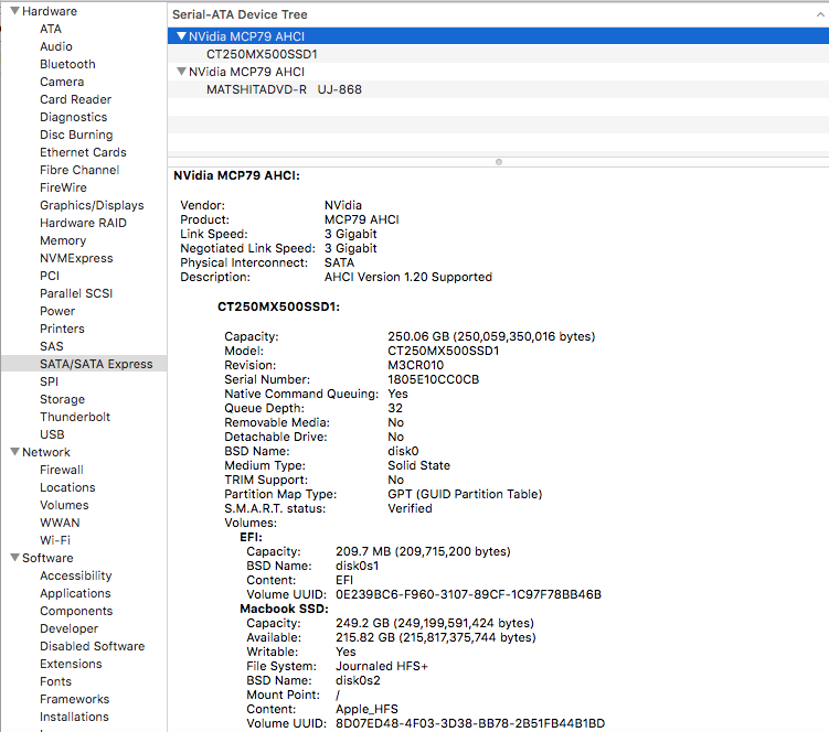

So I did it! Installed the new ssd, clean install of El Cap and feels like a new machine. I kept the original battery and the original 2+2 gigs of RAM. Total cost was less than $90 and around 2 hours of my time.
Boot time to desktop is now under 10 seconds! I am so so so happy :)
Thanks to everyone for their help. Anyone considering this ... do it! It’s cheap and easy and you’ll have an amazing machine at the end of it.

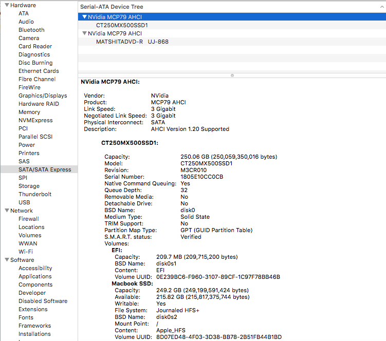

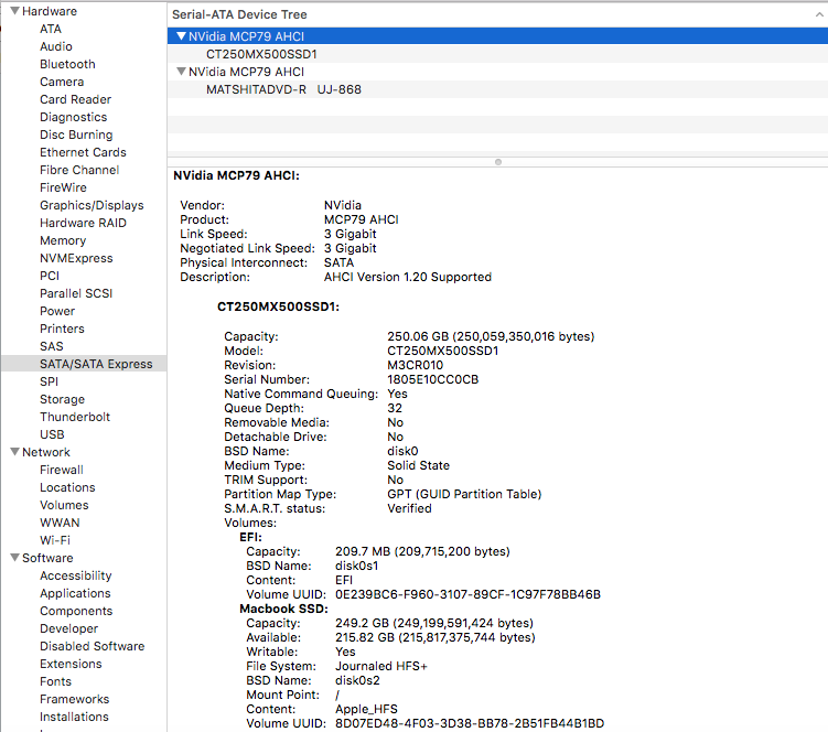

Congratulations. Glad you were able to successfully upgrade.

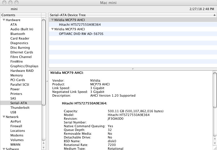

It would help us help others if you could find out what negotiated link speed you're getting.
In Spotlight, type in "System Information" and press enter. Alternatively, you can click on it - it will be in the Applications/Utility folder. You should get something that looks like:
(This is from my Snow Leopard Mini, so it looks slightly different.) Make sure the "Hardware" list is open (if not, press on the arrow pointing toward the right). Select "SATA/SATA Express" (it appears as Serial-ATA on this image). Select the first "NVidia MCP79 AHCI" as it is in this image. On the bottom, what "Negotiated Link Speed" do you have? In this section, the vendor should be "Crucial" (or possibly "Micron").
Again, this would be really helpful to others who come here looking for suggestions at to which SSD to get.

Yeah, you need to enable TRIM.
1) Open Terminal
2) Type "sudo trimforce enable" and confirm you want want to do this at the prompt
3) Reboot
Then check System Information again to confirm TRIM is enabled.

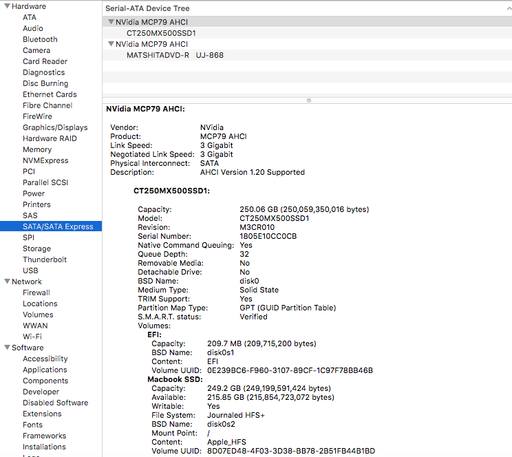

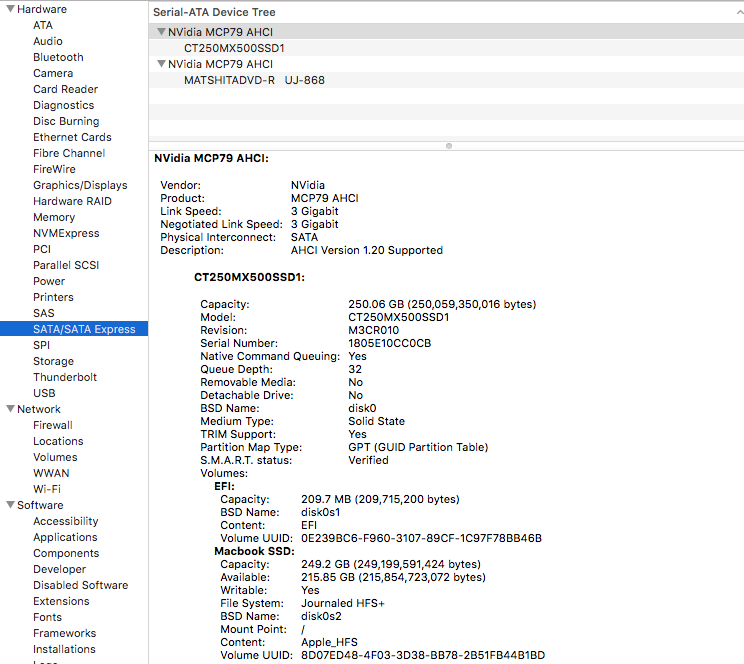

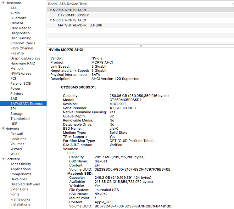

TRIM enabled - thanks for the recommendation. This is an incredible community - thank you all so much again :)

[doublepost=1520022606][/doublepost]TRIM enabled
