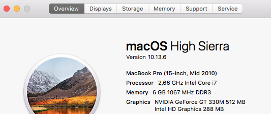

Hello,
My Mid-2010 15 inch MacBook Pro with High Sierra installed on it has problems with both USB ports. The first was already broken when I bought the MacBook and the second one isn't really broken but disconnects the USB Sticks/External Drives randomly. I tried resetting both SMC and NVRAM, nothing has worked. It's really frustrating because I've been trying to make a bootable macOS installer on a USB Stick and it disconnects every time after like 10 minutes. The ports are pretty nasty inside so I will clean them soon. Just praying for it to not be a motherboard issue. Any help appreciated! Also my specs:
