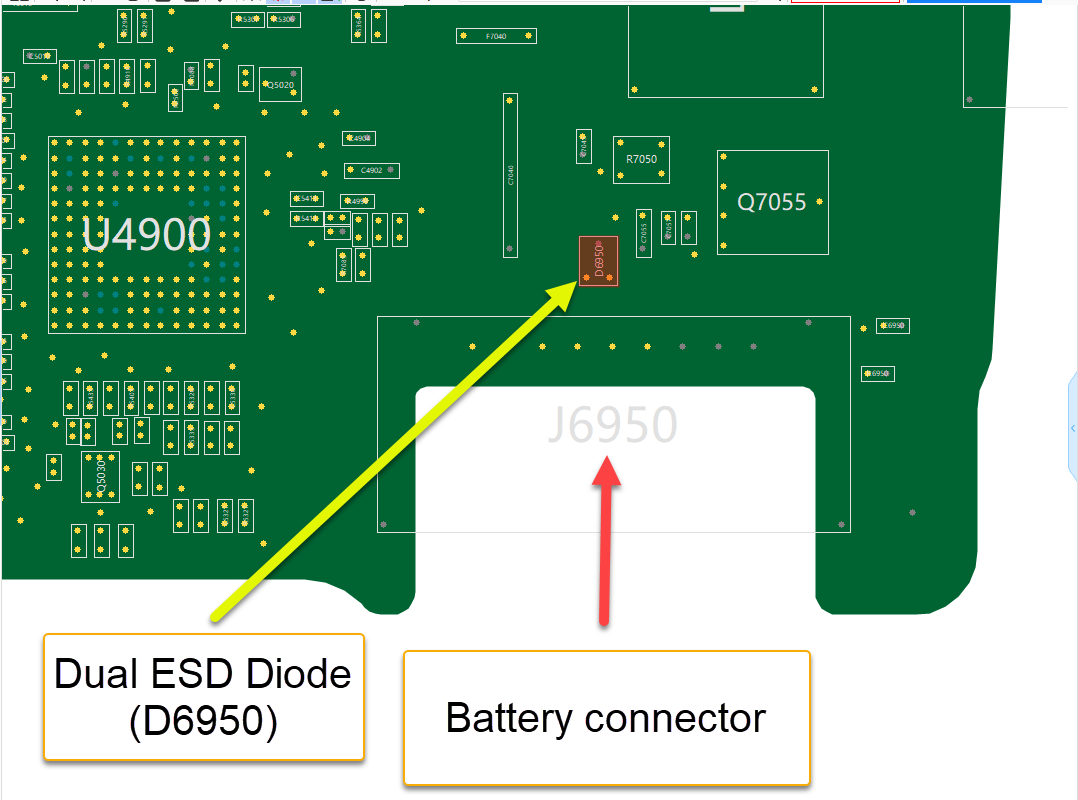

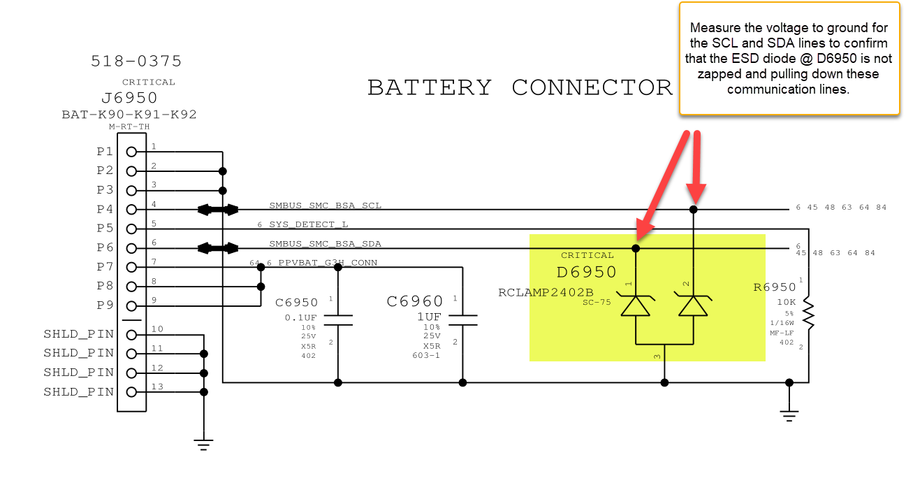

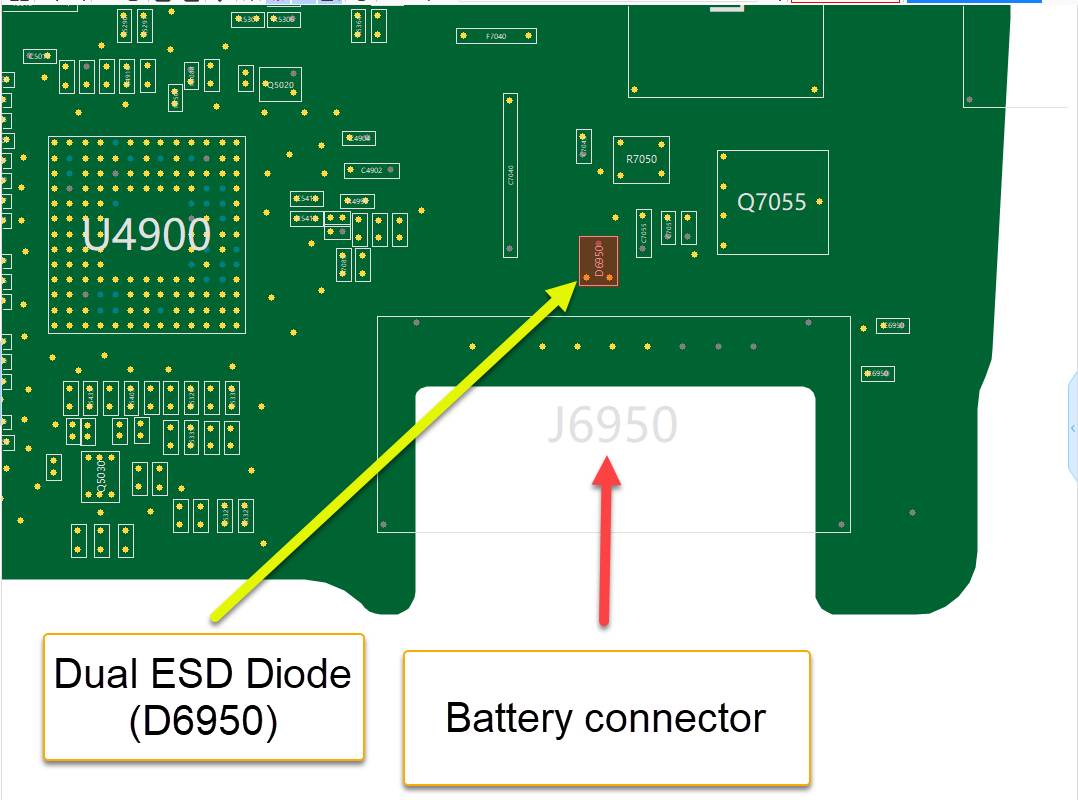

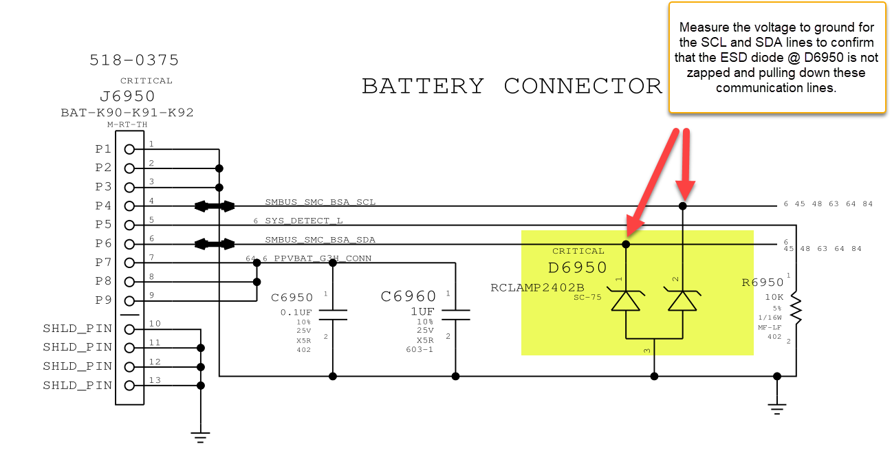

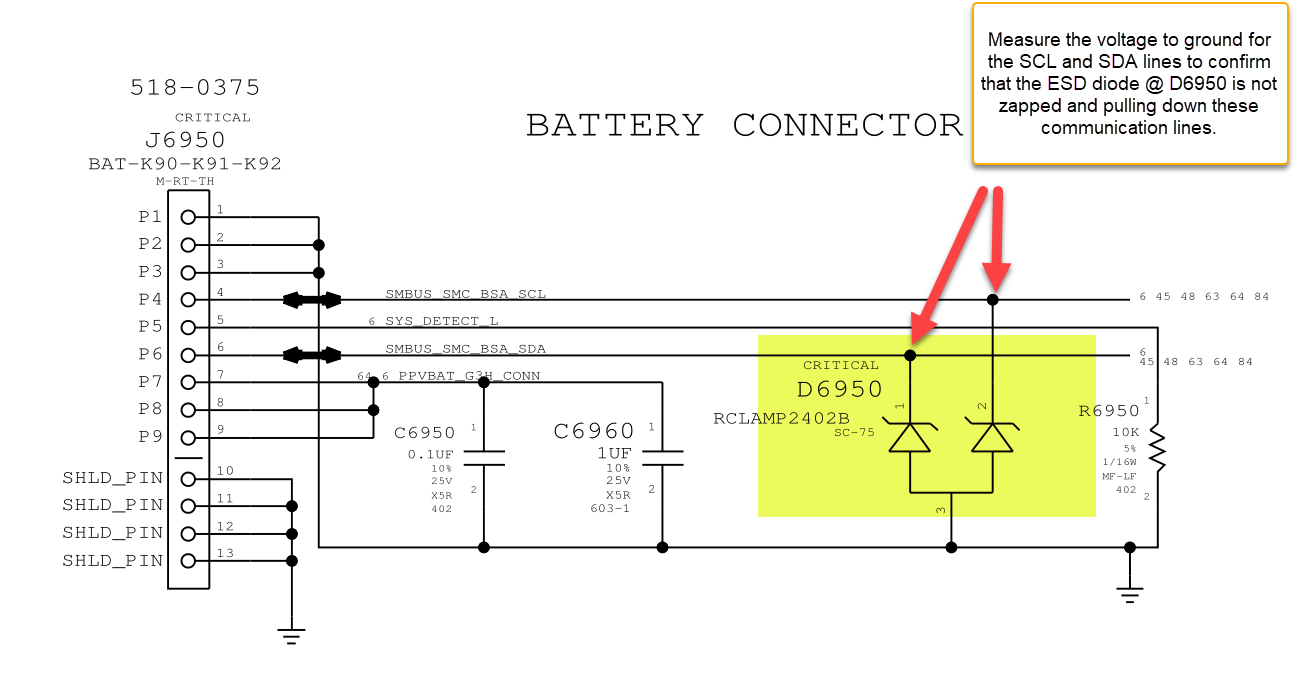

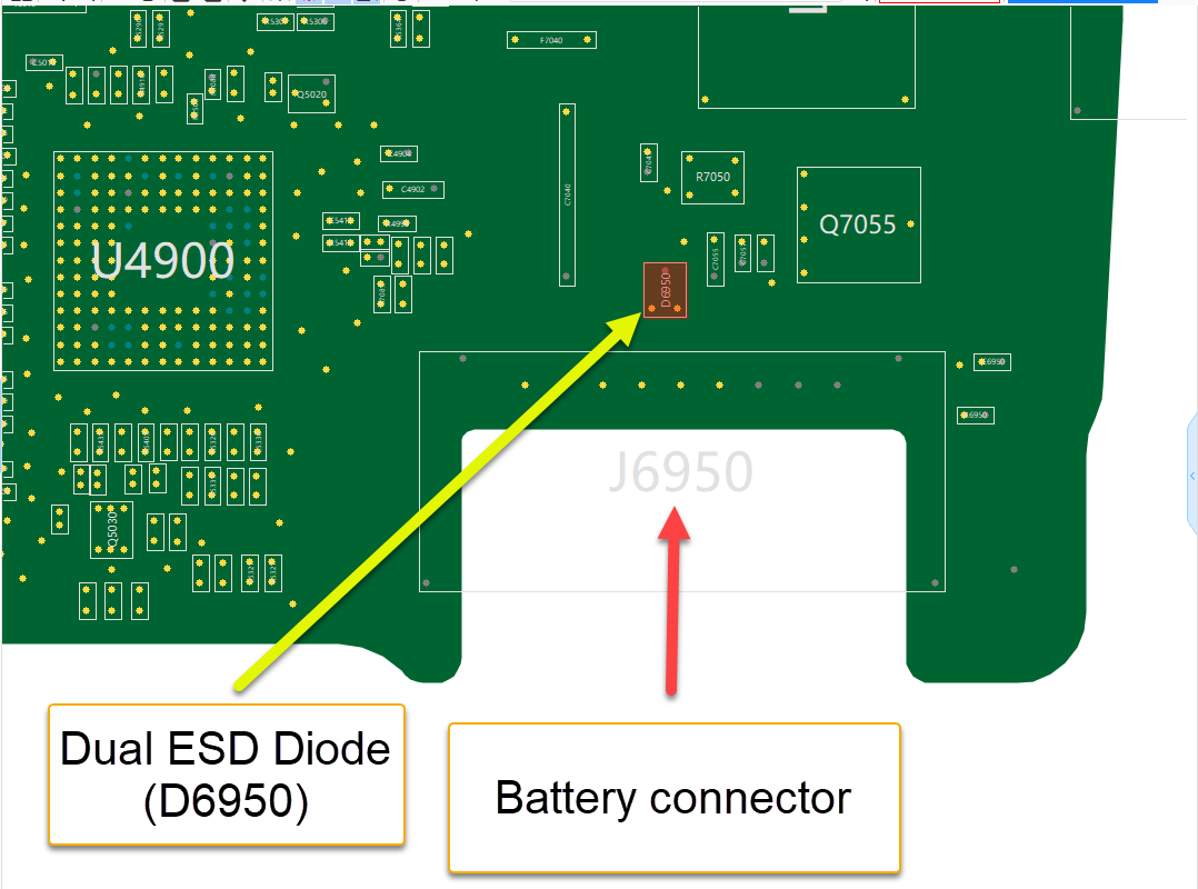

Also, what is the history of this unit? Just decided to misbehave one day? Or was the battery replaced and then led to this fault? The reason being that often but not always, Apple logic boards feature a TVS ESD diode (it is a 2 line static discharge transient suppressor component with 3 legs). This device is intended to be self sacrificial and is there to prevent a surge from the tech / customer zapping the sensitive electronics. Often this ESD diode gets killed. Once this happens, the communication lines between the battery pack and the logic board will fail. Respectively, the logic board will then be unable to extract the required information from this power source and will treat as though the battery is absent.
Specifically, these are called the SMBUS (I2C) SCL and SDA lines and they are present on every battery pack used by Apple / Foxconn. Through these 2 lines, the logic board is aware the battery pack is docked and details such as # of charge cycles, etc. Each battery pack features a BMS board = battery management board that spits out this information. It is a quick test to confirm if this part (if present on the logic board model) is the fault. The part is less than $0.10 USD but requires the hot air tool to flux and remove and then ideally replace this part. We killed 3 days in locating this fault the first time - other techs gave up on this repair locally.
Update - based on the age of the unit, it is very possible that the original battery is just depleted and is unable to charge. There are flaky batteries on the market so be sure that the replacement battery is a known good one. Does Amazon service your region? With Amazon, you can return the product if it is not required.
Aside from the above, posting the ESD (electro discharge device) component which *may* be at fault.
