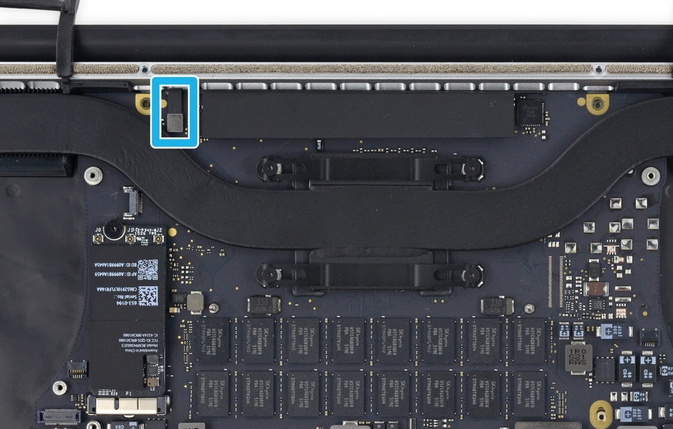

There is a separate cable for the keyboard backlight. Are you sure it is connected?

The screen replacement shouldn't affect the backlight on the keyboard.

that is basically it. I think I put everything back properly though
It may be worthwhile to reseat all cables and try again. Can't really think of anything else that would cause this issue unless something else was affected after the fall.
