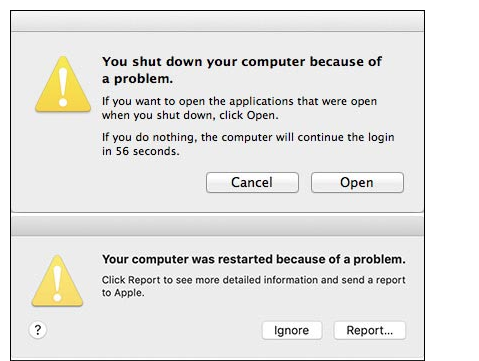

Hi everyone,
My mid-2010 macbook pro is shutting down or restarting randomly. One of these is what I see:
I have a feeling that it's because I have an outdated OSX, which is El Capitan, which I keep because I have some programs that won't work on a new version.
Can you give me your thoughts on if the outdated OSX is the problem? I also do have issues with certain websites giving me privacy connection errors, which I do think is because of the OSX.
Should I upgrade the OSX and lose my programs to solve the problem? Or is it time for new computer due to the age of my macbook?
Thanks so much!
Lynne

Your computer is nearly old enough to be a teenager. I would recommend upgrading just on the age alone.
I understand the desire to keep old apps, but staying on an outdated OS represents a security risk, and limits functionality. It only gets worse over time.
Without knowing what is causing the issue, I would recommend first entering recovery mode and running first aid on the drive.
If this does not solve the issue, reinstall the OS on top of the current data.
If this does not work, wipe the drive and reinstall from scratch.
Much beyond that, your options become limited.

Otherwise you can check console and look at the system crash logs to see if they tell you why it is crashing. Could be hardware, could be software.

Upgrade to High Sierra by installing fresh to see if the problem still happens. You have a seriously outdated OS and hardware and it’s difficult to diagnose without eliminating at least one variable.

Something that happens really often with old computers is their vents fill up with lint.
When this happens, they overheat and when they overheat the bios shuts them down.
It appears to be random but it depends really on what is running. If it's an intensive program they heat up quicker.
I don't know your model but if there are any slots or vents underneath in the first instance you just blow through them and see what comes out. It's a quick fix. You'll probably see a cloud of dust and an improvement for a while. That' a sure sign it's full of dust or worse:lint but I'd be really surprised if it isn't on a 12 year old machine.
If you can take the bottom of the case off (but if you do just make sure you are wearing natural fibres, take your shoes off and make sure you're not on a synthetic carpet: anything that can charge you with static electricity in other words) and clean everything out. Really gently. Blow it if out if possible - canned air for instance- and maybe clean the fans but don't touch any circuit boards unless you have to. Just blow them off.
It's usually worth giving it a go before you do anything else especially just blowing through the vents.
