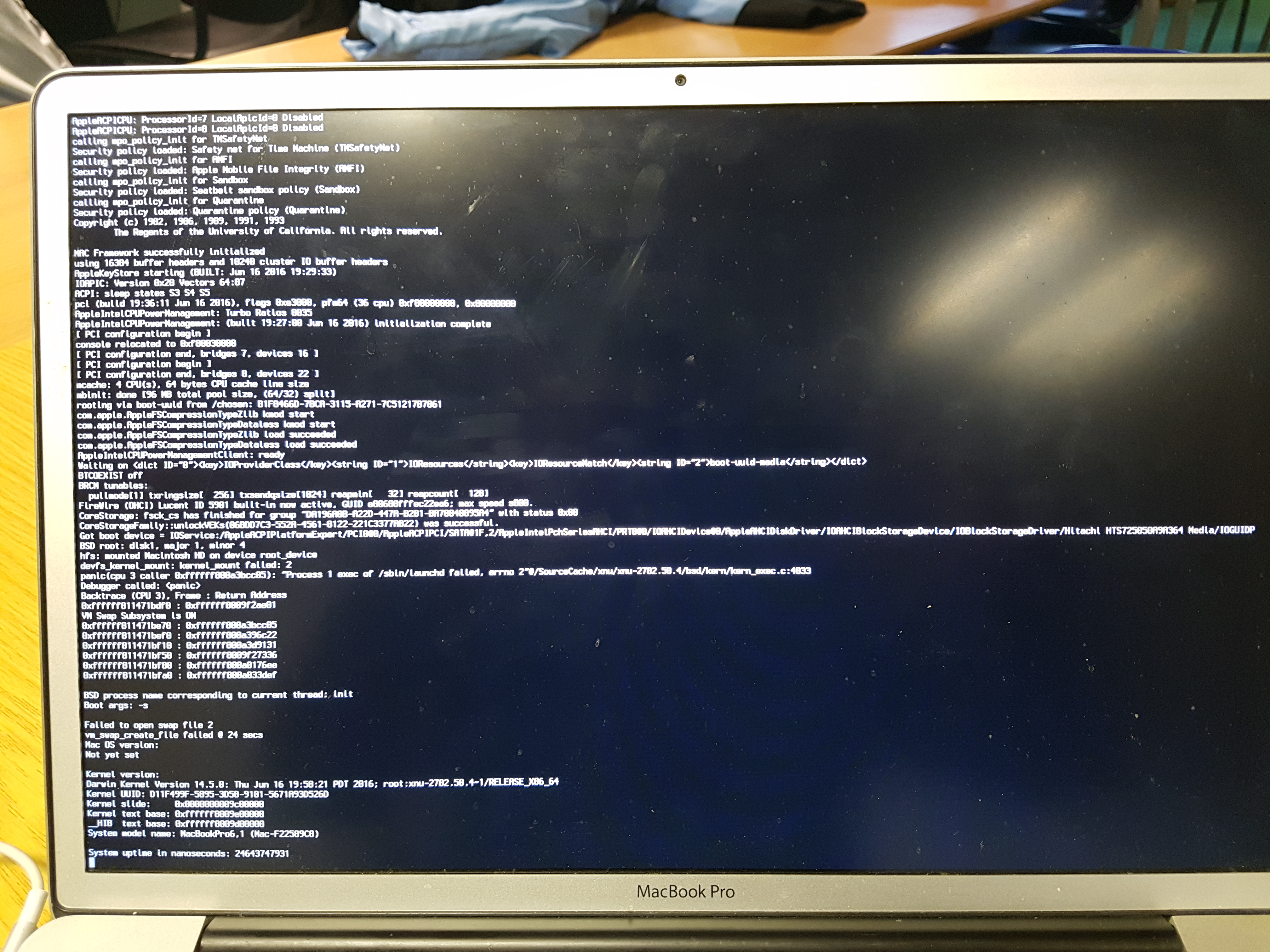

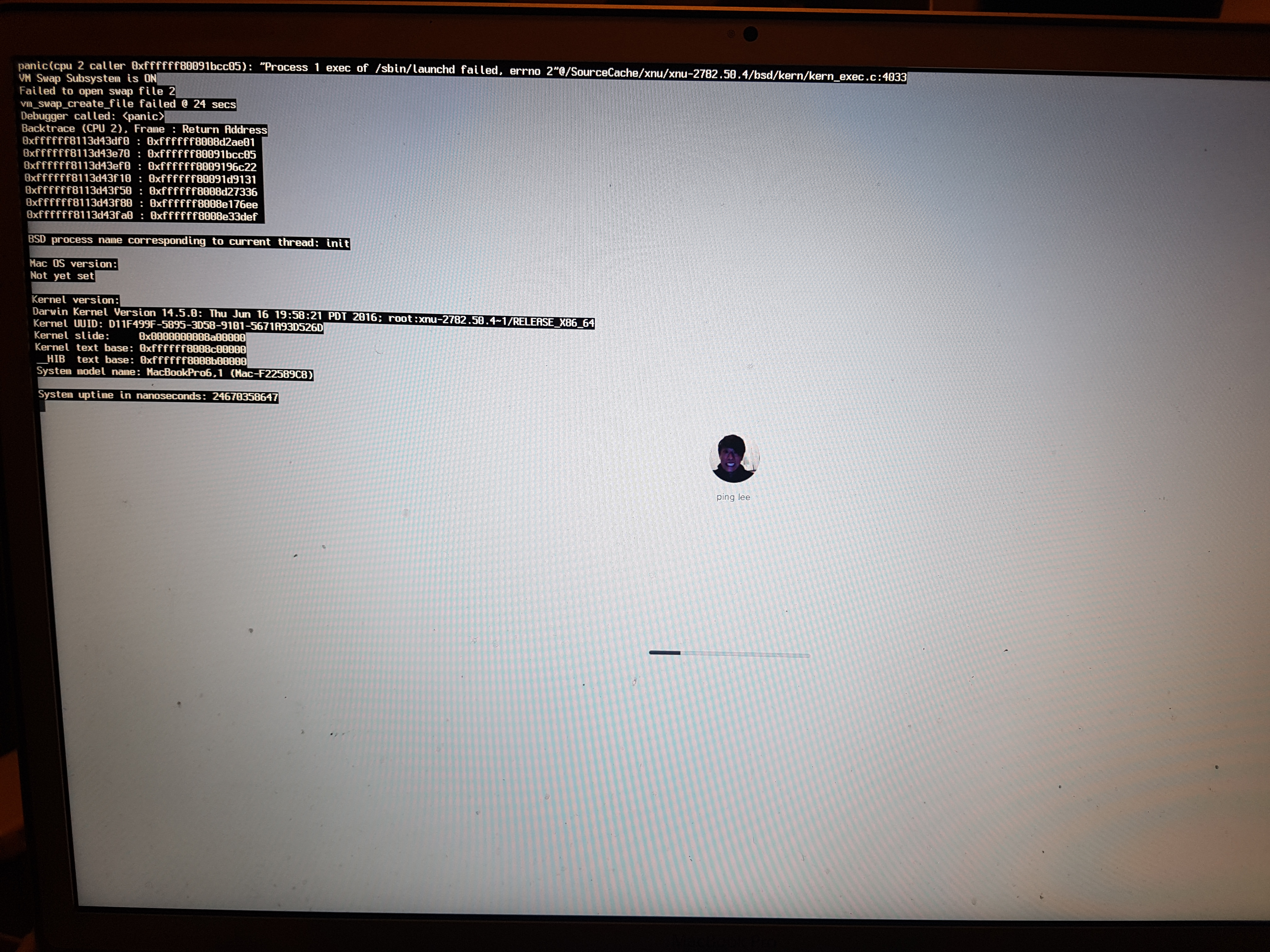

My macbook pro 17 inch mid 2010 had been warning me that my battery needed replacing for a while (maybe a year or more). Last weekend it wouldn't start up... no sign of life. I assumed the battery was to the culprit but when I checked, the power supply was plugged in and switched on. It would only boot up when I unplugged the magsafe and pressed the power button for 10 seconds, attached the magsafe and released the power after a further few seconds. It would shut down suddenly without warning a few times before fully booting. On a few occasions it would shut down after booting up. Now it doesn't get beyond the boot screen with the status bar before shutting down and restarting again.
I tried reinstalling the os via recovery, it shut down halfway through. Now it won't boot into recovery. Online recovery produces the error 6002f. Can't boot into aht mode. Tried a blank hdd but the optical drive is non responsive so I can't install an os via that way. I've attached some screen shots of errors before I tried reinstalling os (I think!)

[doublepost=1485992713][/doublepost]Actually, I think those screen shots were taken after I attempted reinstalling os
If you have the original DVD's that came with the MBP, use the applications DVD to run a hardware check.
OP reported the optical drive wasn't working. OP, do you have access to another Mac (or a friend) that would be willing to create a USB installer for you?
http://www.macworld.com/article/309...-a-bootable-macos-sierra-installer-drive.html
You might have a bum stick of ram, could also try removing or swapping ram to see if it produces better results. Without disk 2, as Bending Pixels recommended, it may be difficult to completely diagnose and it's just a guessing game at that point. I don't believe the 2010's received updated firmware for built in diagnostic off the recovery partition, though you could try holding 'D' at startup to see.
If all fails, your local Apple Store might be willing to run a diagnostic if you schedule an appointment.
