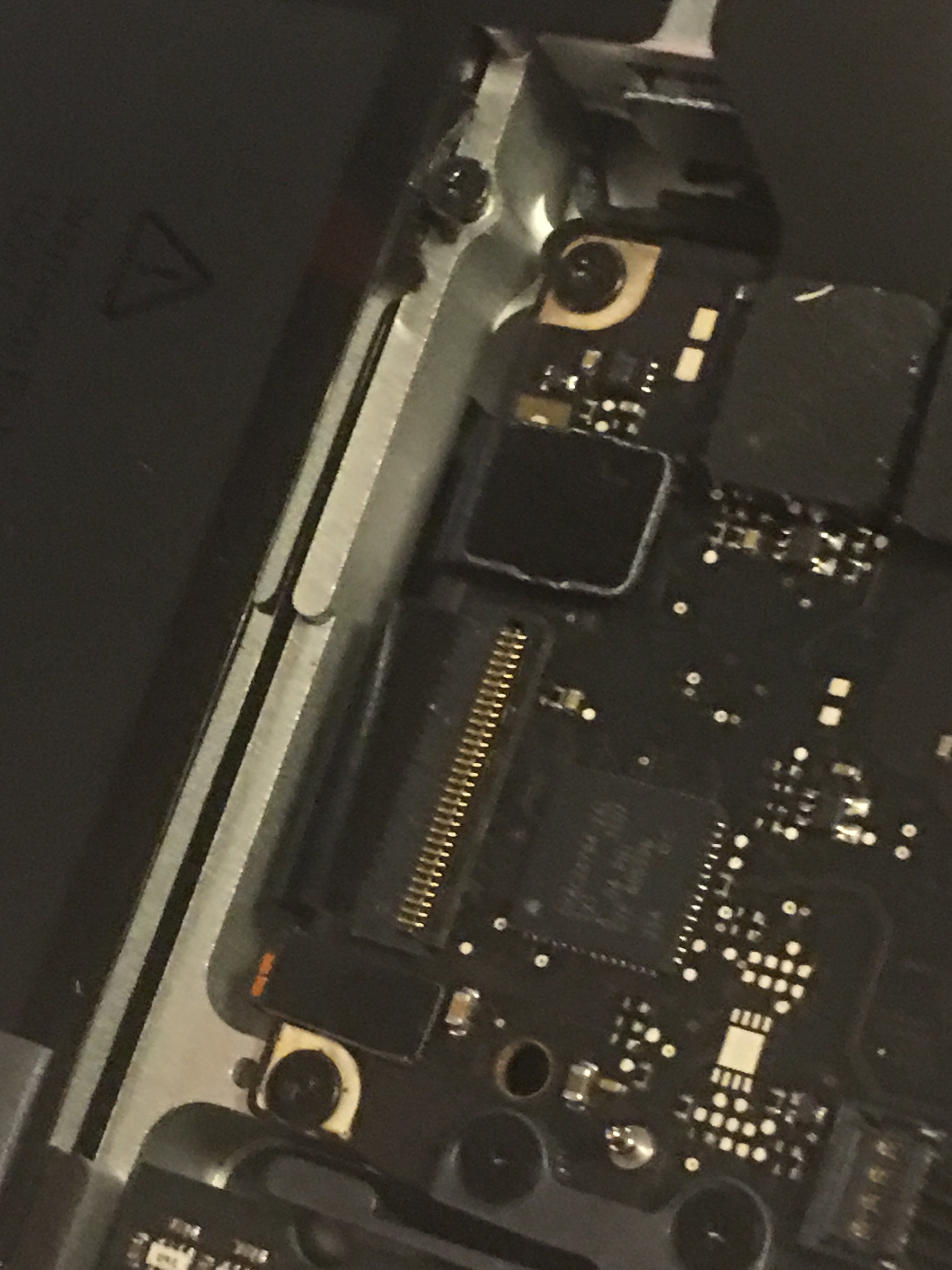

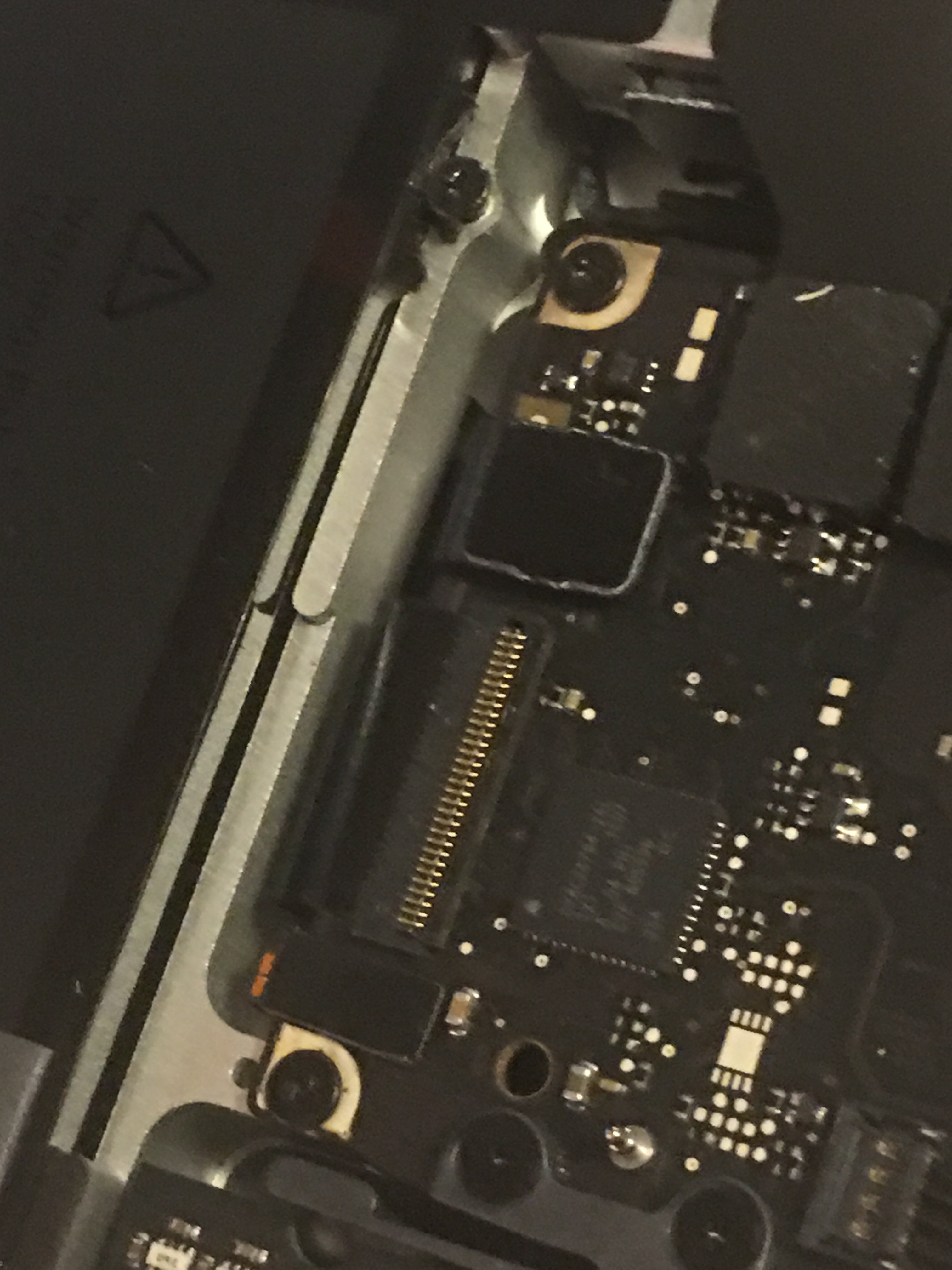

Is this attached photo the keyboard part? Also, you can see the broken battery part.

If it was bad RAM, it would still power up, just beep at you. You haven't dislodged/shorted one of the battery connectors, have you?
Next time you go swapping RAM in one, don't bother disconnecting the battery.
Edit: Just saw the photo. Is that ribbon cable seated correctly? Doesn't look like it but the photos kind of dodgy

I think it is seated properly, I didn’t touch it before the photo. I got my phone wet fishing last weekend. My stuffs all messed up right now.

The damaged battery screw would not cause a short.
Try reseating the ribbon cable. If you have a problem inserting the cable, attach a piece of take to the cable to form a "tab" you can use to guide the cable back in.

I reseated the keyboard ribbon. The tape trick worked getting it back in there

Step 11 is the keyboard ribbon cable: https://www.ifixit.com/Guide/MacBook+Pro+13-Inch+Unibody+Mid+2012+Upper+Case+Replacement/10377

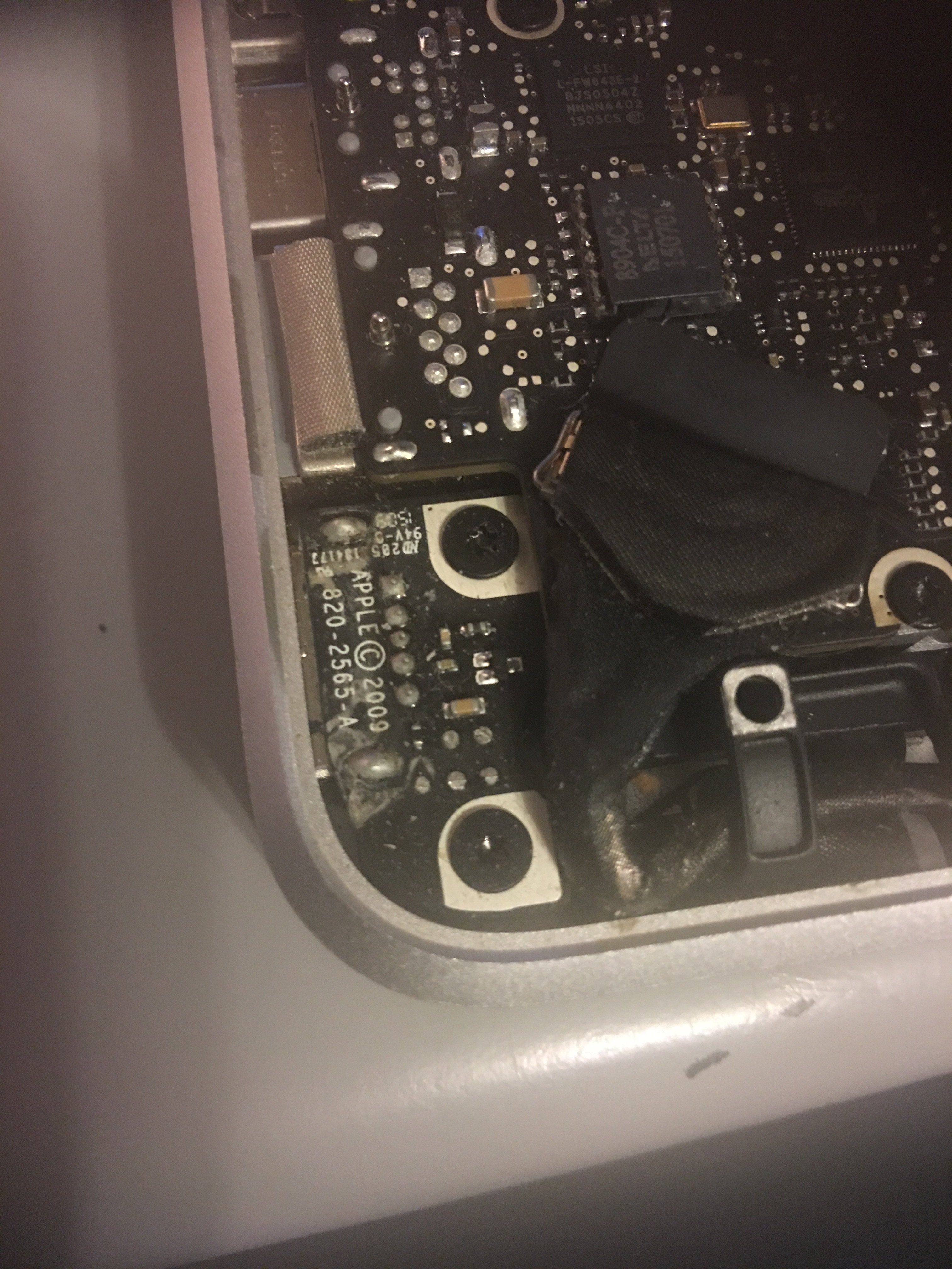

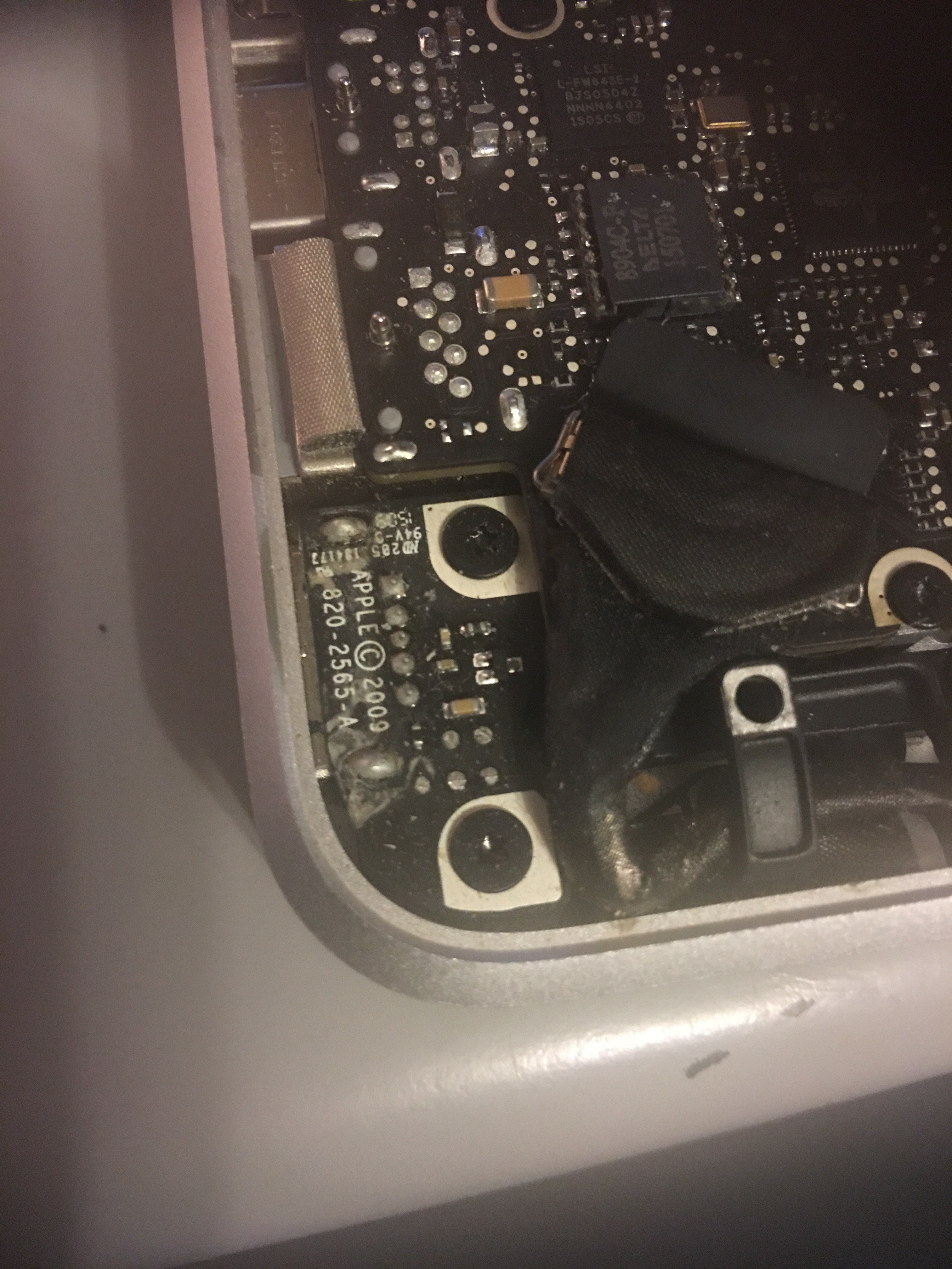

[doublepost=1536730643][/doublepost]Damn, after reading other forums I think I did short my battery connection. I chew my fingernails so I was struggling and used a small flathead screw driver to open it. I see that someone else did the same thing on another forum. I feel so dumb.

Don't feel dumb. I've learned my lesson by ruining my share of items too which is why I purchased a plastic spudger and a thin metal spudger. If I need to use the metal spudger around power sources, I cover the end in tape to prevent metal-on-metal contact.
I know it's a bit late now but I always recommend disconnecting all power sources when working on circuit boards. Accidents can happen such as dropping a screw onto the board that causes contact between two contacts, liquid spills, etc.
The image in your last post looks like the i/o board is has come in contact with liquid, the liquid has dried, left behind residue, and may have corroded the connections. Look at the last picture here: https://www.ifixit.com/Guide/MacBoo...id+2012+MagSafe+DC-In+Board+Replacement/10371
Before replacing the DC board, remove it, thoroughly clean it and any other areas that appear similar with pure isopropyl alcohol, reassemble, and test.
You can find replacement Magsafe i/o boards on eBay. The Apple store will charge a lot to replace the Magsafe board.
It may be pure coincidence that the issue arose after swapping the ram.
