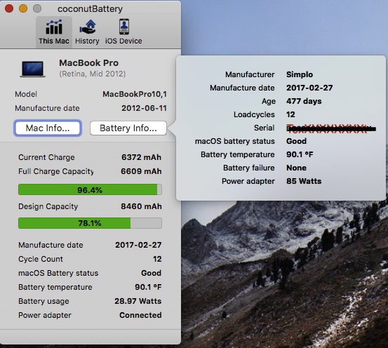

My original Macbook retina mid 2012 battery was dying after 5 yrs of use and 850 cycle.
So I bought a new battery, installed it and after few days of use, the design capacity went down to 81%.Mac shutdown at about 28%. I returned it with no hassle. Battery was a yr old.
Then I bought another one, battery was 5 yrs old. I got the "replace now" error after few days of use.
Then I bought one from amazon, same problem. Few days later I saw the design capacity problem again.
Bought another one in eBay from a reputable vendor. Same capacity design problem, mac shuts down at about 30%. Seller is sending me another battery.
It seems to me the problem gets worse once I start doing calibrations and SMC resets.
I'm starting to thing the problem is somewhere else. Any ideas?
PIcture: https://ibb.co/i4ren8

Sounds a little strange, I this the procedure you follow when calibrating?
Source iFixit
I think you may have missed it but the coconut battery picture was posted in the original message as well as the SMC reset and calibration. In fact, the battery's capacity decreased significantly after the calibration.
Truth is that I've bought these batteries from different vendors in eBay and Amazon and I find very very hard to believe that 5 purchased batteries show the same problem unless all the batteries sold in Amazon/eBay are crap. At least all the vendors who sold me the battery have returned my money 100% including free returns.
And I get shutdowns at between 15% and 30% so the mac goes directly to shutdown without hibernating sleep:L I can confirm this because after the shutdown, pressing the power button shows the depleted battery icon on the screen.
